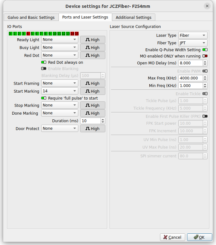

I bought a fiber laser (believe 30 watt) From REWA about 8 years ago to do back glass on iphones. It was running on SeaCad and works fine but limited software. Trying Lightburn and it will fire the laser but cant get the redlight to come on Or if it is on it to dim to see. I have been through the videos and got everything turned (red light switch and fire button). It still does not show the fire button like it does with my XTool D1 Pro. I am using windows 10, started with Lightburn 1.7 and currently on 2.0.02. I dont know how to get any info on my laser but i know it was made by Triangle. Used google translate on the shortcut and it says “Triangle Iron Cloud Marking System” it is really hard to use a laser without a red light…lol. If anyone has any information about the laser and how or if this can be used on lightburn with a redlight…thank you in advance.
The device settings identify the type of controller. If this is not correct, then it may not function properly.
Do you know what source is in the machine?
The ones I’ve seen have been very low watts out. I’d try to locate information on the source as a starting place.
This from my JPT
Do you have an lens information for your device? You will need it. Might save some headaches if you can get it from Seacad.
