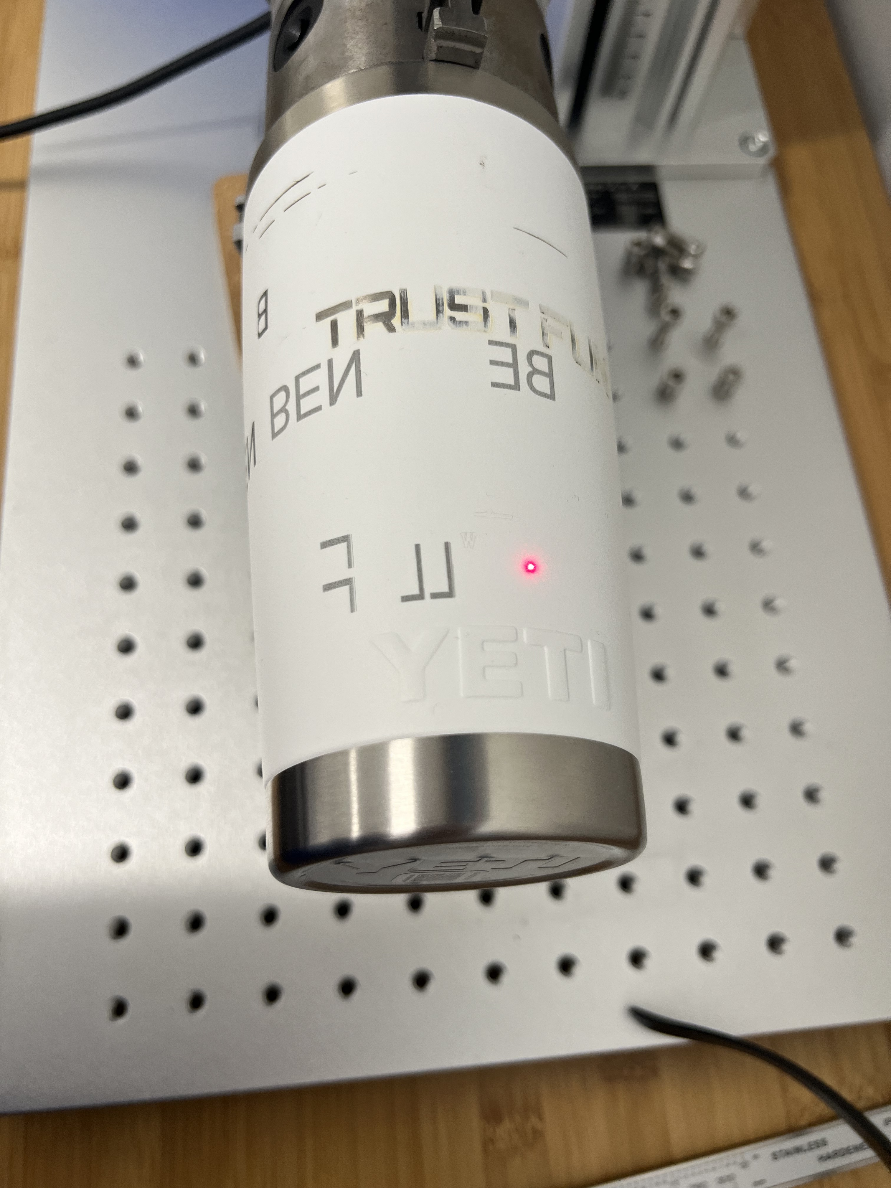

Can anyone tell me why my letters are coming out inverted on my cup. I am using the chuck rotary with my OMtech fiber laser and while using LightBurn each time I run it the letter or anything I do is coming out inverted.

Try turning the Rotary 180 degrees.
Try clicking Mirror output to rotary.
Try flipping your part in the Lightburn workspace.
You have not told us what you have tried in order to fix this.

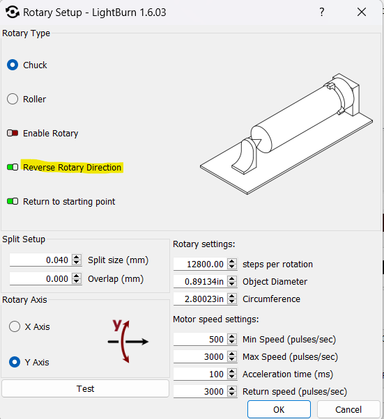

Click reverse rotary direction if this is on a fiber laser
THANK YOU, It worked
