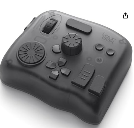

I have a Cintiq but don’t really see any advantage to using it the way I use Lightburn. The Cintiq really shines in it’s ability to create organic shapes and pressure sensitivity. It is a great tool for digital artists. Now a tool that I find way more useful for Lightburn is a Tourbox. The Tourbox has a number of programable buttons that can be mapped to any of Lightburn shortcuts. The Tourbox is so ergonomic that you never have to look at it. You can instantly execute commands with the touch of a button that once required you to go through dropdown menus, requestors, or memorizing keyboard shortcuts.
