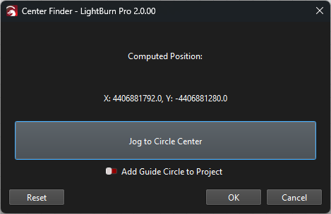

Circle Center Finder - strange error
Ligtburn pro 2.0.00
xtool s1
And Lightburn is NOT in beginner mode.
When I run the center finder I get huger errors like the one pictured.
And as one would anticipate, lightburn gives an error if I try to move to circle center.
This error is for a circle about 11" diameter.
I get smaller numbers, but still impossibly large when I try to center find a circle say 1" diameter.
It’s like the 3 point definition of a circle blew up. If it was an offset issue it should be off by about the offset I would think… But since this reported center circle isn’t even on my property, let alone within the confines of the laser bed, I am at a loss.
Does anybody happen to know a secret setting to change?
I followed these directions
That appears to be way beyond a setting error.
Report this to Support@LightburnSoftware.com and include a link to this topic.
