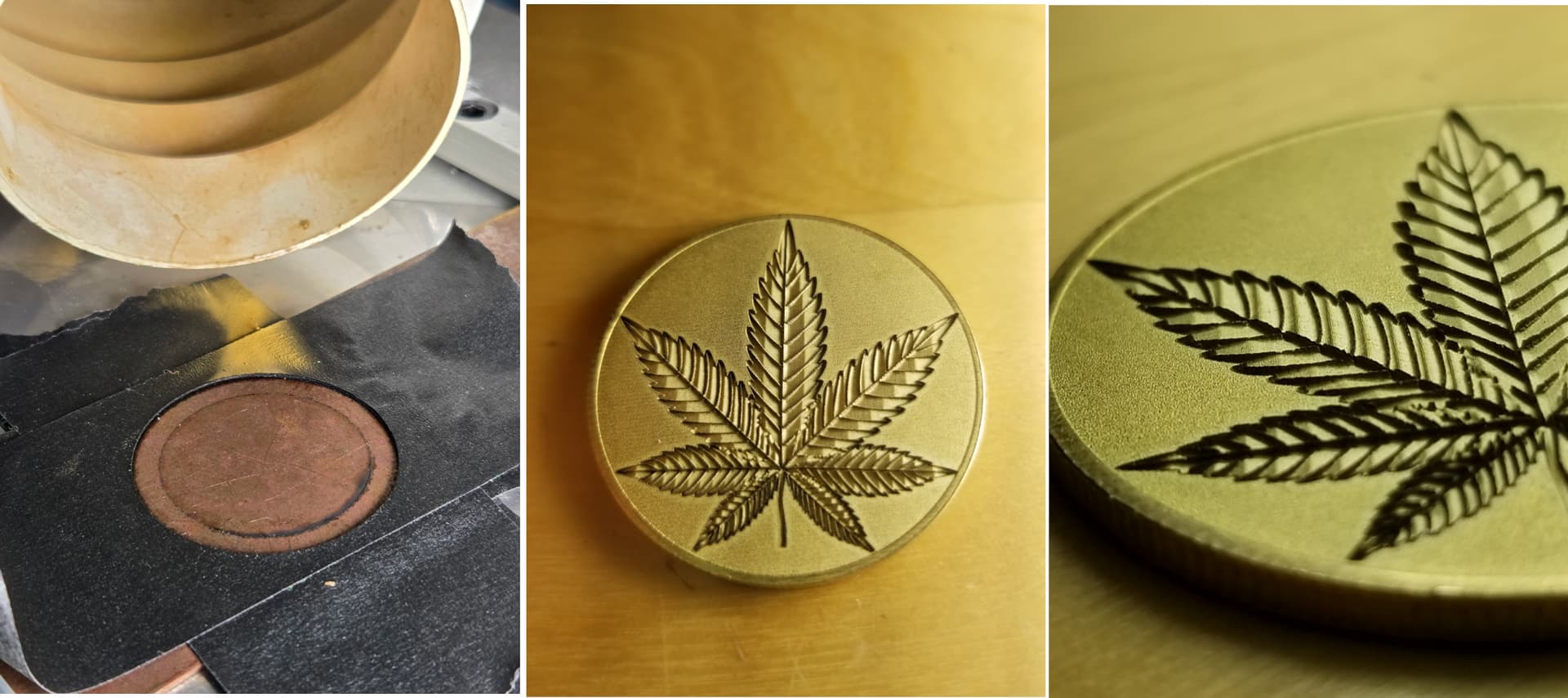

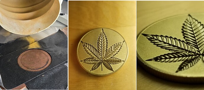

Maybe how I center coins will help… you decide. :thinking:
I use the center reference in Lightburn. So I can use P to move a selected item to the center of the work area. Any circle I make can be moved to the center of the work area.
Make a circle of the size you can place your material snugly.
Lay down a few layers of masking tape (I use black) and use the proper circle to cut out the circle or jig.
Peel out the tape and use that as a jig to hold your watch face or coin.
Then you don’t need a framing laser.
