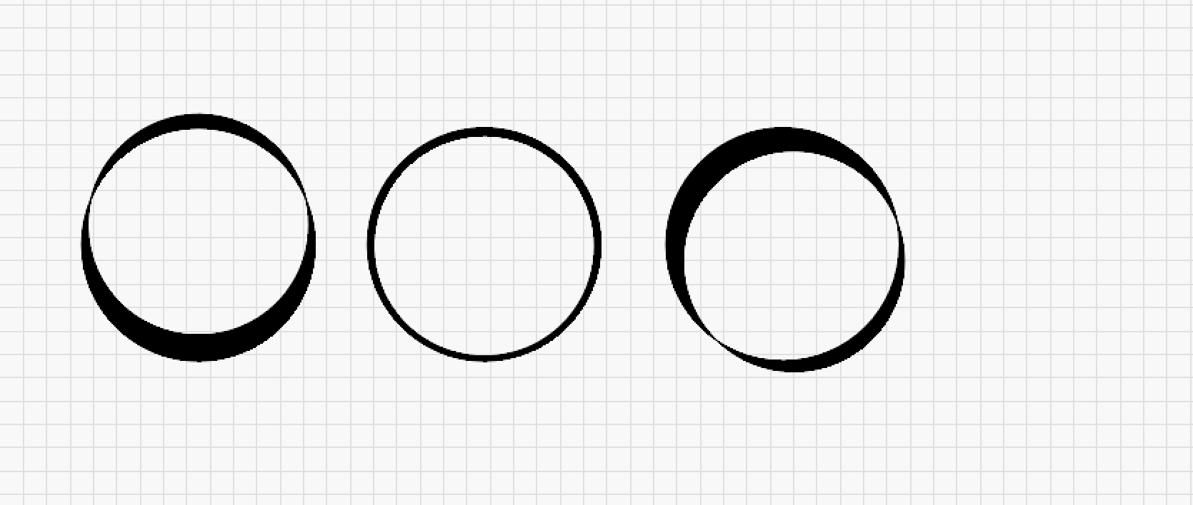

Circle offset engraving inside too
When I do a circle and then an of set,
and I move the offset a little bit up or down
then it wants to engrave everything inside the circle too,
only noticed it on my last 2 updates…

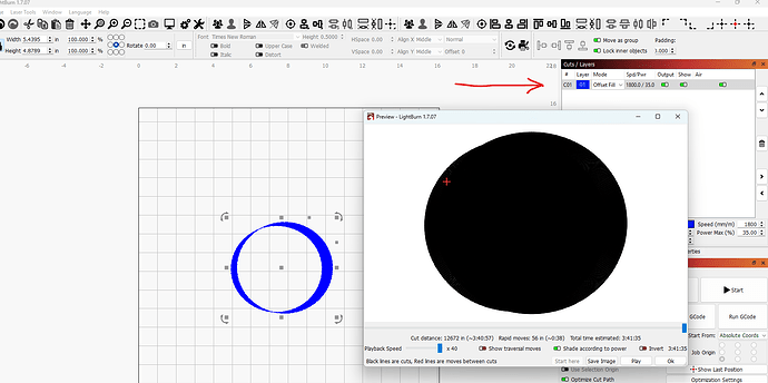

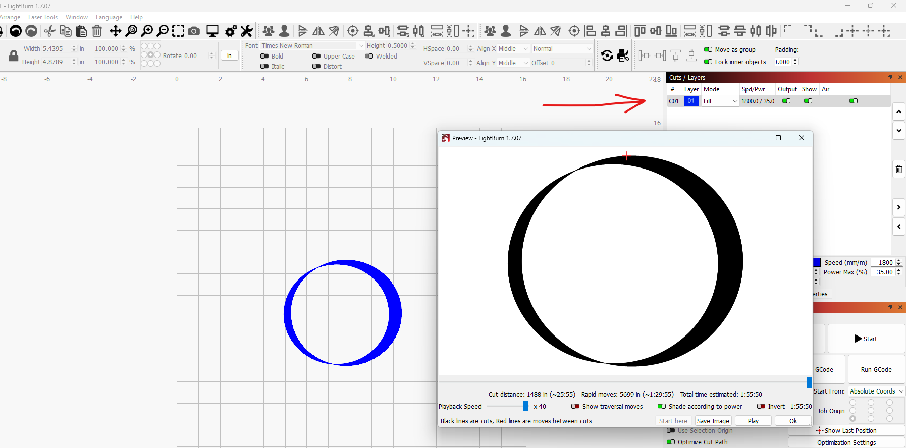

But I am finding when I overlap
the inside with the outside that is when it’s happening
it all look good on the main screen
But when I look in the Preview Screen (for Engraving)
It wants to Engrave Everything inside the circle…
Its Not only happening with Circles Its with
Everything that when you do the offset. then overlap
The offset…
when you overlap the result is “inverted” at the overlap is that what you mean?
why is it not engraving like the picture
Shows?
why does it want to engrave Everything
There is something “you are doing wrong” :wink: , try sending the (your) file.
Additionally, make sure that the cut/layers mode is configured to ‘fill’ instead of ‘offset fill’.

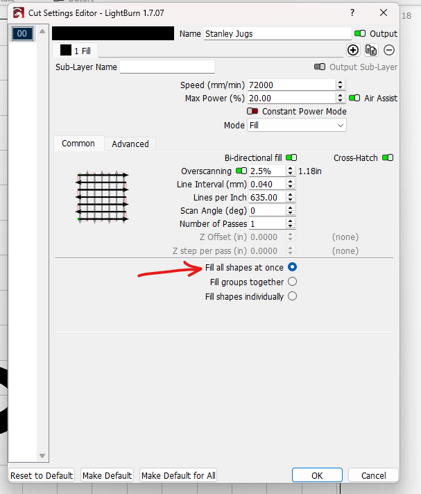

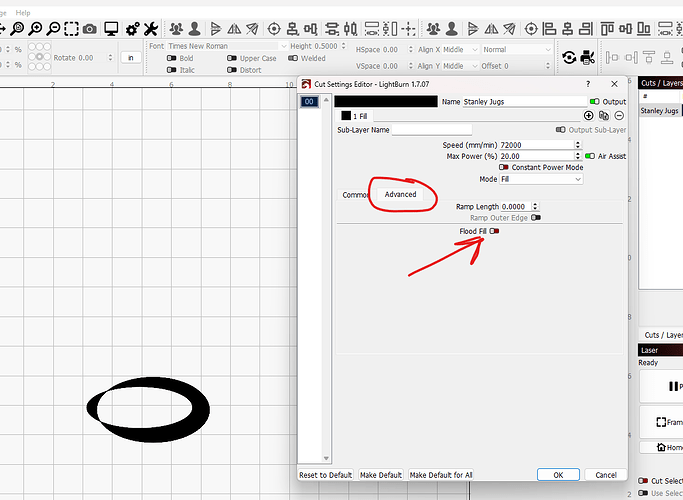

Please try this, In the cut settings editor under the advanced tab turn off flood fill.
In the common tab change to fill all shapes at once.

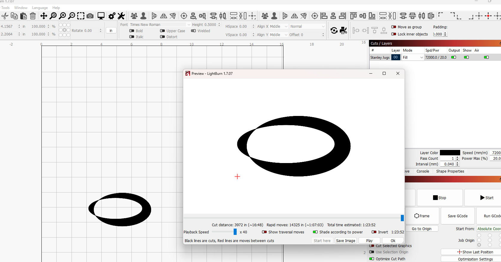

This is the result I got.

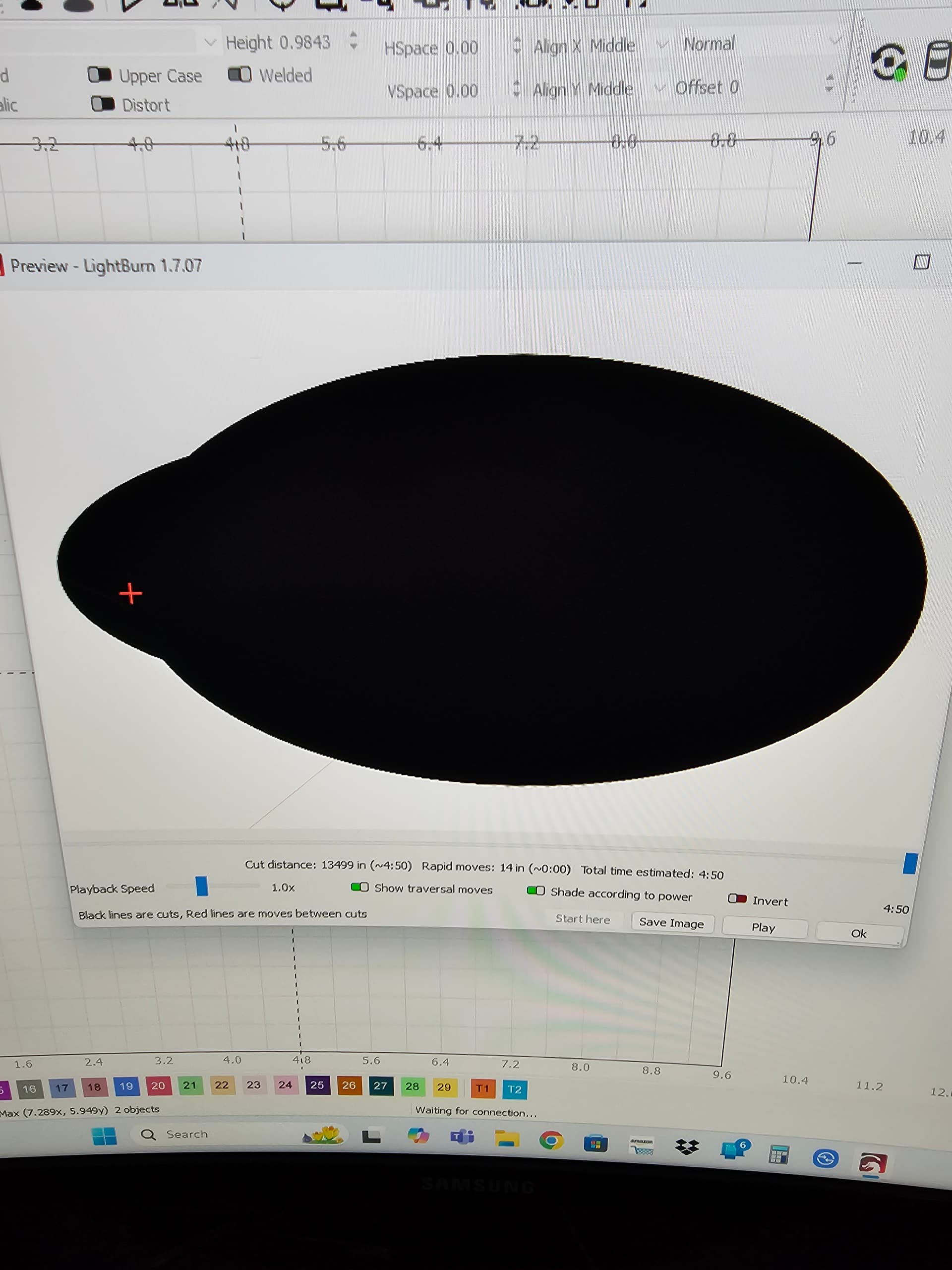

Its Happening when I have.
Flood Fill: On
Fill groups together: On
And
Fill shapes individually:On
If I Have
Fill all shapes at once: On
its not doing it…
I don’t know is it Supposed
to do it that way???
Have to be careful
to always check preview???
Never Noticed this before
I hope the updates
didn’t have an affect on this issue…
Hoping the Adm. will check this out…
What kind of laser is that? Your fill speed is set to 1200mm/s…fiber laser?
Yes I have A Fiber Galvo and Co2 Galvo.
Version of LightBurn you are using?
The latest just updated the other day…
I’d have to check what the number is, but I think it is 1.7.07

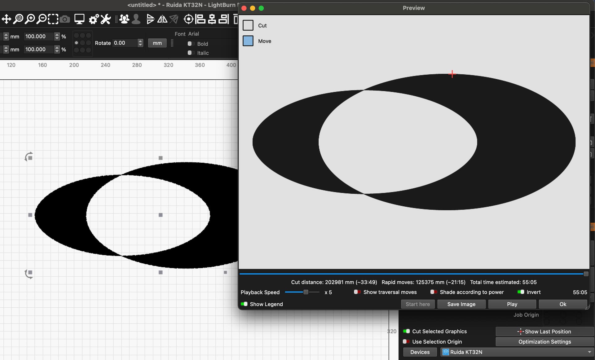

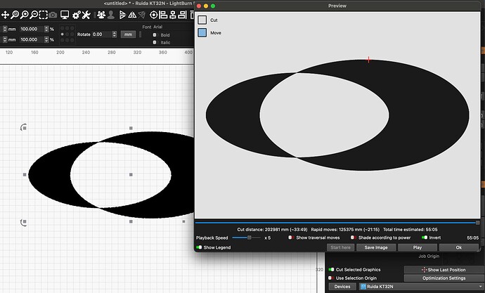

ok, that explains the excessive movement on my (CO2 laser) in the preview window.
However, on my LB version and my machine setup, i.e. the normal parameters I use, I can’t provoke your problem, but I see it on your file.
