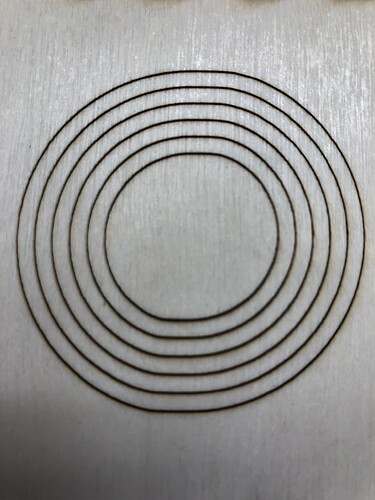

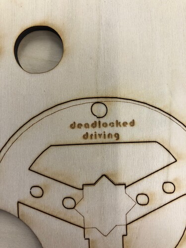

Is my Ortur Laser Master 2 Pro XY out of calibration? Is there a way to calibrate mechanically or thru Lightburn SW? It is a fairly new system and not used to much. Circles and repeatability after a pause likely in the Y axis is off.

That looks more like mechanical slop than a calibration issue.
Go over your belts and pulleys first.
Are you using a very high speed? What are your feed rates ?
Speeds are not typically higher than 500 mm/min. I just touched the belts and to my feel no slack. Linear lines look good. But just did a run now with a corner radius and the tangent line is not perfect (not so bad). I will do another test run with a 50 mm circle now.
Primary item to check is the set (grub) screws. This link is for Sculpfun machines, but most of the information appliea to all diode lasers.
Image shows mechanical issue.
