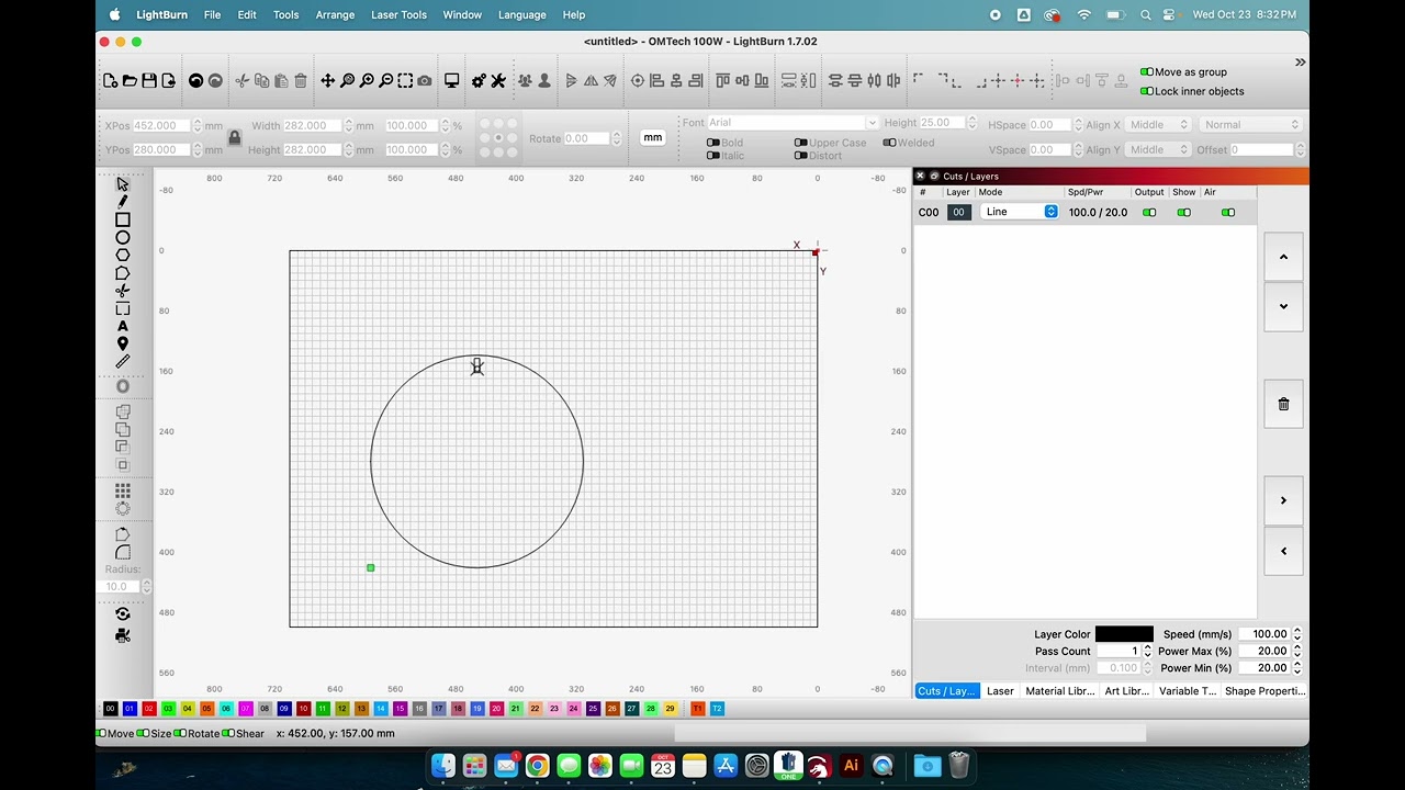

When I try to make a clockface using the circular array tool all I get is a bunch of spirals on the workspace. This only started after upgrading to 1.7.01. Is ther a fix for this?

looks like its rotating the circle rather then any text, is the text highlighted instead of the circle?
Yes. I’ve used this feature before but now it doesn’t seem to work as before.
Yes the text is highlighted.
The order of selection would be my guess. Select the thing you want to duplicate first, then what you want that thing to rotate around second. Think, “Duplicate/Copy this X number of times around this.” ![]()

Here I show 1.7.01 using the Circular Array along with Variable Text set to Serial Number to produce a clock face.
(click to enlarge)

Only to add: it’s not so much the “second” thing is what gets rotated around; it’s the “last” selection is the central. And really, it’s the center of the bounding box of that last-selected thing, in case it’s not particularly round-ish ![]()
