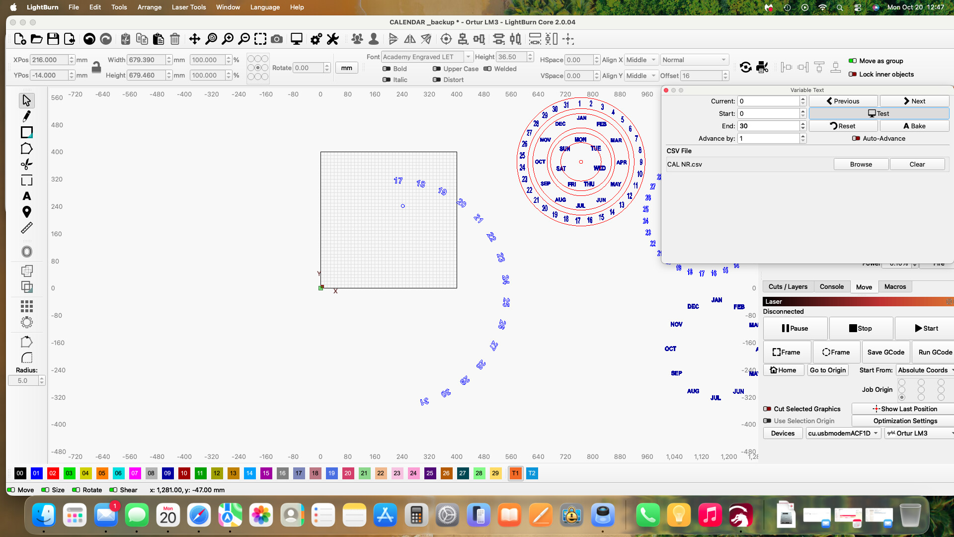

I have built a 1 - 31 variable test in the circular array. It started at zero but the numbers actually started at 10 and now start at 17. I tried it with excel and Apple Numbers. Same issue. I have tried resetting the variable text with no luck. One time I pushed the numbers down by 10 and I got the full circle of 1-31. Now it will not let me. I am guessing a toggle someplace. I am using a CVS file. Guidance please.
Post a couple screenshots (not phone pics, please) showing your entire Lightburn screen with the variable text window visible and a screenshot of the circular array tool. Possibly also post your file for review.

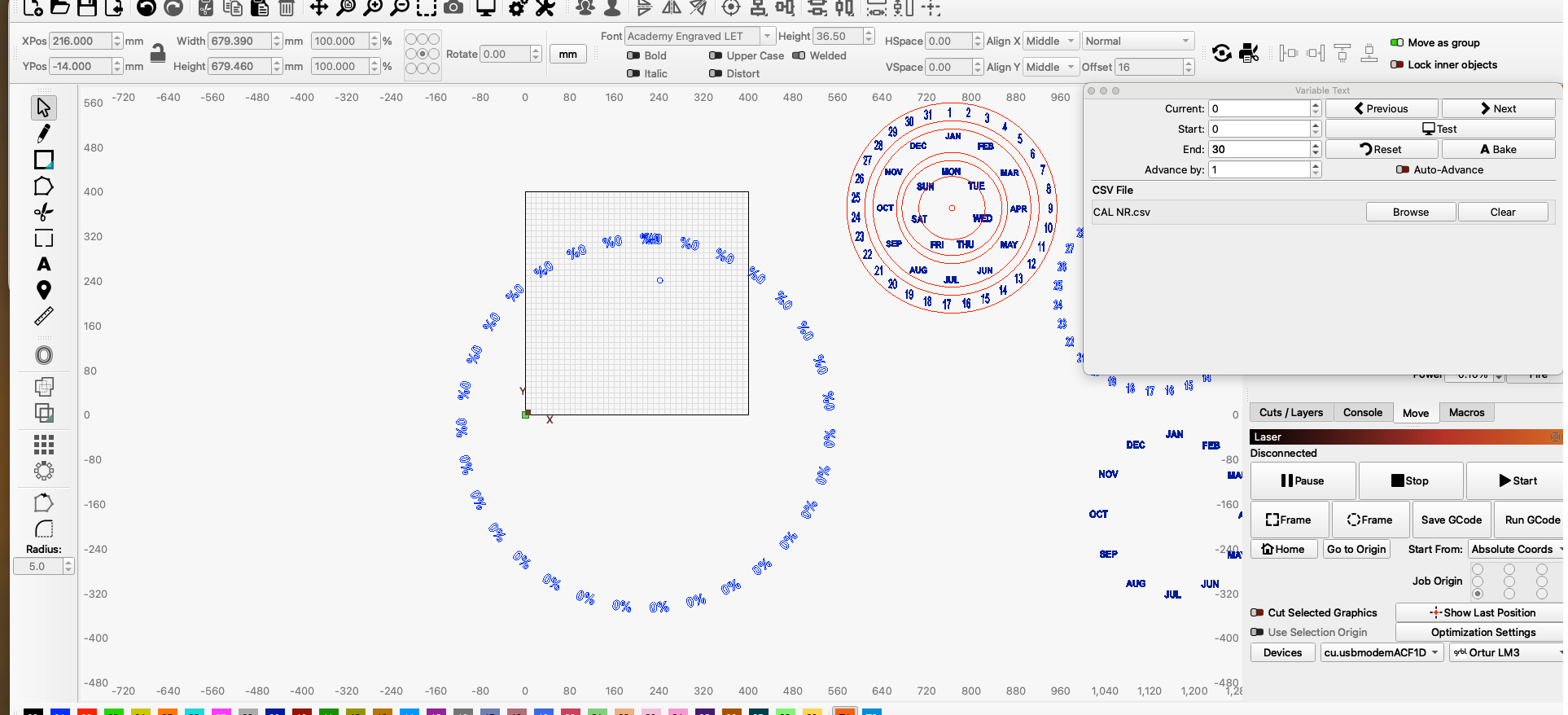

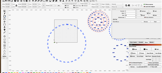

These two were the original. I got the first to work by pushing numbers down on spread sheet. When I tried the second time it did not work.

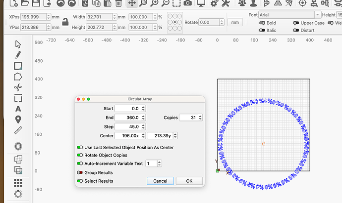

There are new for you demo.

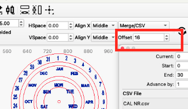

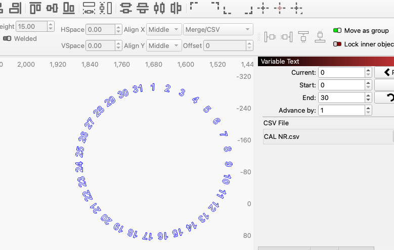

When you recreate your array you need to ensure the offset is set to 0. It’s currently set at 16, which is why it starts at 17. There is nothing in the csv file beyond 31, so it doesn’t fil any of the other cells.
