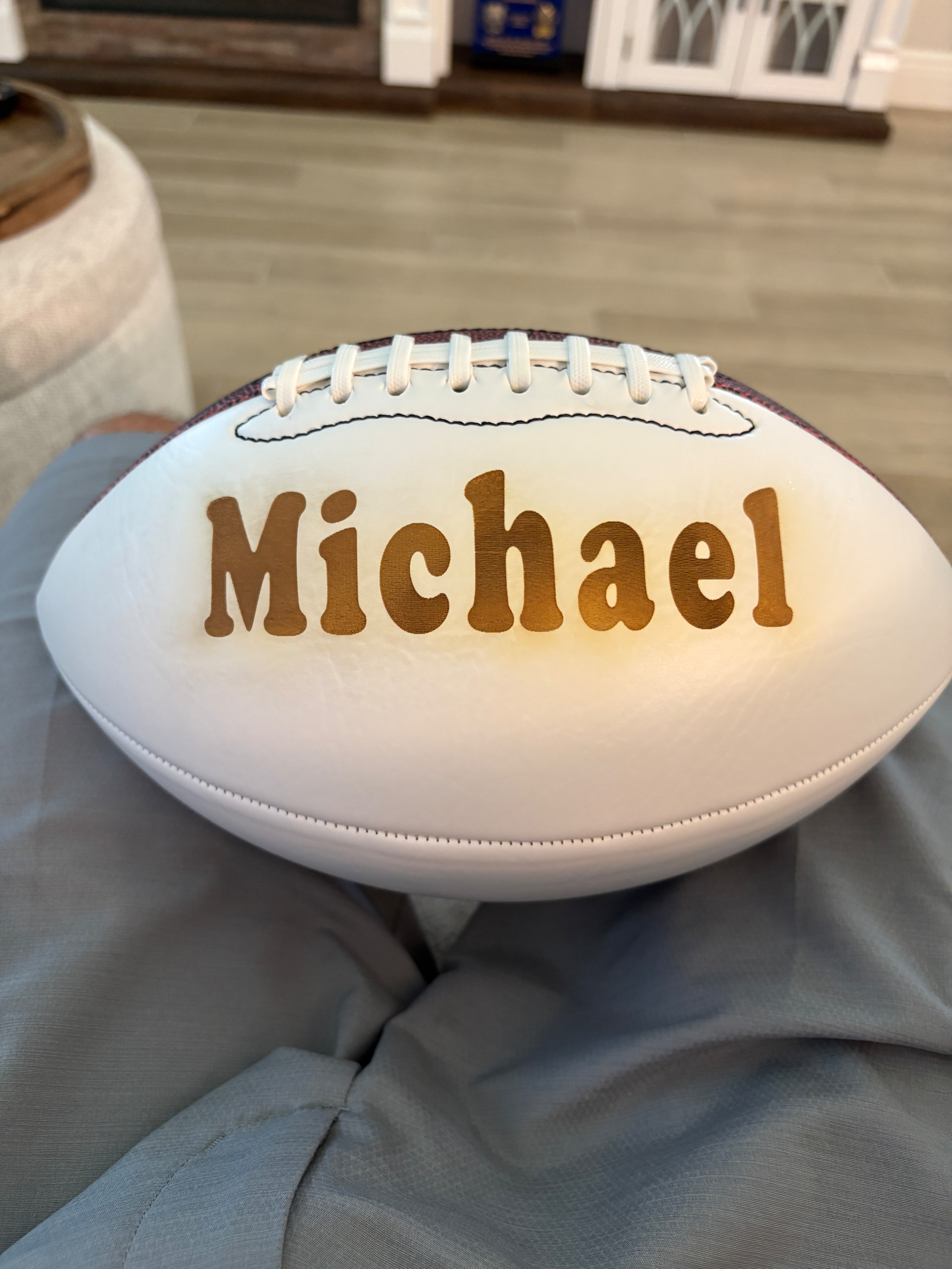

Hi all
I recently engraved a white oanel football
I think it came out pretty decent
Unfortunately, i cant seem to get it cleaned up well enough to deliver Yes, ive tried LA awesome, Mr Clean sponge, magic eraser, toothbrush, dawn soap The closest i got to getting it clean was the Mr Clean sponge, but that started to bleach out the white panel and then it started to lighten the engraving
Any thoughts?
Boss laser
CO2
70w
400speed
0.0065mm
18%power

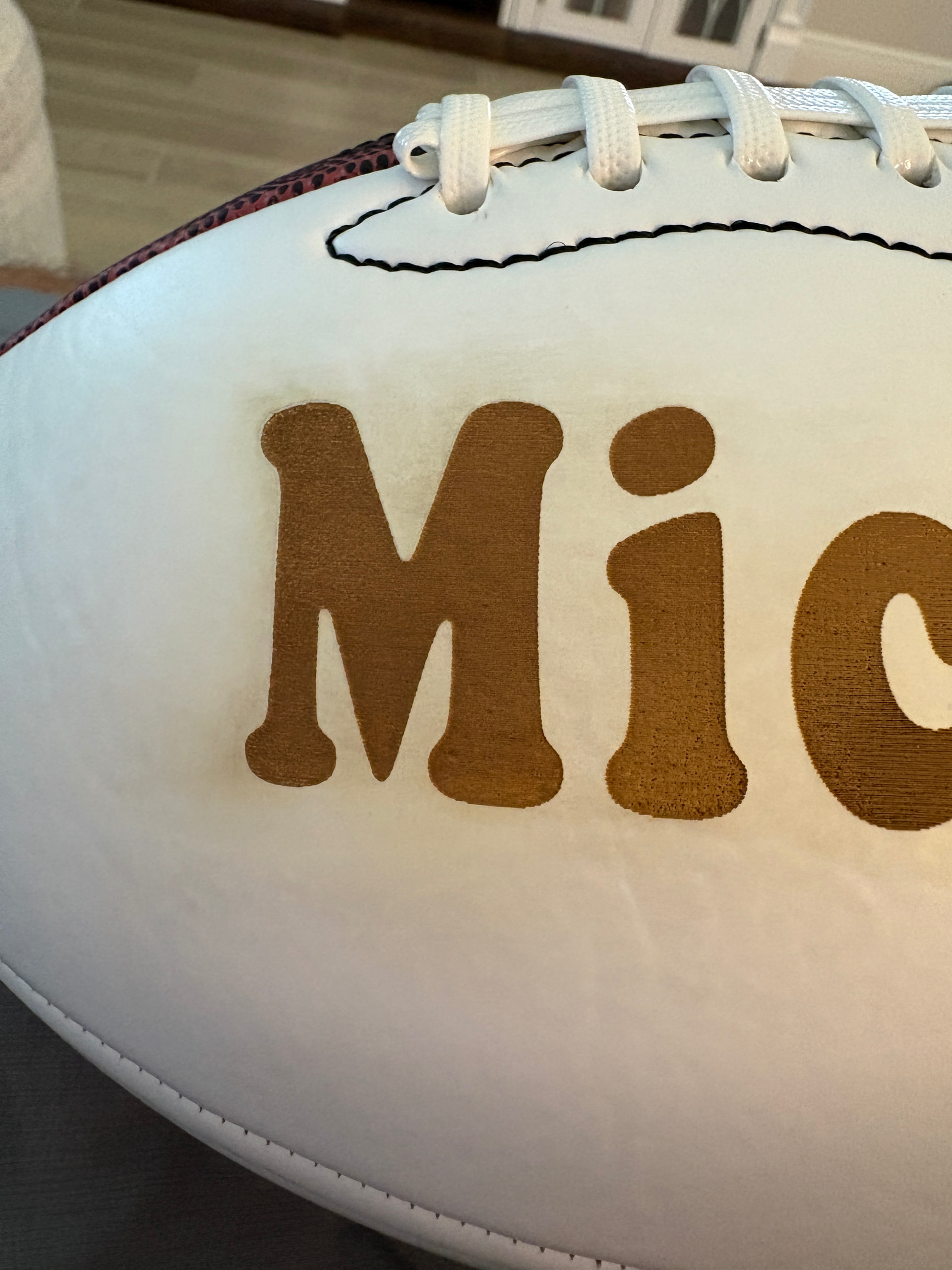

It appears, from the photos, that’s debris surrounding your engraving. What material is a constructed from? That may help.
Using such a small interval is questionable to me. 6.5 microns is a much smaller spot size than mine can produce, even with a short lens.

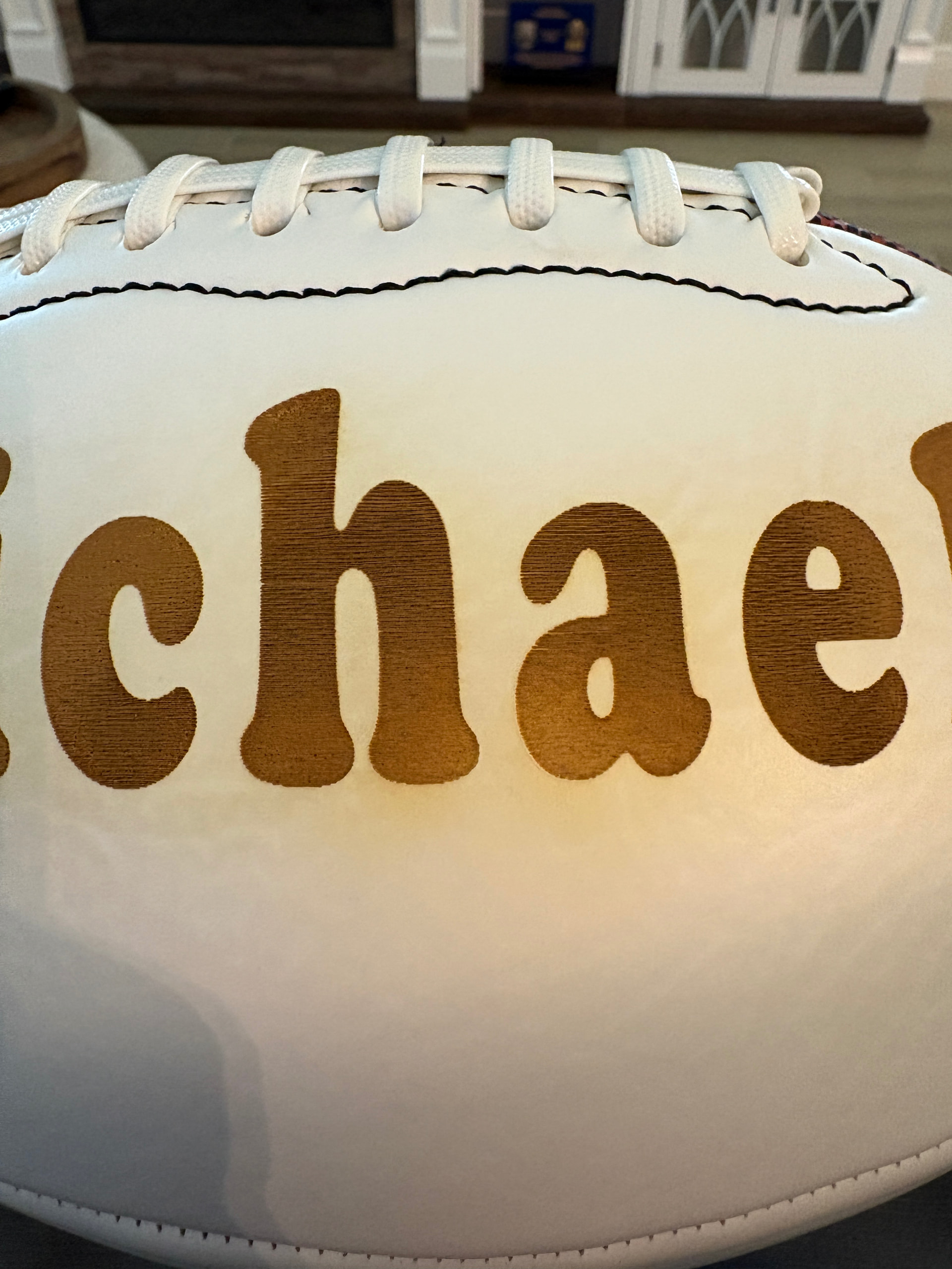

It’s a little debris and some heat combined to make a yellow/brown stain. Need it gone. :smiling_face_with_sunglasses:
When you engraved the ball was there any form of masking? That staining is going to be very hard to remove.
I didn’t mask it like I would normally mask just about anything else. I was worried it would melt to the ball. I’m not new to this….just new to this stupid football lololol. And yes, you’re right, it’s probably not coming off.
Try some kind of leather cleaner, cream or conditioner.

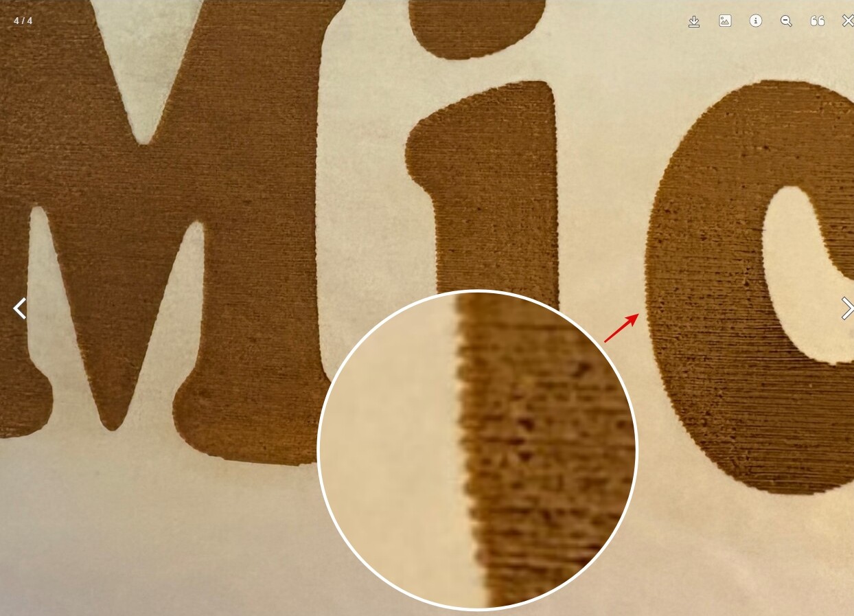

I think the interval is way too small and that’s what’s causing the debris issue, at least to this extent.

Without intending to minimize your opinion, but, when enlarging the image I would say that the distance between lines, if not spot on, will be slightly overlapping.
Increasing the distance would, from my point of view, clarify the engraving.

My apologies for the delay in communication. I typically use 0.065 mm interval. I may have fat fingered the keyboard when setting up this project causing the interval to be tighter than normal. That said, I’m going to run another one, and try masking it with the same paper tape I use for acrylic. Thank you all. Will follow up shortly.
I don’t really care, except I know you’re lucky to get <0.100mm spot size on a glass tube co2 laser.
So even with 0.065mm it’s covering the same area, best case, 0.100mm/0.065mm is 1.5 times over the same area. Most glass tube lasers are closer to 0.200mm, using that is three times/passes.
I’m really not caring about the output, you shouldn’t need to make multiple passes with this type of engraving. It just makes things hotter to do this, increasing the chances of the burn appearance.

You should know by now, that looking at an image helps, but you can’t determine interval from the photo, needs better resolution.
I see where his scan adjustment needs to be corrected, by what you point out. Even at best case his lasing the same area almost 1.5 times.
