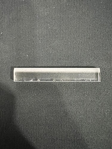

I have some 12mm clear cast acrylic that was given to me. It’s frosted on both sides. I was experimenting with cut settings on my 100W C02 and have a strange issue, at least it seems strange to me. The top 3mm or so of the cut is very rough / frosted and everything below is nice and clear. I have experimented with different focal heights, both closer and further way as well as different speed/power settings and do not notice any difference in the results. Looking for guidance.
I have not noticed this issue with 3 or 6 mm material.
Turn your air assist off or, like mine, down low enough for only lens protection.
What length of lens are you using?
A 4" lens has a depth of focus (dof) of a little over 10mm, shorter lens, shorter dof.
That would be a starting suggestion.

Using a 4" lens. I did have air on, although regulated to 15 PSI. I will try it with air off (only bleed through) and see what happens. Thanks.
You are aware of the start speed effect on minimum/maximum power levels?
My only solution, from Russ Sadler, was to reduce the air flow. Hope it helps.
I discovered that during testing. It was only running at 4ma at 70%. Took me a while to find the issue.

I had some time for testing today. I ended up turning off air assist and reduced the bypass air so that it just barely came out of the nozzle. I ended up at 4 mm/s @ 70% power with 2 passes. That solved the frosted edge problem.
I did have a couple small fires though, which I don’t like. They went out as soon as I stopped the laser so no damage done. Definitely not something to walk away from.
I’ve put a dish of water and stuck the nozzle in and watched it bubble..
Reducing air pressure was the only way I could get rid of the frosting on thicker pieces of acrylic.
