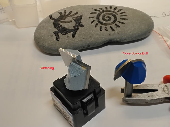

What do you mean by “fitting diameter”? There are several tools you can use for roughing out a pocket that have larger cut diameters than the shank.
  1. A 2-flute Surface mill can plunge cut if you get the right one.
  2. I just bought an 8-piece set of Cove Box (Bull) mills, 1/4” shank, ranging from 1/8” to 1” in diameter. These are specifically designed for roughing out pockets.
  3. Rough Cut mills can often permit much higher feed rates, but it is called rough cut for a reason.
Pay attention to the tool design when setting the depth per pass. You do not always have to remove it all in one pass.
Thanks, could you find an image of a tool doing that? Plunge (somewhat at least…) and clear effectively? Preferably with a working diameter larger than the shaft (yes thats what i meant).
I do not have a video, but maybe this image will help. Both cutters come to a drill point in the center, making them capable of plunge cuts. But do not try to use drill feed speeds because they will be a serious load on the machine.
