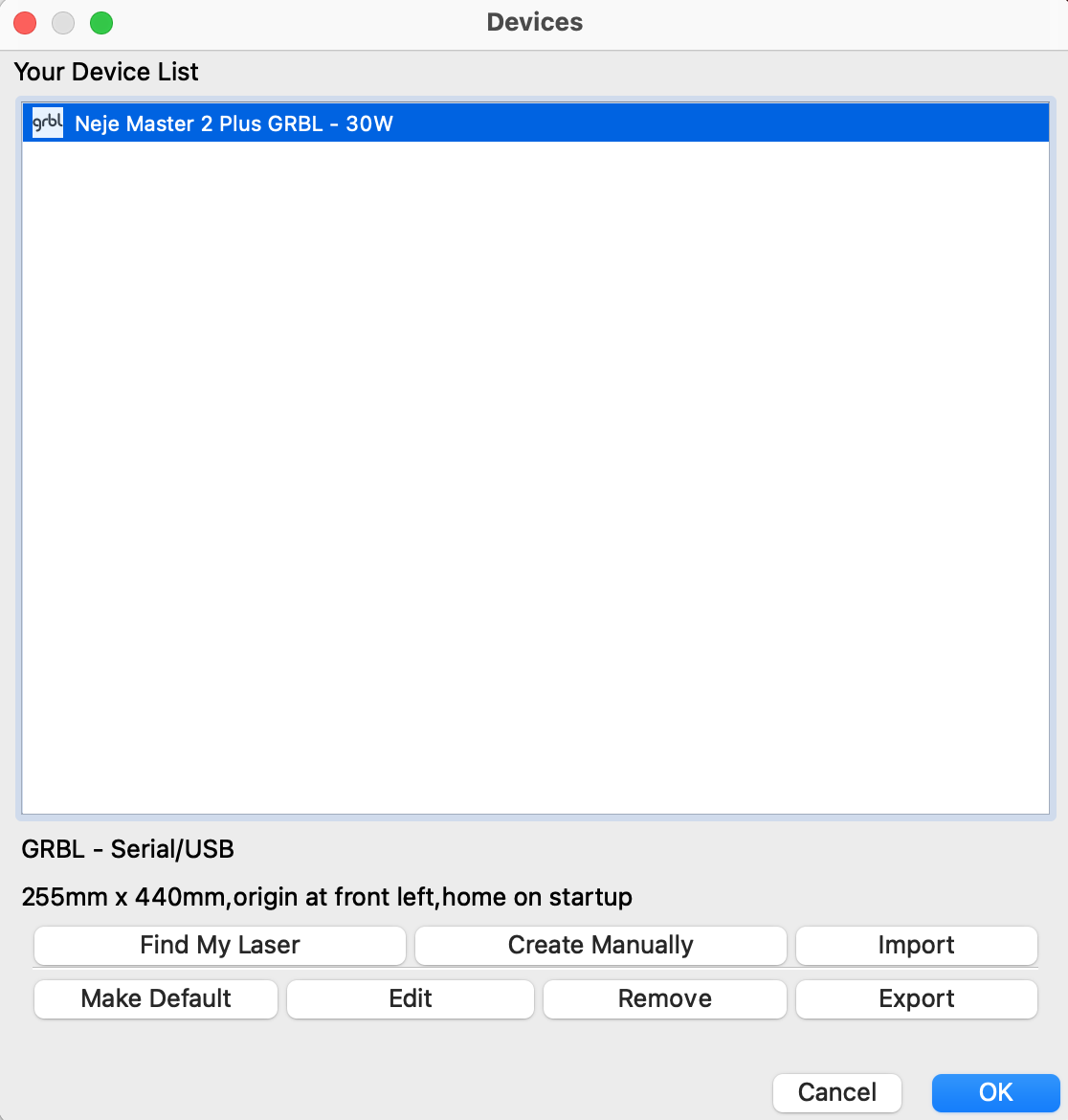

as the subject title already states. I have the problem that the Click-to-Position function (or the Arrange -> “Move Laser to Selection” menu items) only positions the laser on the X but not on the Y axis. Starting from the home position, for example, moves the laser only on “it’s baseline” but does not move into the field, so to speak.

In your firmware, what are the travel limits set to? ($130 and $131). What is the machine size in LightBurn set to? It won’t jog outside of that.

Here is my output from $$ in the Console. $130 & $131 seem to be correct. Also the two places in the GUI where the machine size is shown match the real values (see screenshots).

The funny thing is that besides the Click/Move-to-position function, the whole working area of the laser is used (expect the hardware limitation between Y=0-20). So, Lightburn does work with the full range. Only this specific function does not.

Found and fixed, will be in the next release. Thank you for sticking with it. :slight_smile:
