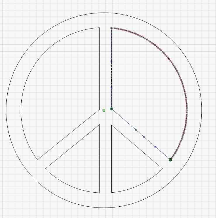

I have read many of the posts on closing paths but am stumped in this case. I have an arc and two lines that I want to make into a closed shape. I select all 3 and then select “close path” from the Edit menu, select the node tool, giving me the result shown in the image below.

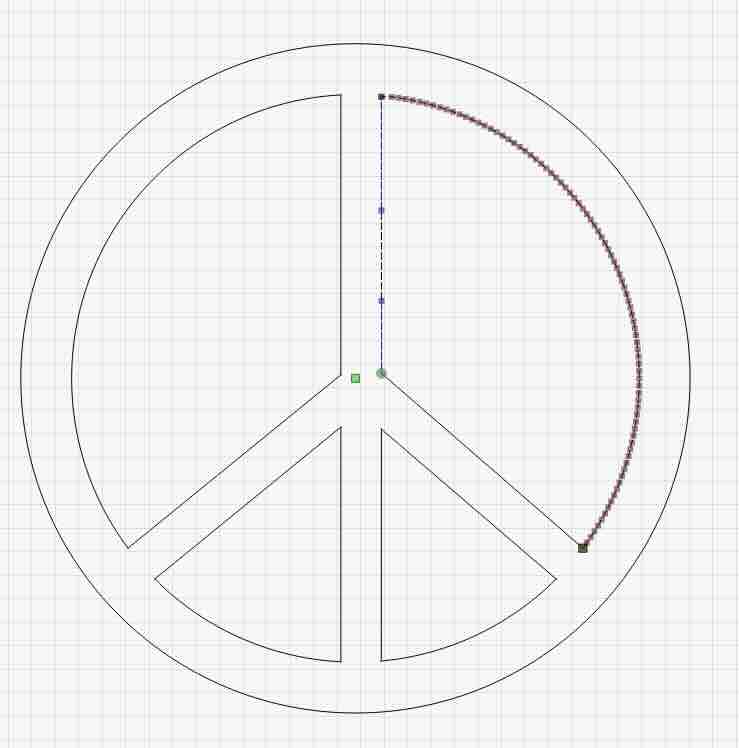

Since this shows nodes for all three segments, I assumed this was now a closed path. But when I return to the select tool (or use the Measure tool), the shape is still Open as shown below since nodes are only shown for two of the segments.
I also tried Close Selected Paths with Tolerance, same result. My lightburn file is below. I am clearly doing something wrong but can’t figure it out. Many thanks in advance

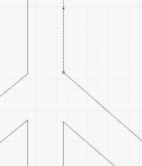

The tiny square is the unjoined intersection. Use the node editing tool and drag it away, then back again, to snap it closed.

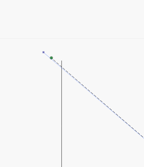

The apex directly below that will give you problems:
Drag it to snap in the same manner.
There may be others, I didn’t check beyond this point.

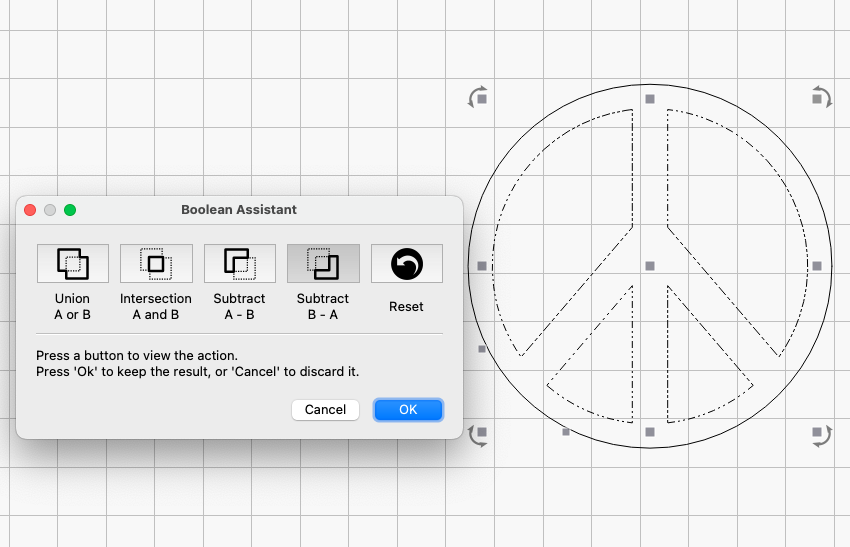

Thank you again, especially for introducing me to the weld tool. I was almost successful in implementing what you described. I welded the vertical box and two angled pieces together. But when I tried to weld the circle and centre, the centre disappeared. My file is attached if you have time to troubleshoot.
Weld Example.lbrn2 (32.9 KB)
For that you need to use one of the subtract options. Type CTRL + B to open the Boolean Assistant. That will allow you to preview the operation before committing to it.
Got it - thanks to all who helped.
seems I used Boolean Assistant for that final weld…
