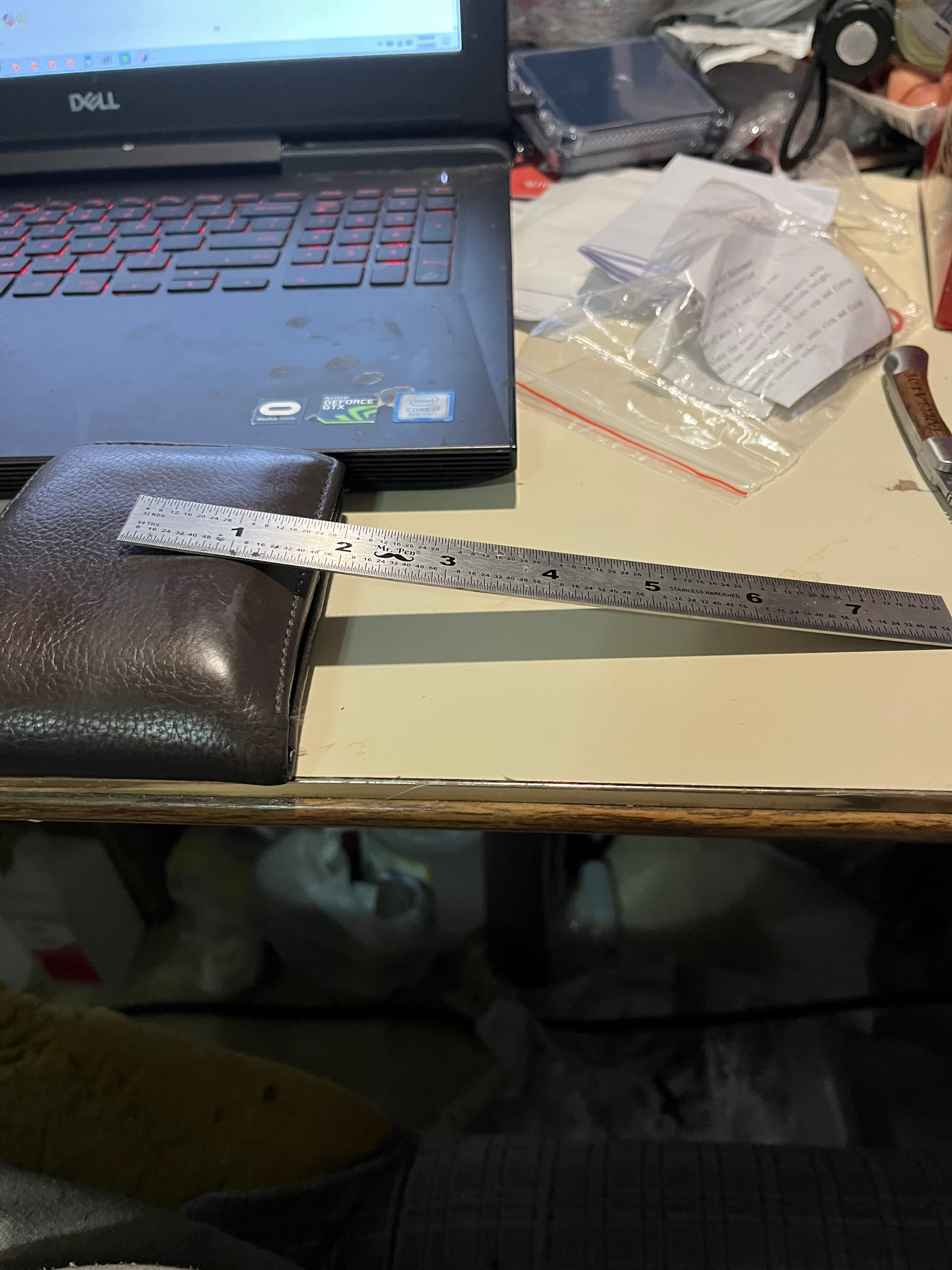

Simple barebone way I do it. Nothing special, nothing to build, print, make. Just use what is laying around at hand.
Any thin piece of wood elevated on one end. Run the laser down the wood starting at high end going to low end. Been using this method for over 10 years. It never fails. Gcode example
G20G54G90
M3 turn laser on
G1 X5 or however far you want to go.. Length of wood works great.
G0 X0
M5 turn laser off
Wallet is for elevating one end. Ruler is where the piece of wood will go.
