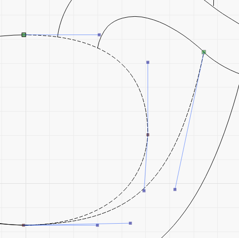

Here’s a representative segment taken from your uploaded image after importing it. Note that the end of line marker is at a point that creates an open shape. The other end of this selection overlaps the mirror segment, preventing a join.
Here’s another segment. One may expect the ellipsoid to be a fill, but the node indicators show that it’s not the selected shape, more that it’s composed of pieces of other shapes.
Use the node tool and determine what needs to be broken/split apart and joined to other appropriate segments to accomplish your objective.

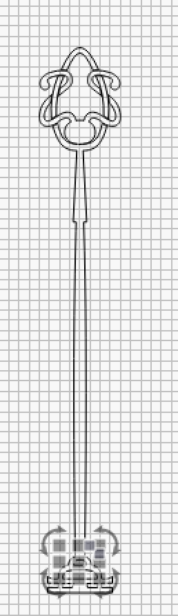

Is this the result you’re looking for?
A combination of Auto-Join, node editing, welding and inserting lines/curves to complete remaining shapes is what’s required. I saw your post just before going to bed last night (I’m in UK) so it was too late to start work on it then.
I’ve attached the LB file to give you an idea of the end result. If you’re new to node editing etc this would be quite a good one to get a bit of practice on.

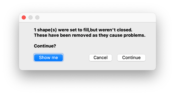

That is exactly what i was looking for, and thank you so very much for that, however, when I opened the file, I didn’t get that, I got this instead.

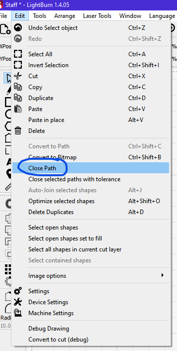

Ah yes, sorry about that! I didn’t actually check the preview. If you go to Edit|Select open shapes set to fill:
Then go to Edit|Close path:
You should get the missing white section in the graphic:

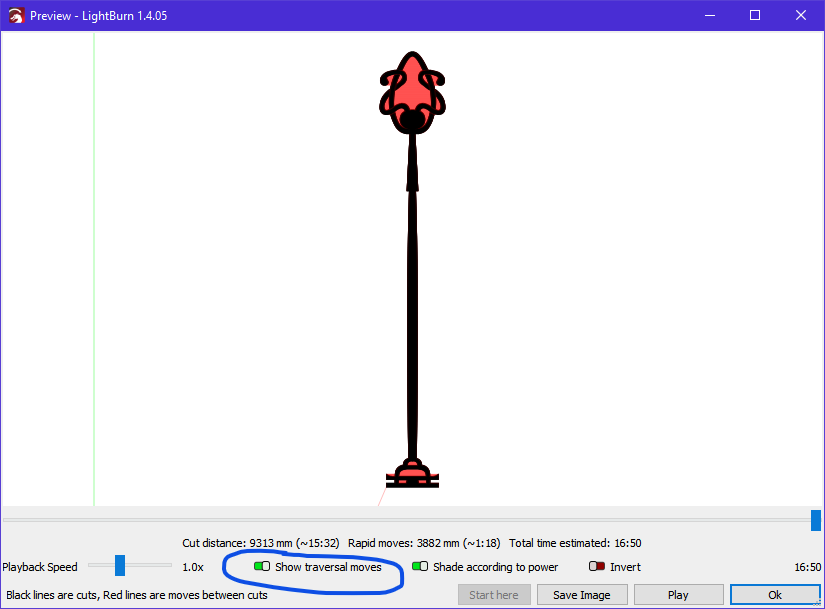

This is very helpful and it works. I’m a little confused by the red color in the preview, are the red parts not being filled? ( Which is what I’m hoping for )
Those red lines are the moves where the laser is turned off. To hide these just turn off the ‘Show traversal moves’ toggle:

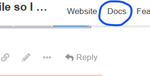

I’d highly recommend going through the Lightburn documentation. You’ll find links in the Help menu:
as well as a link at the top of the forum page:
