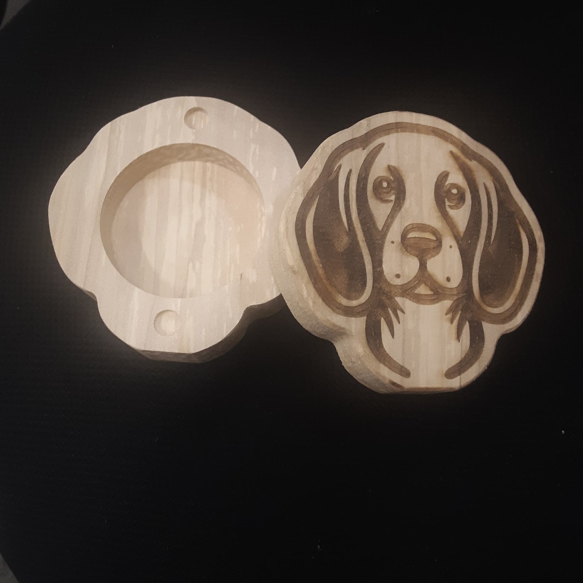

My process starts with machining the part on the router.
If adjustments are needed afterward, I find it far simpler to fine-tune the LightBurn file rather than remachining the entire part.
Yes, precisely. A great example. I get the CNC part first. Do you use part of the lid shape as an alignment point or have a jig to physically hold the lid into on the laser?
Thank you for the example.
Suggestion: You could produce a CNC project with registration marks (pins) and use the centers of those to ‘Print & Cut’ in LightBurn. Simpler still, use a jig cut from cardboard in LightBurn to hold the part cut from MillMage and line it up that way. :slight_smile:
Yes, I use the part’s profile for alignment—since I usually make one-off pieces, this method works well.
If I were producing a larger batch, I’d switch to using a jig.
For one-offs, I just score the profile onto a scrap piece of MDF and use that to align the part.
