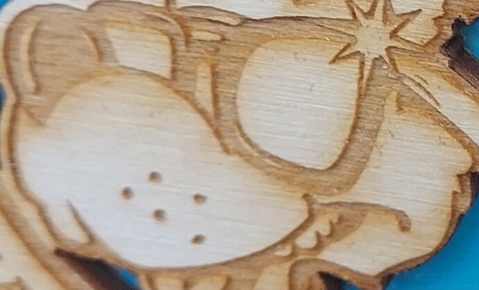

One of my current customers had some dual layer ornament style stuff hanging on the wall. They were 2 layer type of work. You can see the part that was kind of “engraved” away on this closeup but shows no real sign of burning.
The top piece kind of looked like it my have been CNC’d. Do they make ummmmmm, smaller scale CNC machines for the hobbyist? If anyone uses one do you have a recommendation? Can you use Lightburn to run those styles of machines?
If this top piece was lasered, how was it cleaned?
Definitely the case, because you can’t form the sharp outer points of those stars with a round bit. The serrated bottom of the trenches also suggests a laser.

The piece is 80mm across.
When I look at the piece from the side. The top layer is a different color to it. A bit lighter than the bottom piece. This tells me it’s a different wood, OR, cleaned in something to remove soot.
I know you can mask with tape and I’ve done that, but there would still be some burning in the lower / recessed areas. I think they are paying 4.25+ for them, and retailing them for 7.99.
When I look at the bottom circle which is solid, it appears to be the same wood grain. This kinds of makes me think the top piece was cleaned with something since it’s a bit different in color.

Na, they were sourced in the US. The dude put his name on the back and scribed in crafted in the USA near the magnet. This particular piece is a refrigerator magnet.
I have some birch wood that I made earrings out of. I have 2mm birch. I’ll try the logo on it, and see if I can brush it with Isopropyl and see what happens.
The 2 pieces together come to 6mm thick. 3mm each obviously.

I just tried to duplicate the dogs face with my CO2 gantry. When I compare mine with his, the more I look, the more I think he used a Fiber CO2. Lines much crisper. That’s all and good. I can make other ornaments with sea stuff in them. I just thought I’d try to duplicate one with this logo it in it.
I found him. Birch wood is used.
