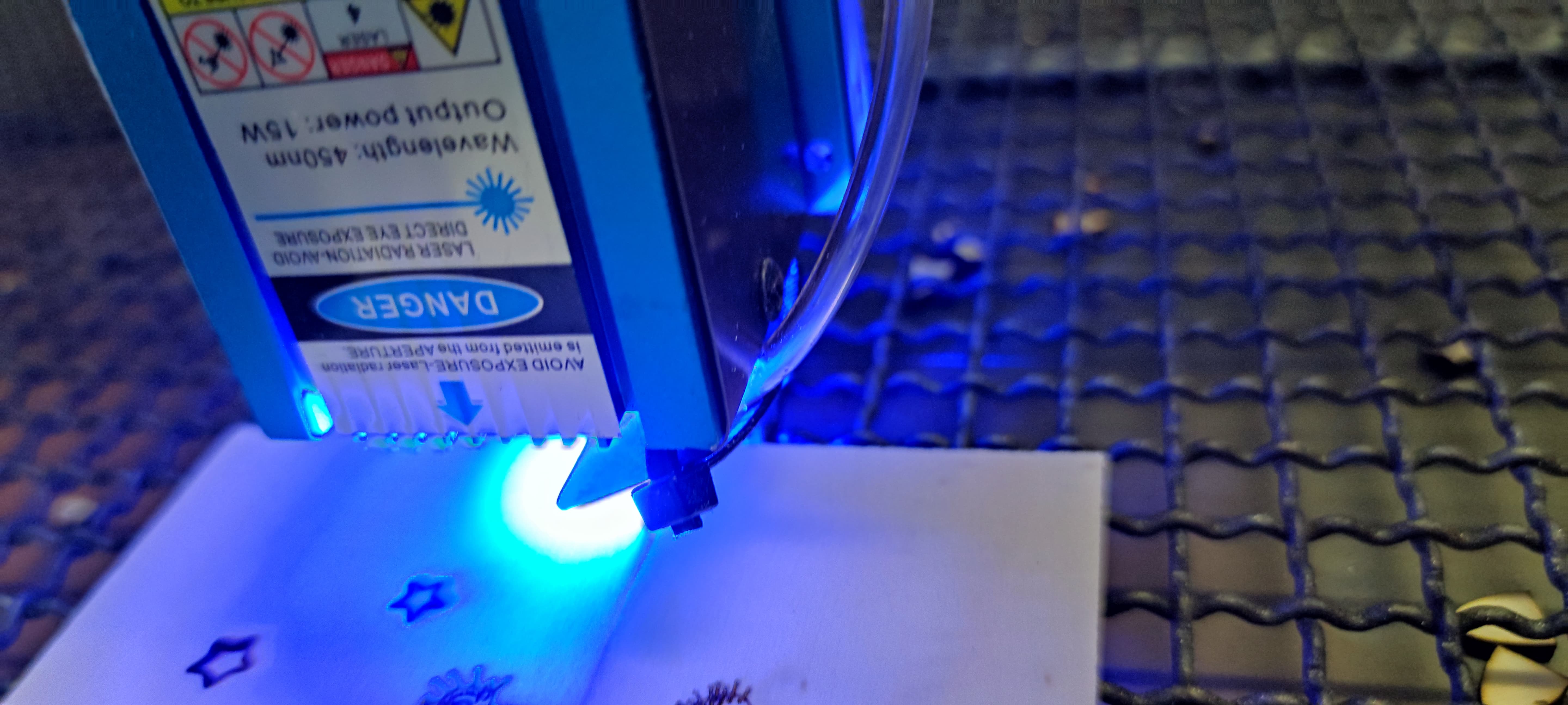

Hi. sometimes I ve a problem with my machine (GRBL Laser 100100).
sometimes it freezes during processing my work, engraving or cutting,the light of laser stays on and I can t do nothing, I must remove usb cable, reconnect the machine to pc and then I can begin a new work.
Someone can help me with this problem?

This morning It makes me the sale problem. I post some photos at the freeze position. I Will try to buy another cable buy I Hope you can see and solve the problem :wink:
