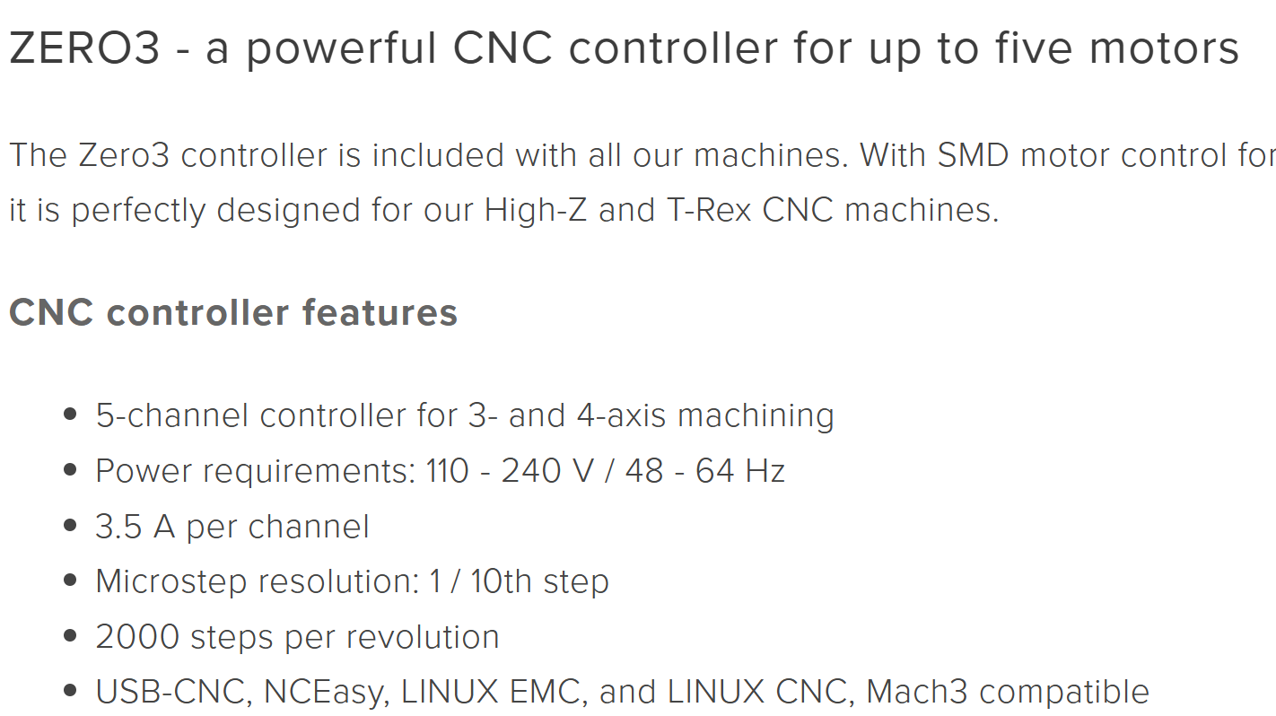

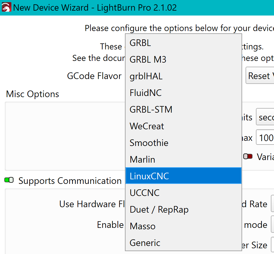

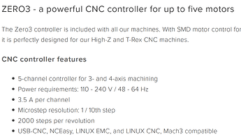

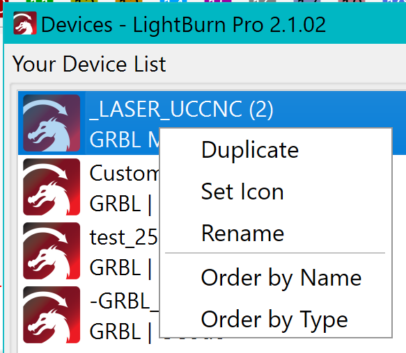

As the Zero3 controller commands the machine trough a Parallel/Centronics interface is compatible with Linux CNC and Mach3 and maybe UCCNC (they have some accessories for StepCraft):
Maybe if you duplicate the Device already configured or create a new one set to the above Flavors is faster to achieve what you´re trying.

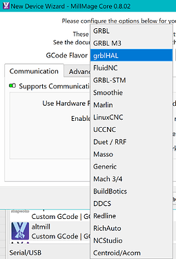

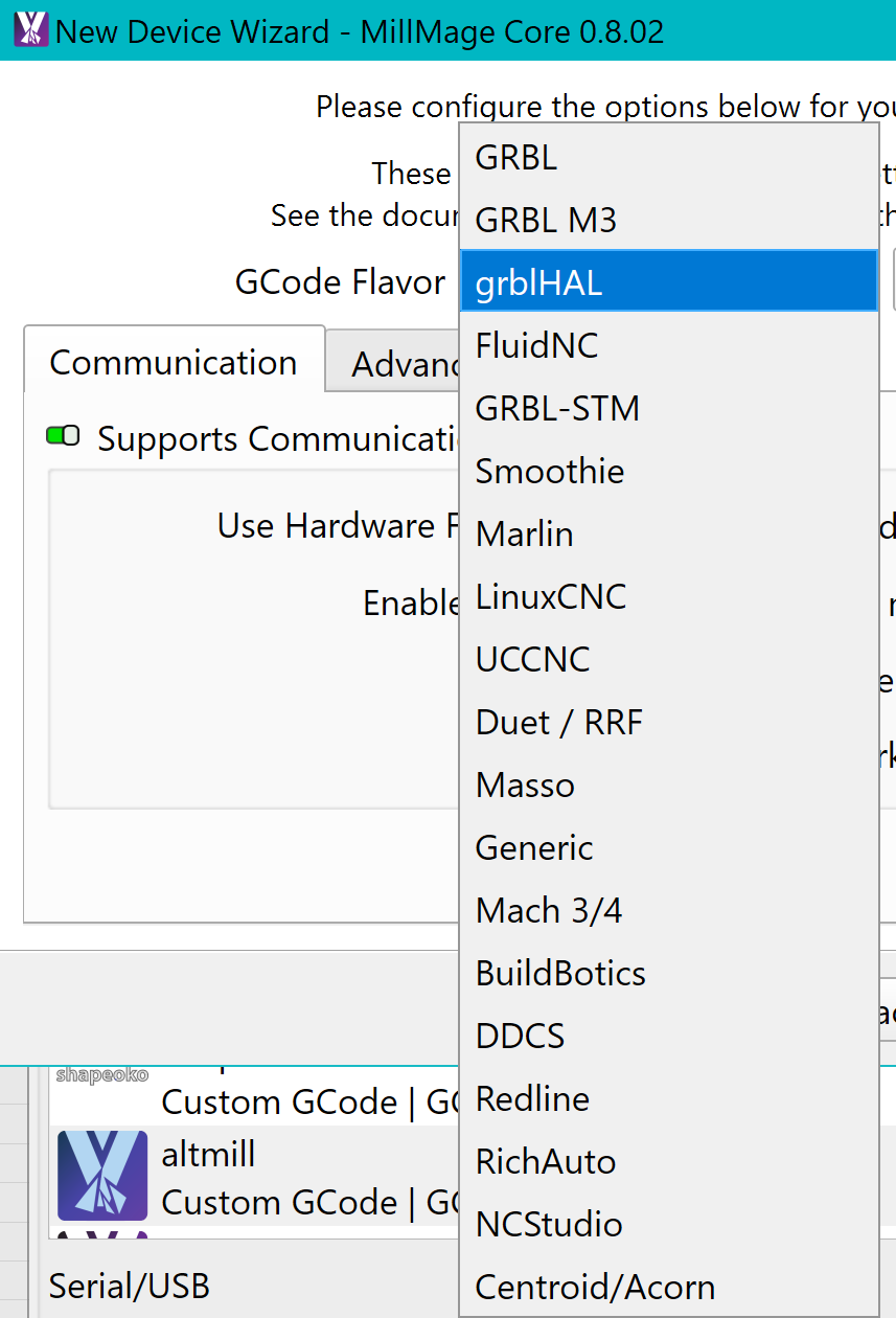

You can also have a look at MillMage, more intendend to CNC Routers:
