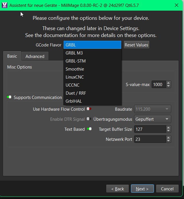

is there a Chance that i can operate my Maching with MillMage?
because i am tired with the many fun killing Bugs on Mach 3.
i really like Lightburn and really liked the anouncement of MillMage
Can i get my hopes high to be able to run my Controller with Millmage without using Mach3 anymore?
Any recomandtions for what i should choose here?
I tried many preferences and settings but did not have any luck or progress.
any recomendations are welcome
Thank You all :slight_smile:
At this time, MillMage can produce GCode for — but not directly control — machines running Mach3/Mach4, LinuxCNC, UCCNC, or Duet / RRF firmware.
The GCode produced using the linuxCNC profile should work well for GCode generation with your setup. Please let us know if you have any questions and how you progress. :slight_smile:
FWIW MillMage will Never replace Mach3/4, UcCNC, LinuxCNC, Centroid etc.
They are real time control systems that send step/direction signals and not simply a g-code sender like GRBL or Fluid-NC would use. We will never replace a real time control system. It’s simply not our wheel house.
Millmage is basically a replacement for Vectric’s Cut2d product’s. It’s on the lower end of though as Vectric has been around for over 10 years and MM is not quite there. They need to change alot in order to become a Vectric competitor though. Eventually? maybe.
