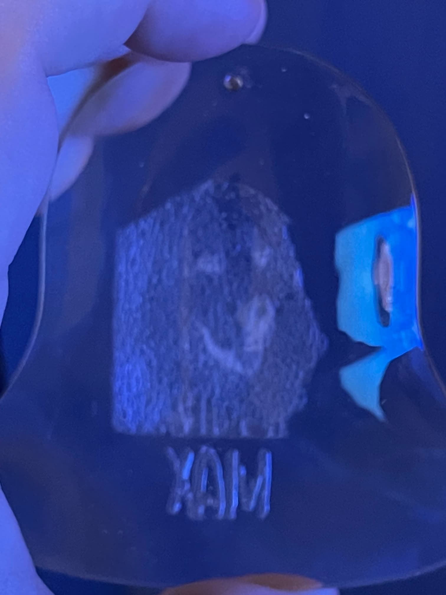

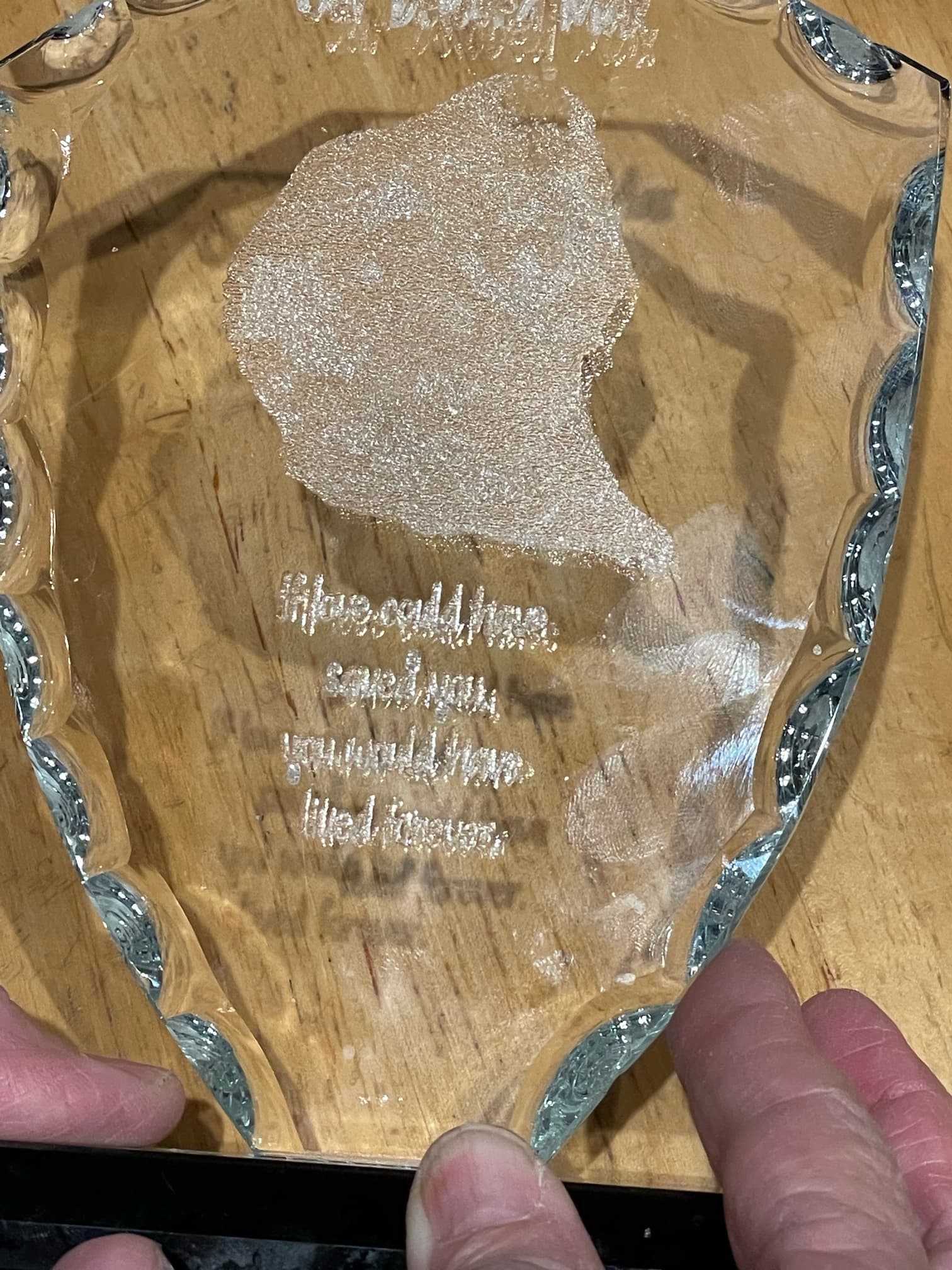

I am trying to engrave photographs on Glass Plaques and Glass Ornaments and can’t seem to get the photos to come out so you can see what the photo is. It isn’t recognizable it’s just a blob. Can someone give me some suggestions on what I’m doing wrong. Thank you so much.

A co2 laser engraves glass by shattering it. Since it’s not a spot like for other materials, it’s more of a broken crater. So the dpi you can expect is probably lower than the spot size.
Most lasers can make a spot about 0.10mm, that would limit your it to 254dpi.

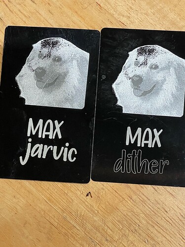

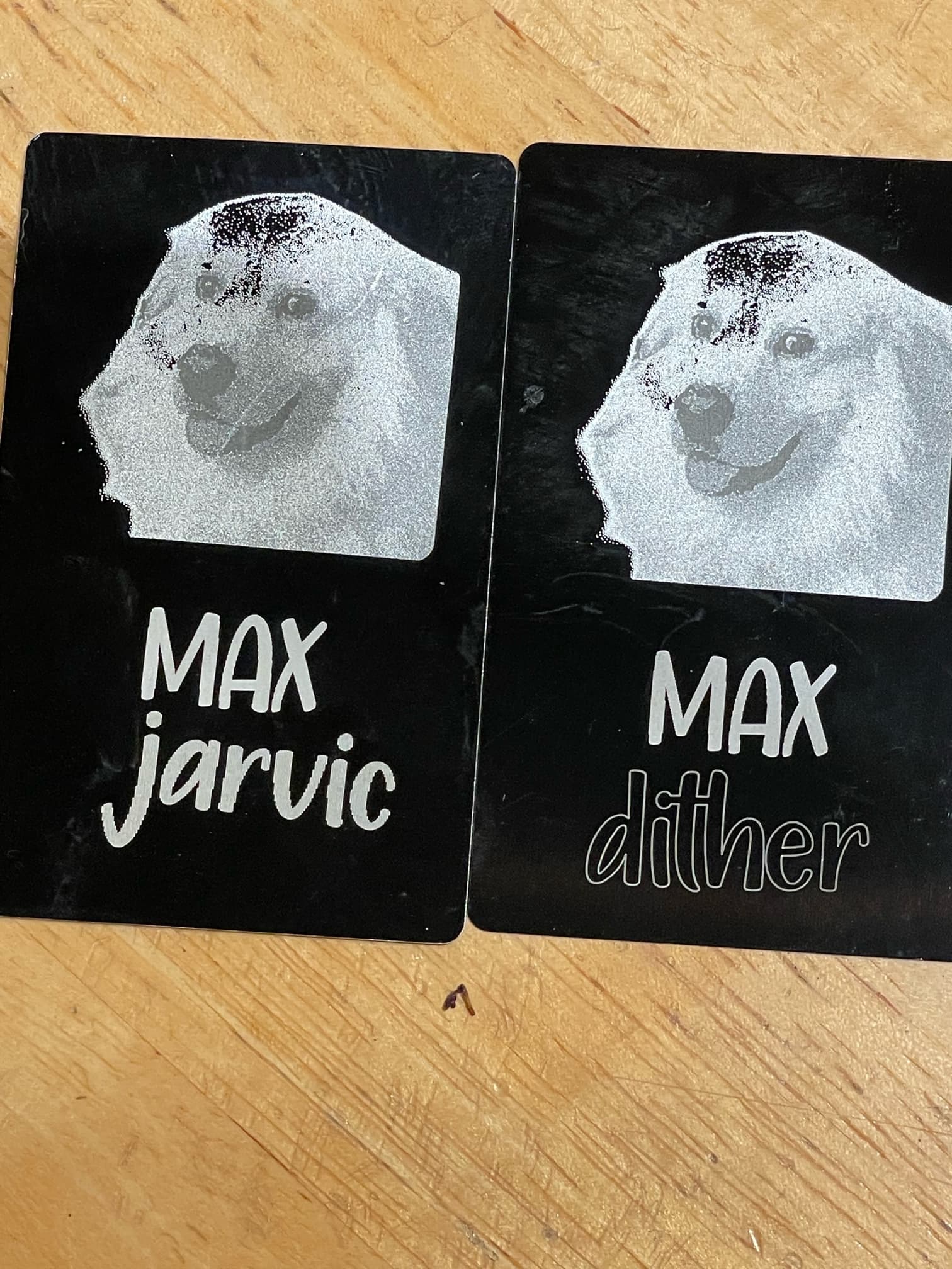

I have an 80 W Omtech CO2 laser I use ImagR and Lightburn. Here is the untouched photo and my results.
FYI… I have watched every video that references photo engraving and the video that you referenced 4 times. I follow the steps and those are my results. My mirrors are fine I’ve done that check and all the pulsed dots were in the center of my mirror.
Can we see some photos of the test strips, like that in the video?
