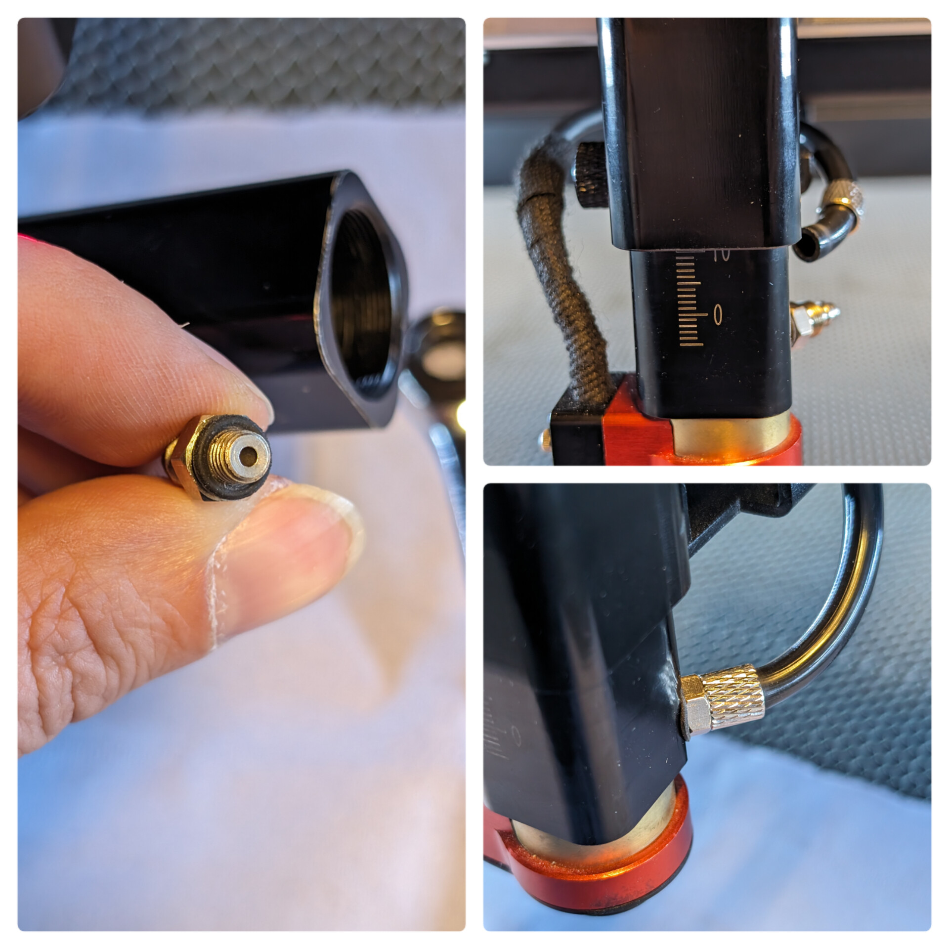

Also, rgds airflow I became somewhat convinced there was not enough, due to molten foam sticking back together once cut, whereas the 80w used to cool it better (with a smaller pump…)
On the 130w machine, the connection from air hose to nozzle inlet has a 2mm hole (more or less) which doesn’t seem large enough of a diameter to let any decent amount of airflow into the nozzle chamber - the 80w has around 3mm, including through the 90deg elbow inlet connection. I also query whether the concave cone shape is better or worse when compared to the convex shape on the 80w, which is the machine that outperforms…
