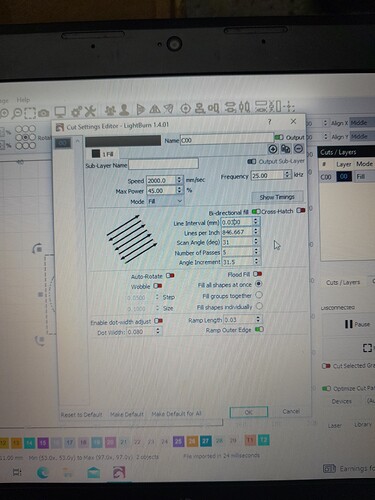

Hi, im trying to figure ramp settings on my Co2 Galvo. I can see that with a gantry you adjust your min/max settings to achieve this setting. But i dont see any min/max settings for the Galvo settings. I can adjust the ramp fine but what im getting is a line around the vector thats actually deeper as im guessed its not adjusting the min power for the ramp. Any advice to get the ramp using this machine? Using rubber and trying to make stamps with tapering off edges. Many thanks.

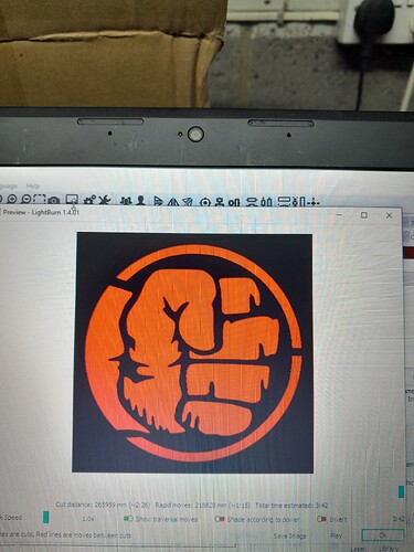

Share a few screenshots, showing the workspace with the art, the ‘Cuts / Layers’ window, along with the ‘Cut Settings Editor’ (double-click to expose), so we can see what you are starting with. Also show us what this looks like in the ‘Preview’ window, along with the results when produced on your material. :slight_smile:

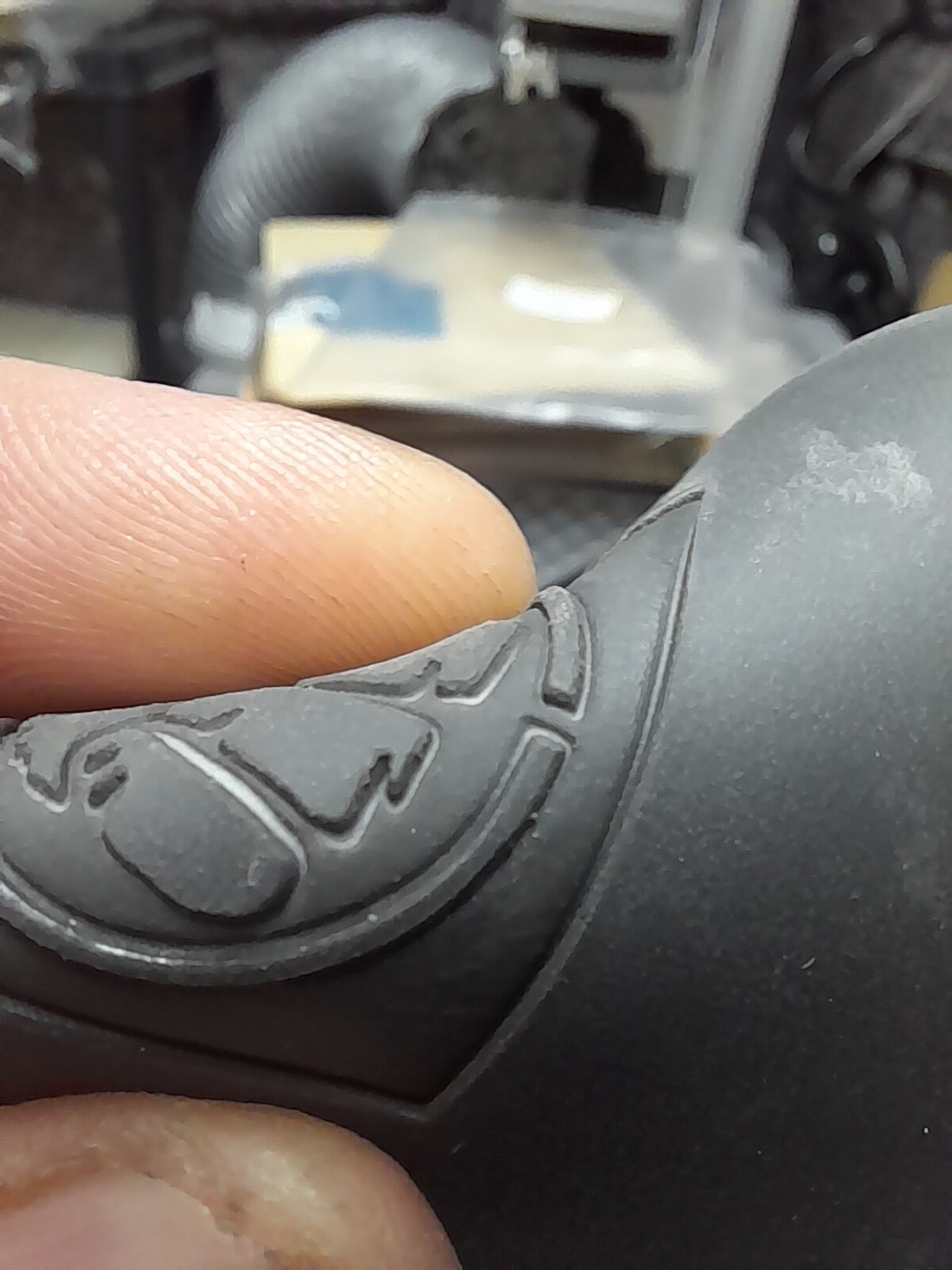

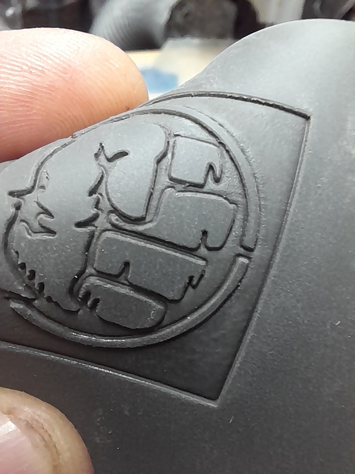

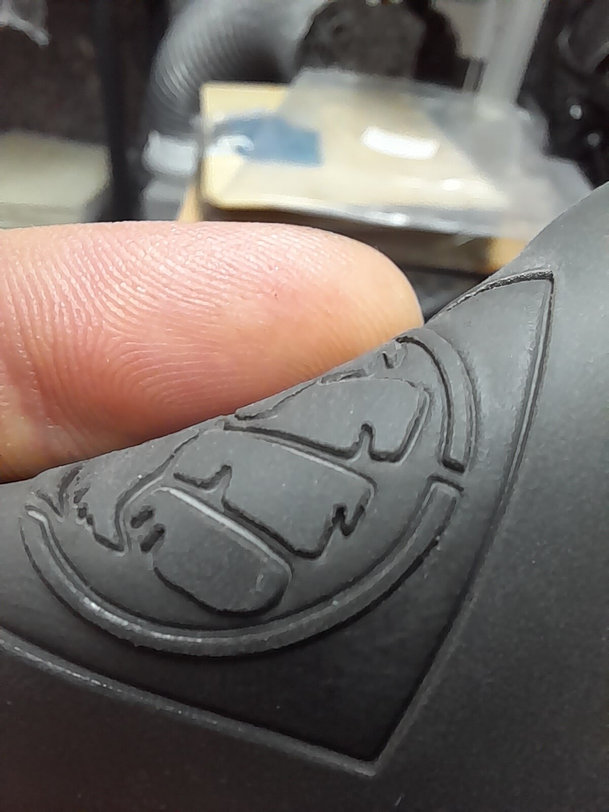

Pics below. Notice the deep cut around the image.
Looking to achieve something like last image if possible, understand that the example is done on a gantry. @Rick
For Galvo (and GCode) devices, the minimum power used for Ramps is 0%.
I believe the edges you’re seeing are due to an interaction with your Galvo’s Timing Settings, which are meant to prevent over or under burning when your laser speeds up or slows down. In this case I believe those delays are leading to relative over burning at the beginnings and ends scan lines. The power is ramping down, but the laser is dwelling too long, making those lines around the edges.
In the Cut Settings Editor, try clicking Show Timings, toggling on Override Default Timings, and setting Laser On TC and Laser Off TC both to 0.

Thank you, this has stopped the deep cutting. Much appreciated.
