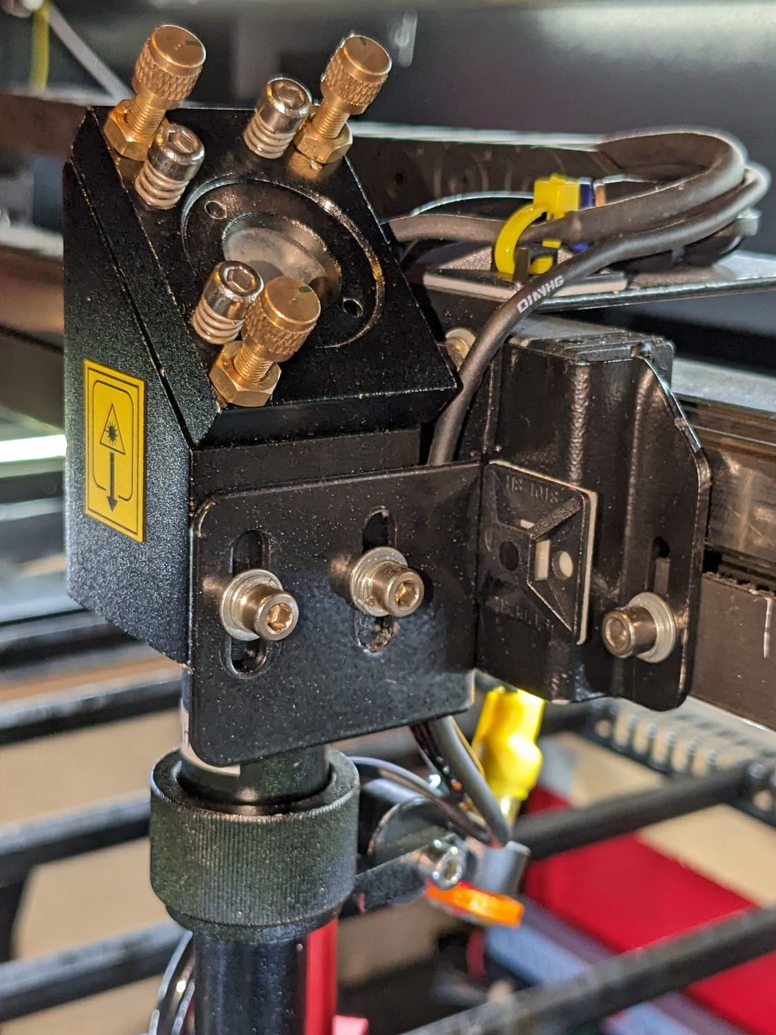

That seems odd, because AFAICT the mirror mounts /head attachment have oblong screw holes in their bases specifically for minor tweakage.
Mirror 1:

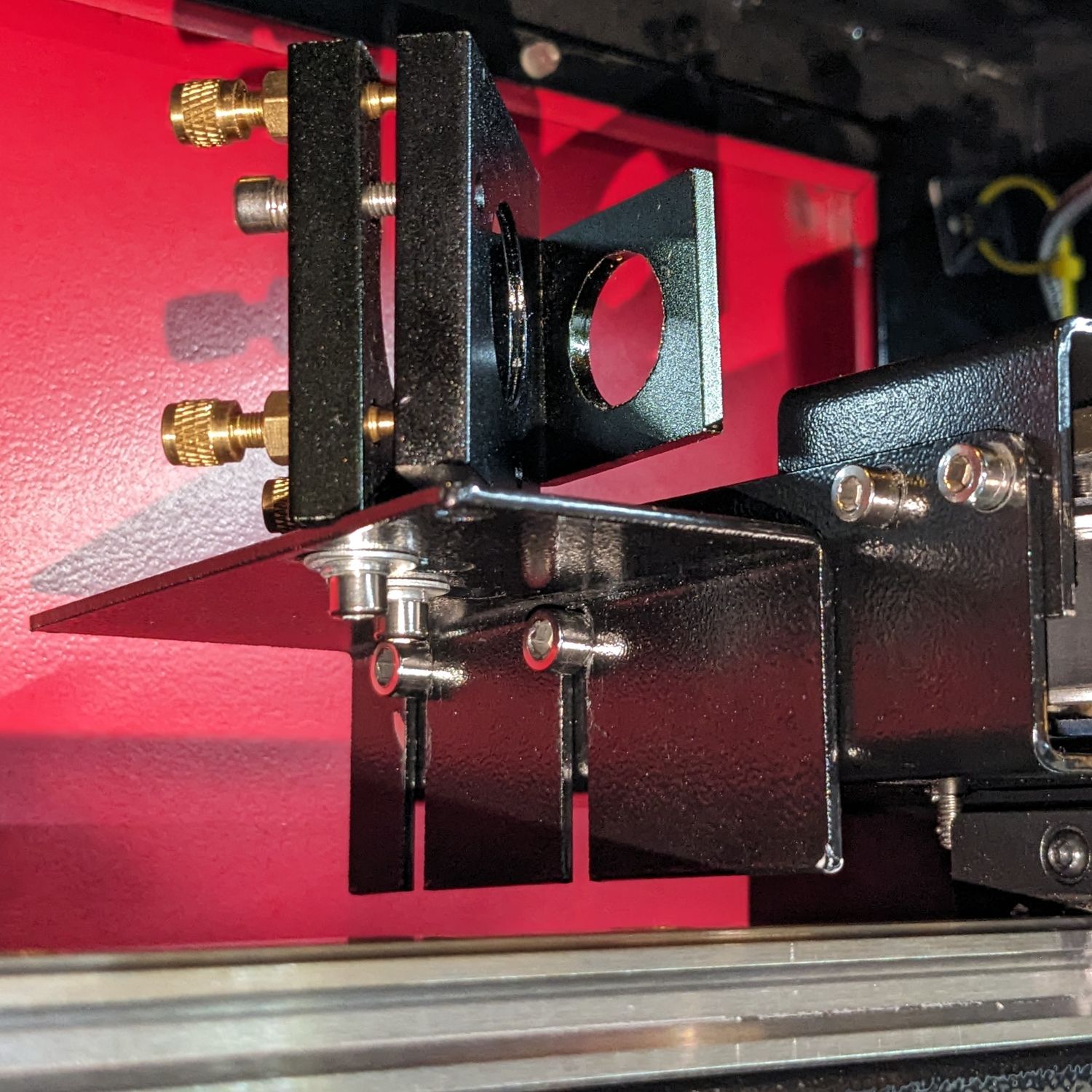

Mirror 2:

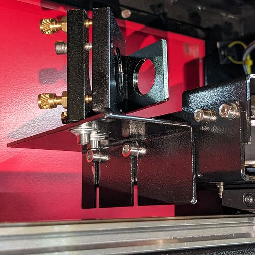

The laser head:
Good pictures of the mounts in your machine will help us see what you see and likely will produce better advice.
I had to reposition the tube in my machine to get the various mirrors off the ends of the adjustment range. It wasn’t pretty, but ended well:
I would say that if the mirrors are not adjustable or hard to adjust that’s a good thing. That hopefully means the machine will stay aligned longer.
The beam doesn’t have to hit the center of each mirror. The beam only has to go from the laser tube to the work surface without hitting anything, over the entire laser bed.
