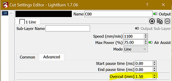

Your Cut/Layer as a Kerf and an Overcut set, is that on purpose?

Hello and thank you for the question. Yes, I normally use Kerf so that the dimensions of the product fit exactly, with small cuts you can be sure that it does not reduce the resulting shape. And I set Overcut because apparently the stepper motors are not completely accurate and sometimes it happens that the cut does not connect perfectly from start to finish. So I am sure that the cut is complete because at the end it continues 1.5mm along the path.
