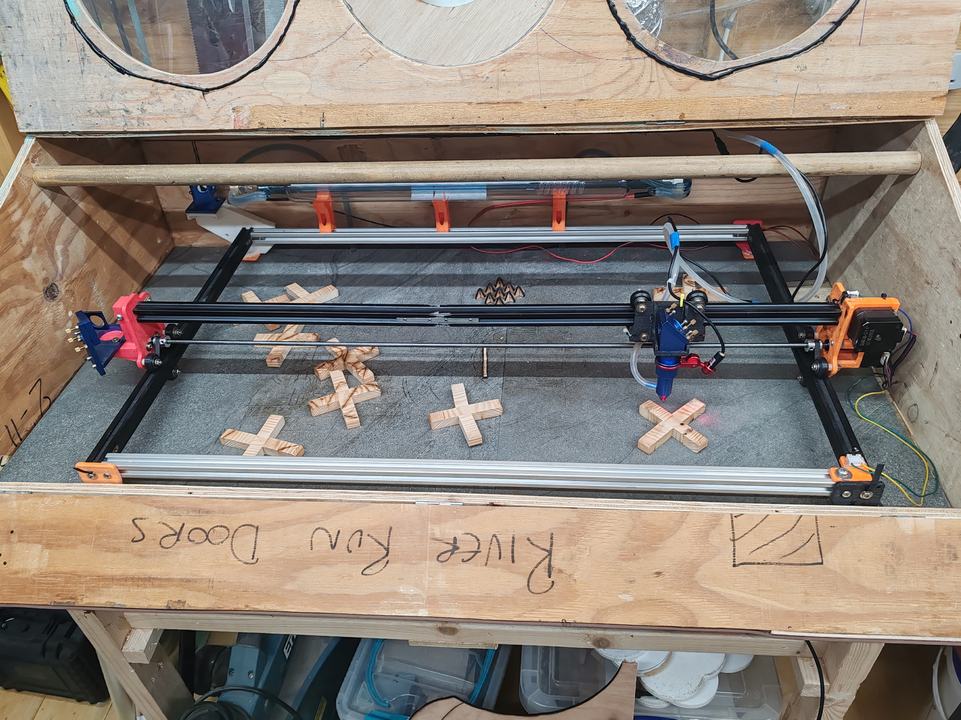

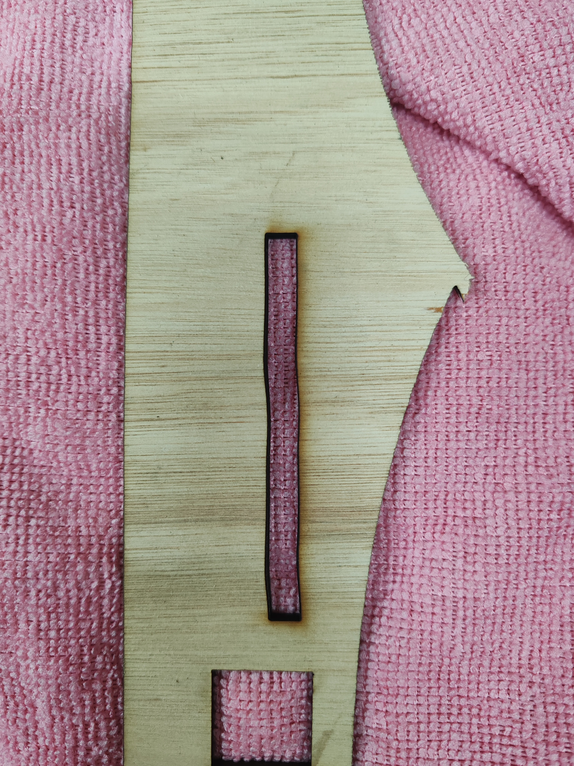

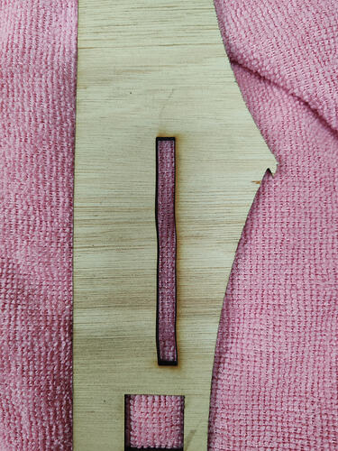

So I recently built a co2 laser. But am having a little trouble with to parts first is the beam It does not seem as strong as it use to be. The second as you can see from the photos is the noticeable wobble on the y axis. I’ve alined the X axis for the beam and have the setting at 10- 20mm per sec on the high end along with retighting the belt.
I’ve been able to cut regular 3mm plywood in the past.
I would appreciate if anyone have any solutions to try or have any advice on my rig. Thanks
The wobble is most likely caused by your x-axis design. To be honest, that looks a bit… temporary. Change the profiles to a single one. It doesn’t even look straight. Then, better not use wheels; use a linear rail. Using the wheel design, you will never get perfect straight lines, since there is ALWAYS wobble in it. It’s exaggerated by the path the laser travels downward.
A gantry that wide should have dual steppers for the Yaxis. That tiny cross rod can easily permit torque twisting from one side to the other. Any dirt or resistance on one of the rails will exaggerate the issue.
If the gantry hits a low resistance area, the slave side might suddenly catch up causing that zag in the middle.
Opinion: The machine frame isn’t rigid enough.
The splice between the gantry extrusions seems to have a significant droop that will affect both the focus and the beam angle as the carriage crosses it. If those extrusions don’t meet exactly, the carriage will rock over the discontinuity and create irregularities much like the picture.
The mechanical strain from the air hose and red-dot cable is concentrated at the nozzle, far from the carriage wheels, where it has plenty of mechanical advantage to push the entire laser head. Any looseness in the head or the rollers carrying it will show up as the X axis moves.
The long jackshaft rod seems to have a gentle bend that will affect the rotational speed due to the unbalanced weight as it turns, particularly at high speeds, and affect the Y axis motions.
Although I’m a big fan of 3D printed parts and built an MPCNC a while ago, pretty much everything looks undersized to maintain alignment under the fairly heavy loads a laser will impose. Plastic is, pretty much by definition, bendy and thin sections are too flexible for motor / bearing mounts and suchlike.
Replace all of the extrusion joints with metallic parts, replace the splice on the gantry with a single extrusion, add metallic load-bearing plates to the plastic parts, and it’ll become much more stable.
