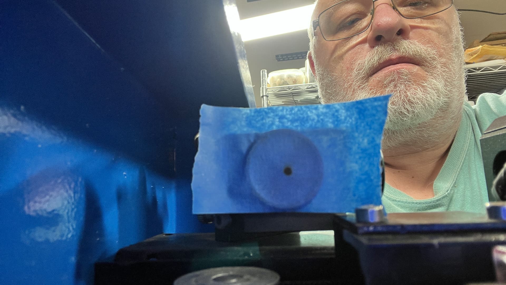

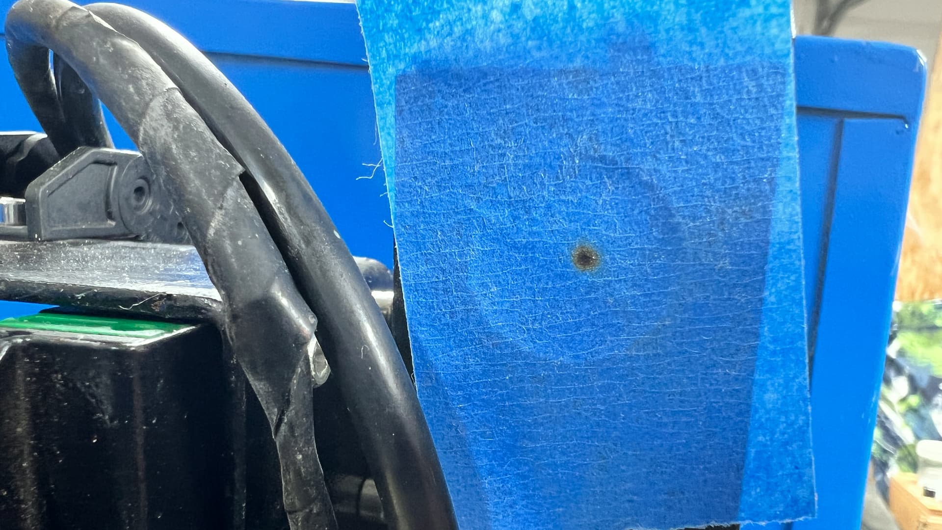

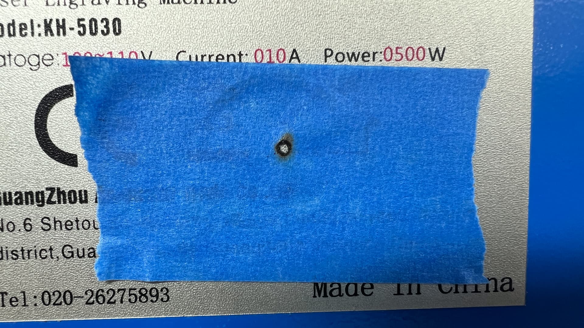

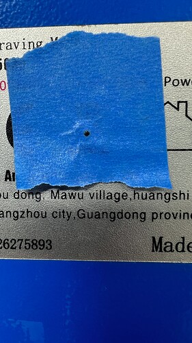

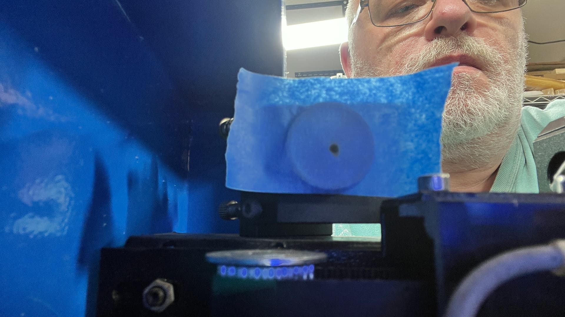

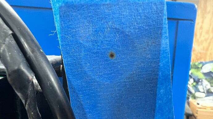

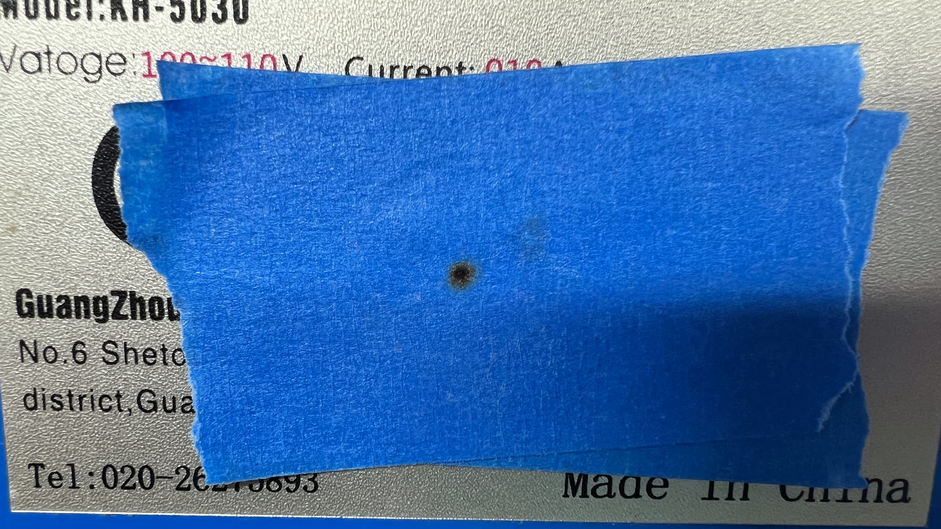

Here are the results from mirror 2 test (near, far, & closeup shot).
And here are mirror 3 test (near, far, & close-up shot)

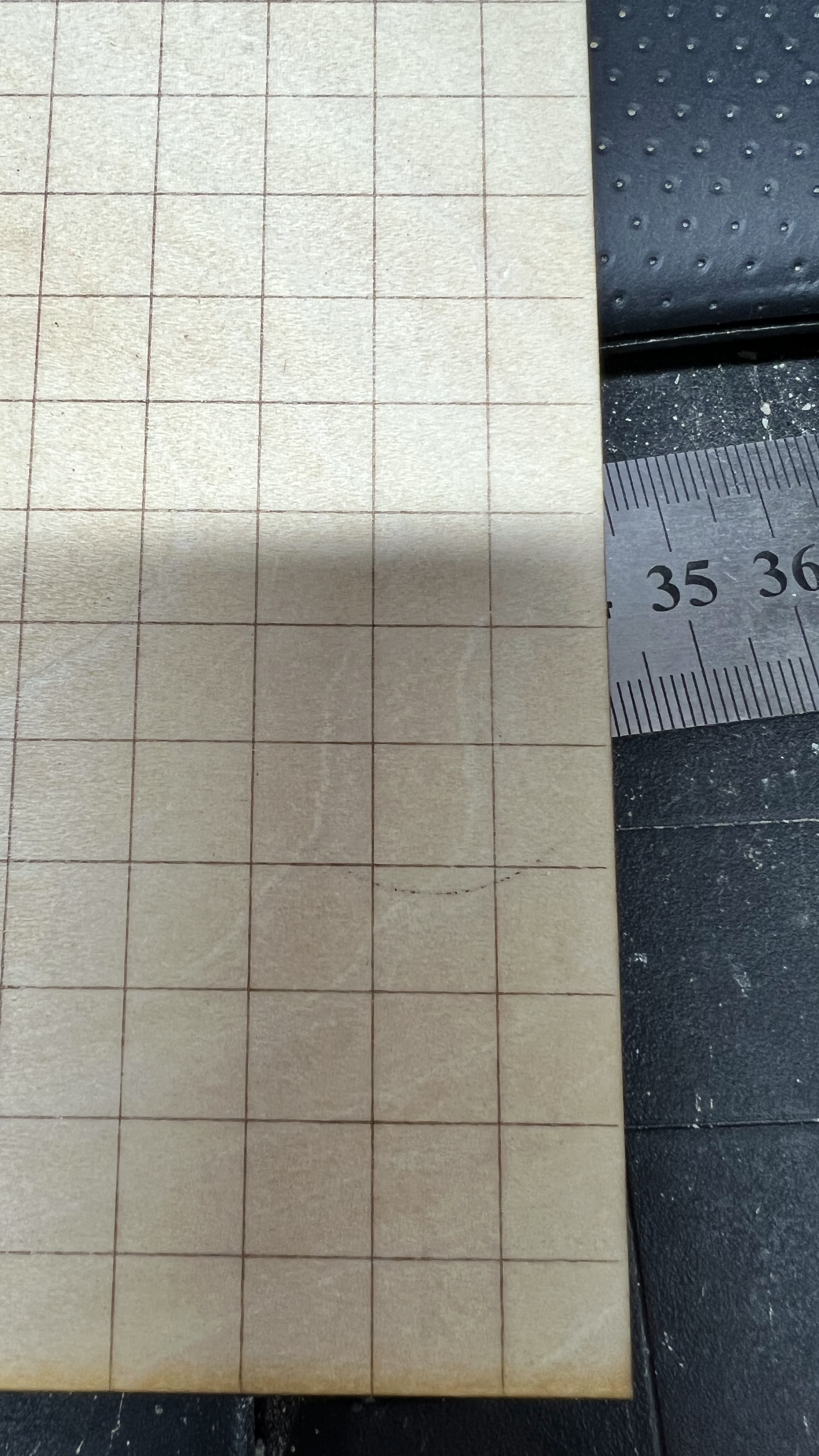

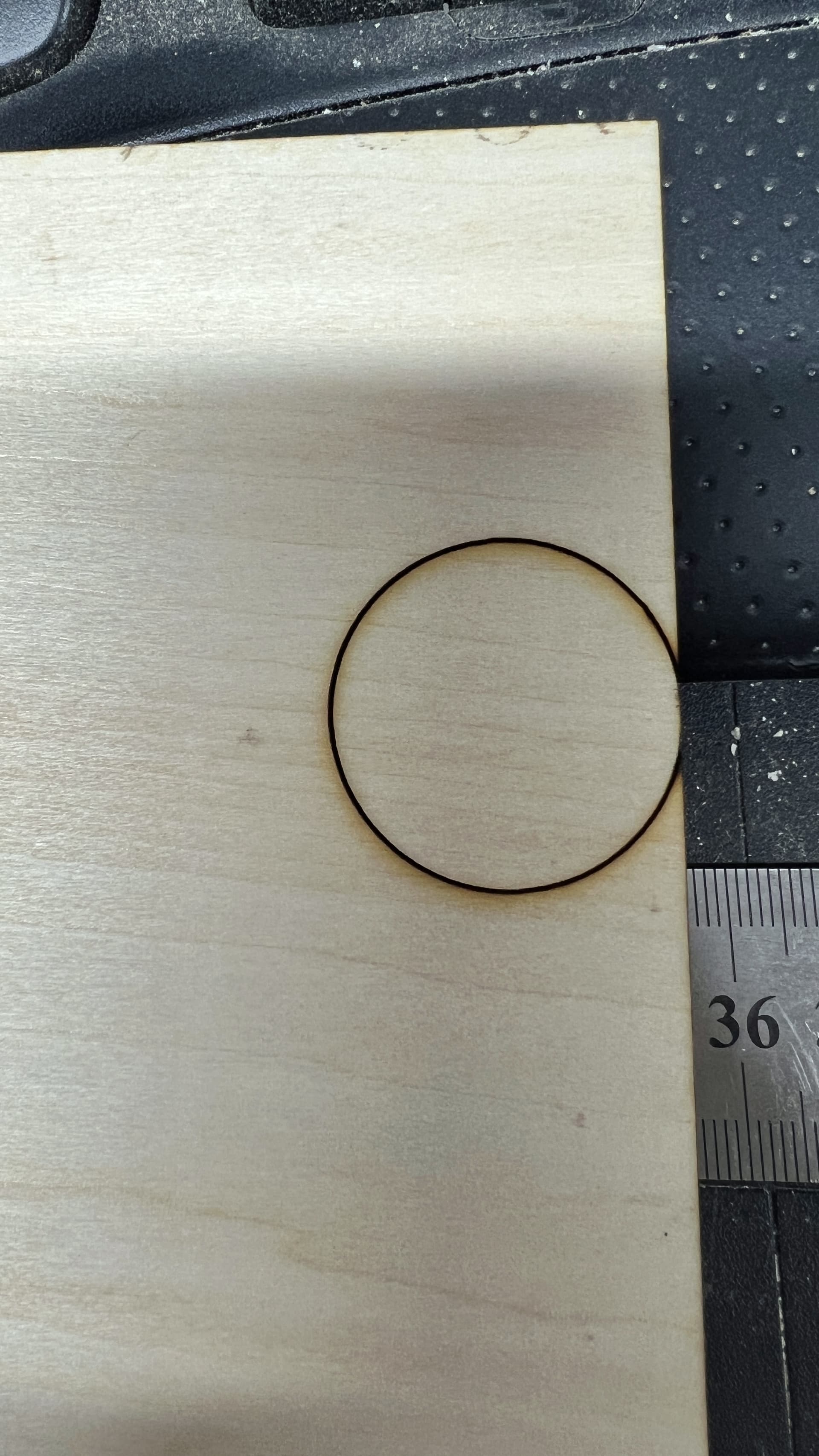

So, I set both the min and max power to 75% and increase my speed to 15mm/s.
Round circle test (side A):
Side B:
Side B shows only the slightest hint of laser burn.
Rocky, 75% and 15 mm/sec is what I use on my 60w to get a clean/burn free cut on 1/8 baltic birch. Leave your max/min at 75 and reduce speed to 10 mm/sec. whether that works or not you should do a material test grid (material test is under the laser tools drop down).

I’ve looked at your m1 shots and there isn’t enough detail to make them useful to me.
You can set the pulse down to ~10mS or lower, low enough you might not leave a mark. You can pulse it more than once to get the desired burn density…
It should show a brown ring to a dark center… It should be round…
The shots of your m1 from the tube are black or vaporized (hole), so I can’t tell what the tube is doing.
I cut my targets out of watercolor paper… sturdy and are easily marked… they also require no adhesive.

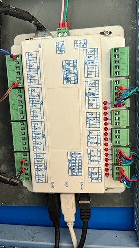

Likely a 6442 type, but you need to open the electronics side of the cabinet to see the controller itself. Controller is the beige box on the bottom left.

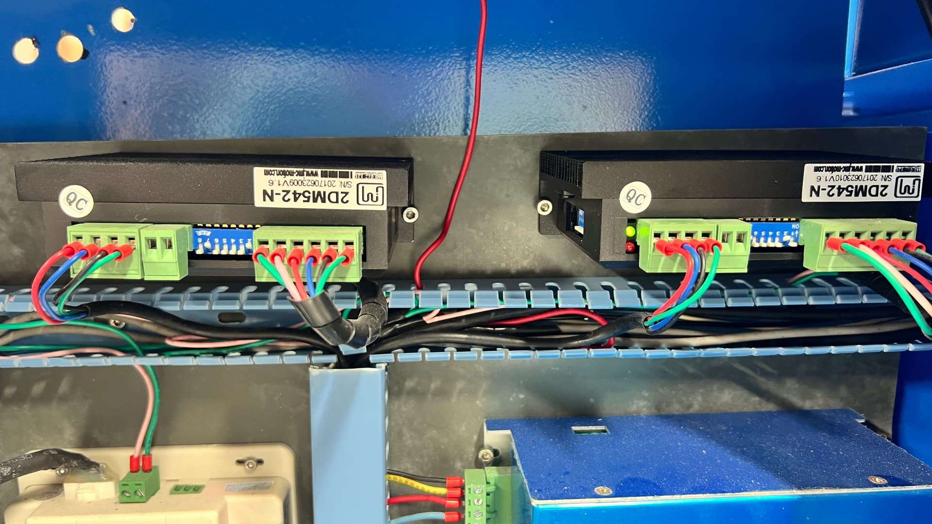

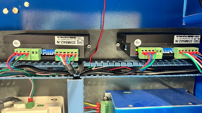

Thank you for all the info! I’ll reduce the power as you’ve explained and retake photos of mirror one but I have a larger issue at the moment - the blinking light on one (or sometimes both) of my stepper motor drivers has returned (m/n: 2DM542-N).

As for the controller, I also believe it’s a 6442G. However, I couldn’t find a label on the unit. Here’s a pic:

Generally speaking, these are pretty tough devices. It’s unlikely that both are bad as they have both gone red on you. I’d check the supply voltage, most of these are driven off the 24V supply…
These motor drivers are about $20 US last time I got one… I keep one around… so swapping them out is a low cost item… still bothers me that both have shown an issue.
The controller looks like a 6442 …

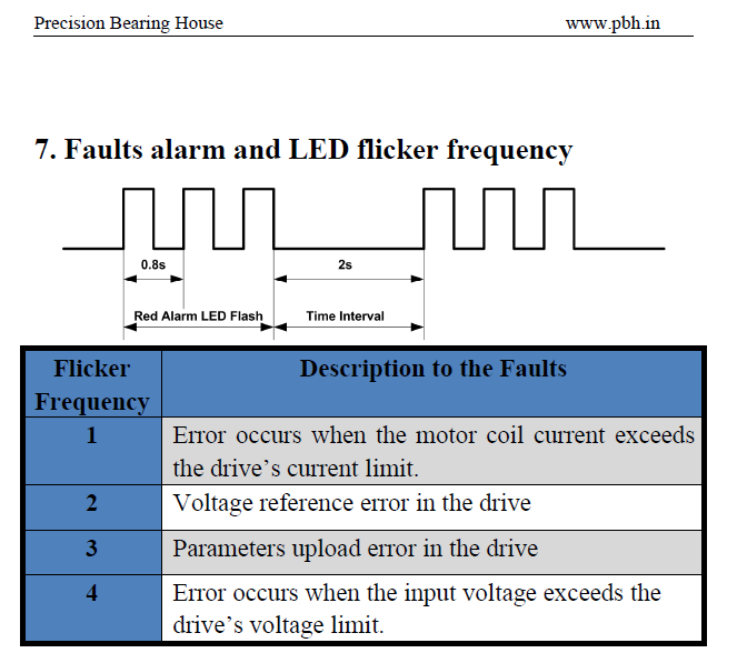

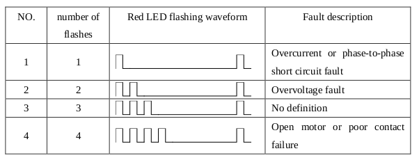

Any thoughts on why the driver modules are blinking? Or more precisely, how do I find that info?
I found a manual for the module on-line but I’m not sure what it’s telling me…
If I’m reading this right, it looks like I’m getting 1 blink. Does that mean the stepper motors are bad?
I’ve never had any of my stepper motor drivers error out… The indications are that it’s drawing too much current, over what is set
Motor drivers allow you to set the maximum current for the motor.
The switches on the motor driver are used for various setups. You have to look at the placard on the driver (or in the manual) and see what the current limits are for your driver and what motors you have.

This is from the 542 manual I have… is it on for .4 seconds then off for 2 seconds and the cycle repeats?

You can check your switch settings and compare them to the the data sheets… On mine the current limit was set to twice the allowable current for my motors…

I’m not an electrical engineer but the best I can tell, the driver modules are set for 3.31A Peak / 2.36A RMS(?). Switches are set at 1 - OFF, 2 - ON, & 3 - OFF.
According to the data sheet you sent, the Mounted Rated Current is 2.2A. That would seem to all be correct, right?
Highly unlikely.
From the original photo, it looks like the switches (Switch block 1, SW1-3) are set OFF ON OFF, which corresponds to 3.3 A based on the only info I could find:
That’s reasonable for NEMA 23 size motors typical of CO₂ lasers.
The error blink patterns seem to vary among various 542-flavored drivers, but having both drivers report an error at the same time suggests a power supply problem, rather than a driver or motor problem.
It may simply be that the wiring from the 24 V power supply to the drivers isn’t quite up to spec or suffers from the usual loose terminals / screws / ferrules.
Your picture of the driver shows the power terminal plug is not connected to anything, which would definitely cause problems. :grin:

I’m not sure which plug is the power terminal. Looking at the manual, it looks to me like the empty, two wire connector is for the pulse signal (ENA- & ENA+).
Since I have no background or knowledge in this area, I’m not certain so if I’m wrong, please let me know.
I was standing on my head reading backwards: objection withdrawn!
Yes, that sounds about right. But it’s not consistent. I’ve had times were the Y-axis driver blinks but not the X-axis; other times when both blink; and times when things seem to work properly. But the blinking pattern itself seems to be consistent.
Ideas on where to start searching? Vendor settings?

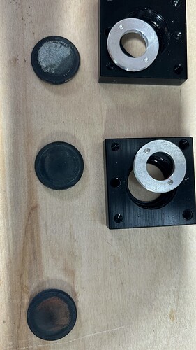

Ok… after poking around a bit more and hours of frustration, I believe I’ve found the problem. I’m going to mark this as the solution in case anyone else is reading this. If after making this repair/replacement, things still don’t work I’ll open a new thread.
While I was hesitant to start disassembling parts I know little about, I finally removed the mirrors. I had tried cleaning them through the openings but didn’t get any better results. Upon removing the first mirror (M3), it became obvious why the laser wasn’t cutting properly - they were filthy and possibly damaged. I’ve ordered a replacement set on-line and am just waiting for them to arrive. Here’s a pix of what they looked like. Keep in mind this was AFTER cleaning them while on the machine.
Thank you, everyone, for all of the help!
