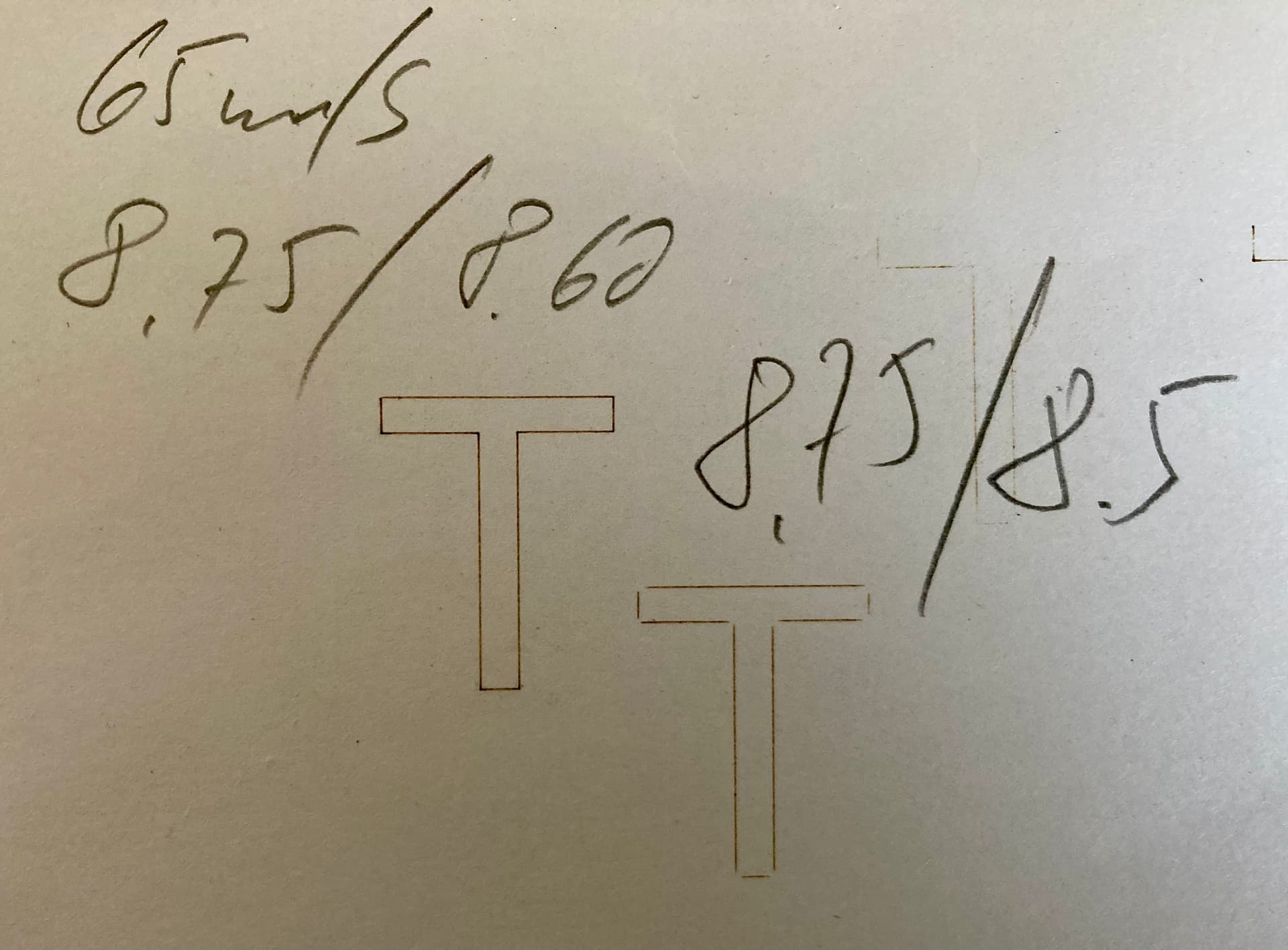

so your all not going to believe this. this tube use to fire at 12% its now 20% min fire, so on all the advice ive been given here and else where i brought a new tube. remember my old tube was made in 2018. well i swapped it out tonight, its a mcw tube so not a cheapo. and its no different to my old tube. material tests are the same although i do have a slight alignment issue to sort out. but generally im still at 24 speed, 90% power and 1 pass. same as old tube. i have played with some material tests and have got it up to 100/50/3 passes which i was impressed with as it didnt hit the cylin of cutting speeds on 3 passes by a long shot but tbh i never tested th eold one on these types of speeds lol. min fire thing is confusing me. at 20% my supply is putting out 6ma.

Thank you for your detailed reply. Interesting items on the max ma. I’m waiting for mcw to tell me what there max setting is. You say 8.5% is your min. Mine at 10% is showing no ma on my meter. When pulsing the laser for alignment etc I used to use 12% and it would fire. Now 20% is my min. Something has changed. I think I might invest in a new power supply and worst case scenario I have a spare. Last time I tried 5mm plywood it would not go though no matter what power or passes I did but not tried with new tube yet. I think my mirror three is an issue. I found a new way to set it up and will try again tonight.
It needs to be corrected a bit, the tube is not new anymore.
I just tested to be precise, I need to go up to 8.6 to close the holes and up to 8.75 to get a clear output trace of the laser, see picture.
At this power setting I have a 3-4mA reading on my m Ammeter.
