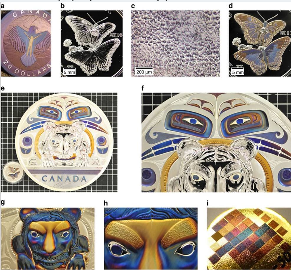

Laser-induced plasmonic colours on metals. Photo from this link.
IMHO, it’s a lot of work, you can’t easily transfer color information to a different type or size of the material or image.
