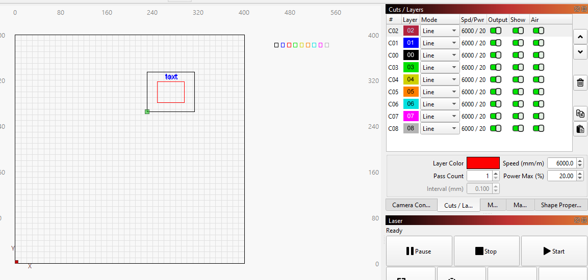

Hi,
I want to cange the order of the colour palette.
I only use laser for cutting.
In CAD (Software is QCAD) I use
black for outer lines, red for inner lines,blue for text and some others.
I would like to have the order red, black, blue, …
I changed hex-codes in file palette.json, but the has no effect.
Is the any chance to avoid order in cut/layers?
Thanks, adebar

If you are intent on sticking with a certain colour convention in your CAD and if rearranging layer order, or ordering with ‘Optimization Settings’, or using a saved template will not work for you… then changing the colour palette is an option but not ideal for most* people due to the caveat mentioned earlier in this topic.
Rather than change layer colours, what you ideally need is the ability to rearrange the default layer order, this has been requested before so I would encourage you to read this Fider request for more information, and upvote it:
Remember layer order between invocations · LightBurn
Back to your problem, make sure the palette.json is in the correct folder (File>Preferences>Open Prefs Folder), and also ensure the quotation marks are like this " (not or), and the last member of the array should not have a , comma.
Restart LightBurn after adding or changing this file.

Oh I didn’t actually realise a palette.json file was present in the “C:\Program Files\LightBurn” folder …sorry… now I know what you mean by “Lightburn installation folder”!
You will need to copy that to the same folder as your prefs.ini:
C:\Users\<username>\AppData\Local\LightBurn\palette.json
You’re a good friend :slight_smile:
YES!!! That’s it!
Exactly what I want. Strange thing, thas .json file only appeared in Install folder.
