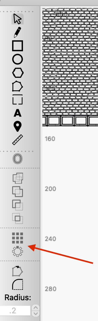

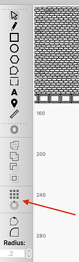

It must be the array function you are thinking of, on the left, approx. in the middle, you will find the 2 array functions.

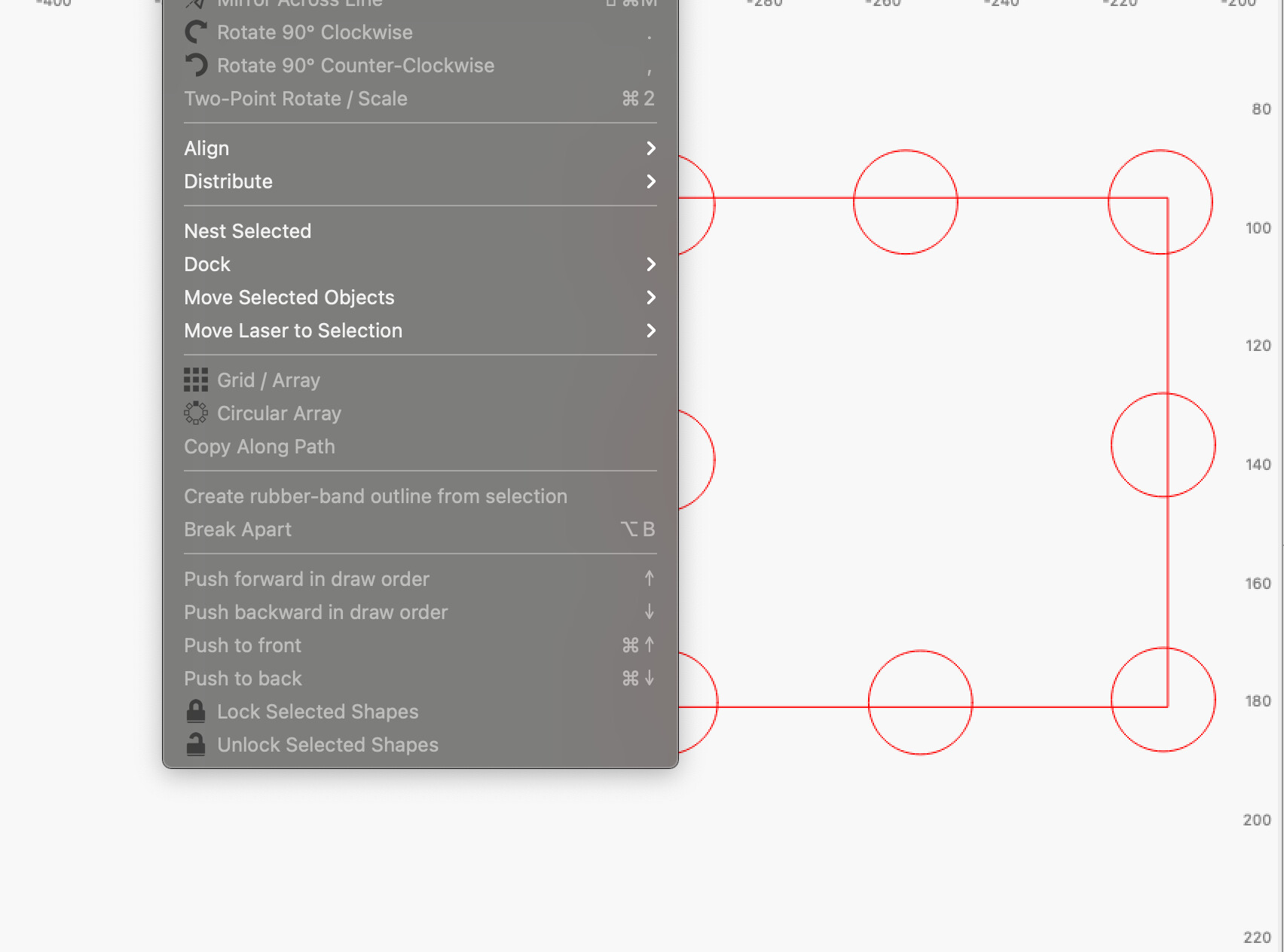

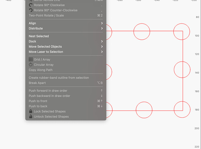

Ok there used to be an icon, but i found it in arrange file above. Now i want to delete some of the circles I laid them out with arrange function but i can’t separate them, I made a square of eight circles each way and want to delete just some of the circles
I must not have all my tools on
…have you ungrouped the circles?
It is interesting they aren’t grouped or ungrouped when i draw a circle to select them only the original is selected

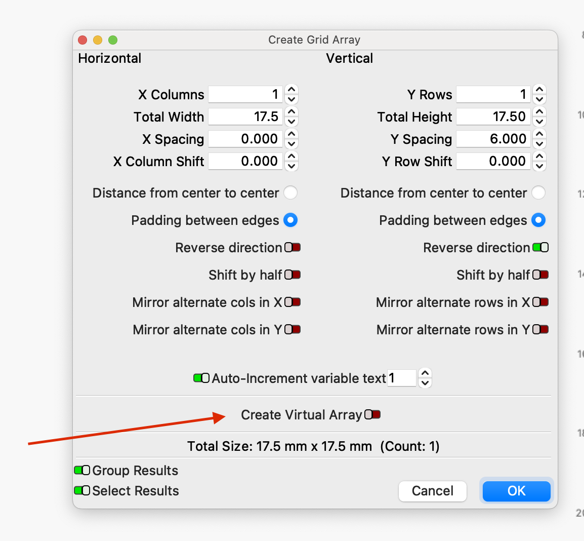

I’m not quite there, have you used “copy along path” perhaps?
ahhhh, …then this function is probably activated.
Sorry no, I drew on 5mm circle then went to arange and made 8 coulmns and 8 rowes 25 mm apart.
Ill go look.
Thank you so MUCH, that was my problem. I havent used my laser much in the last year and forgot a LOT of stuff
