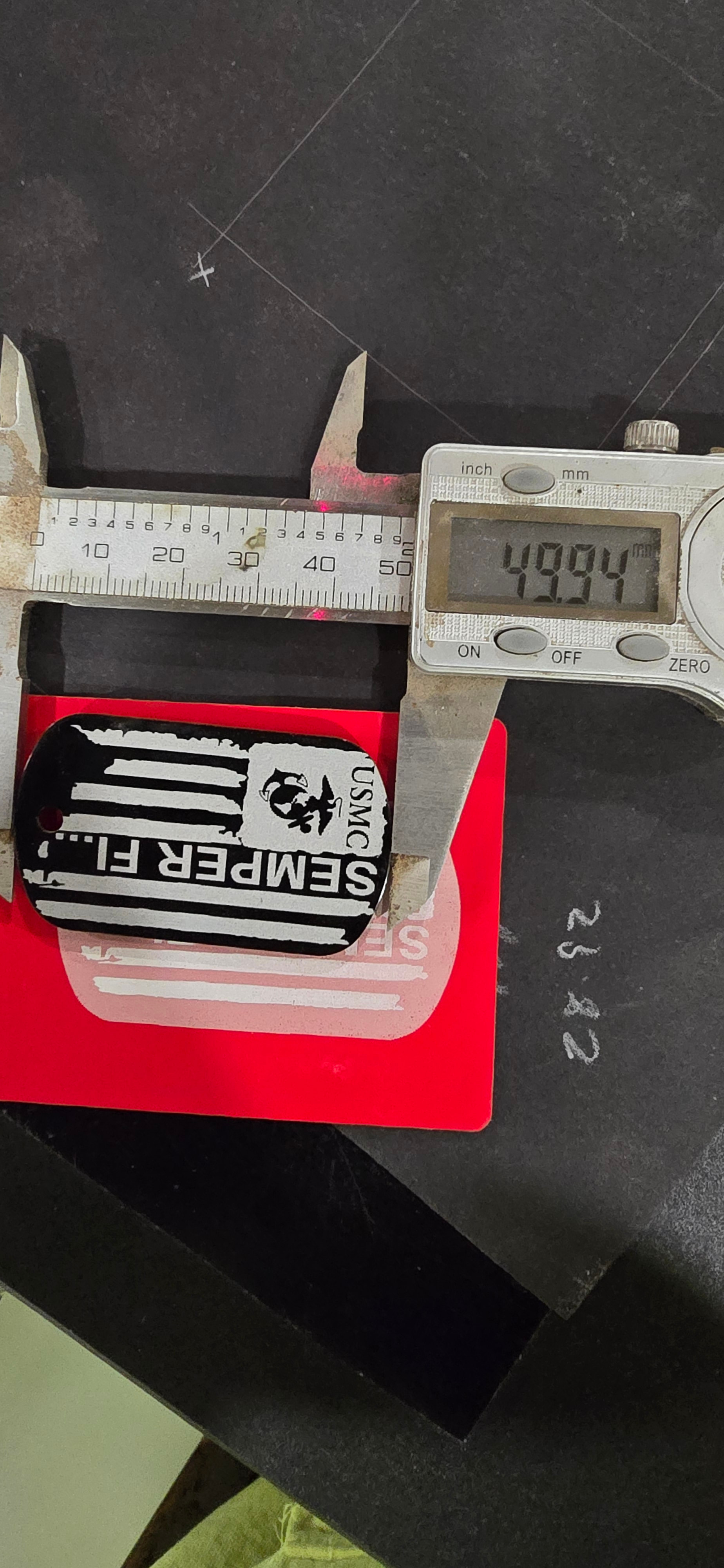

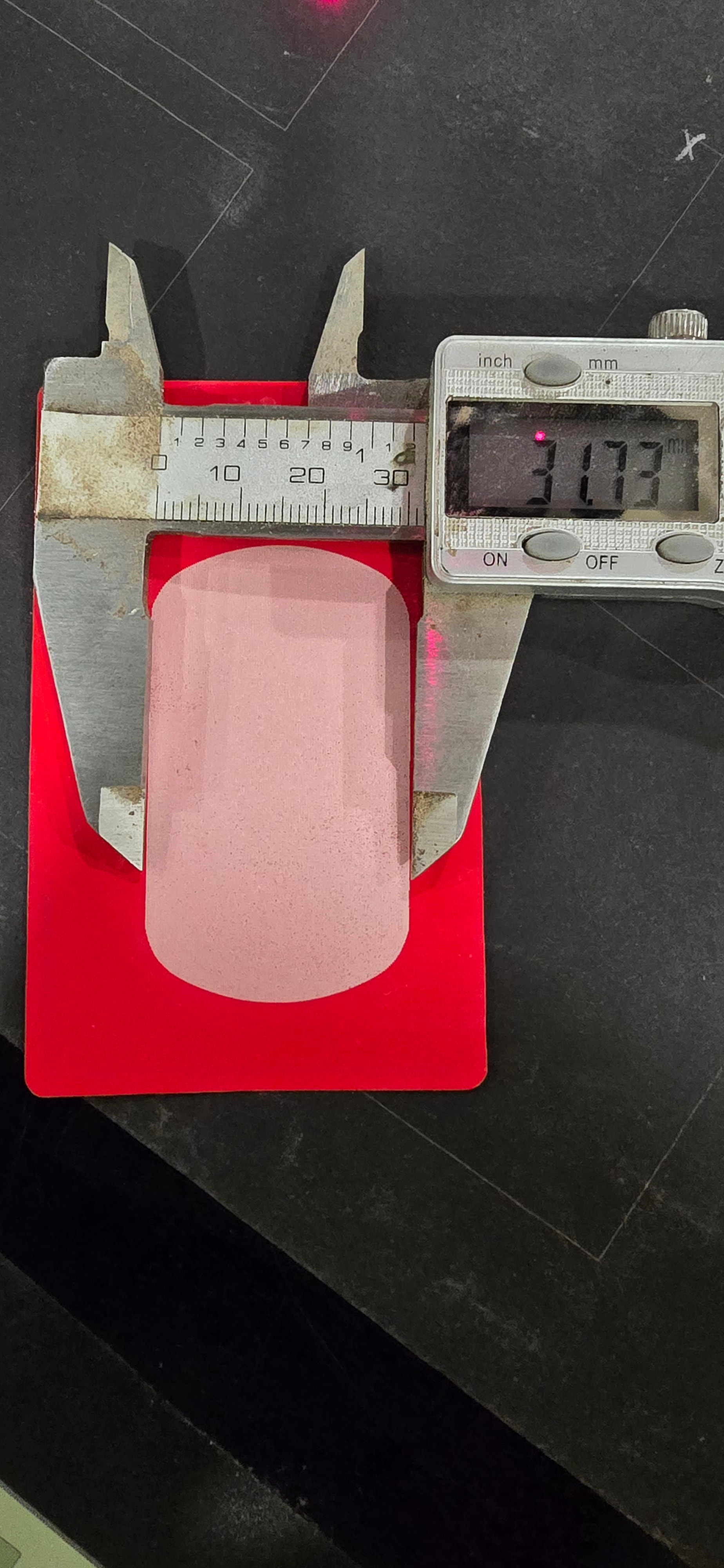

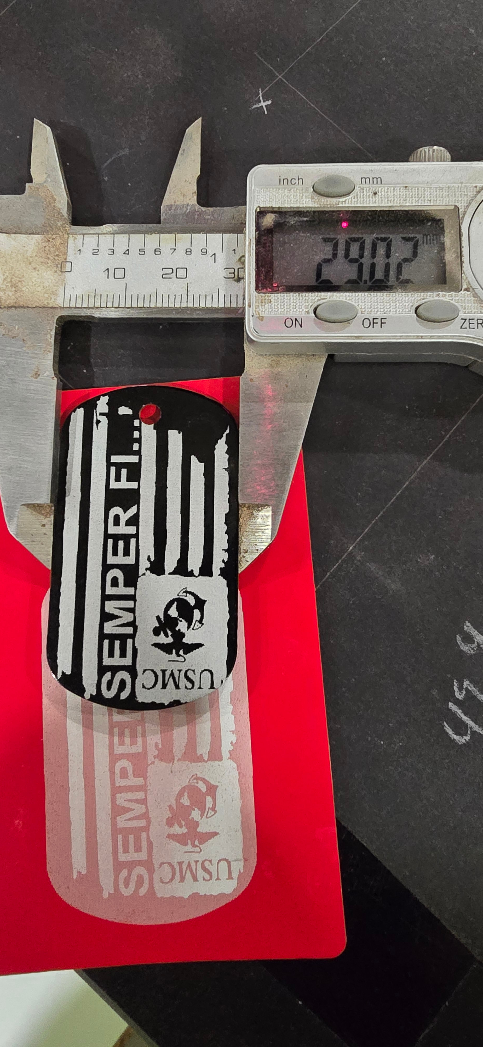

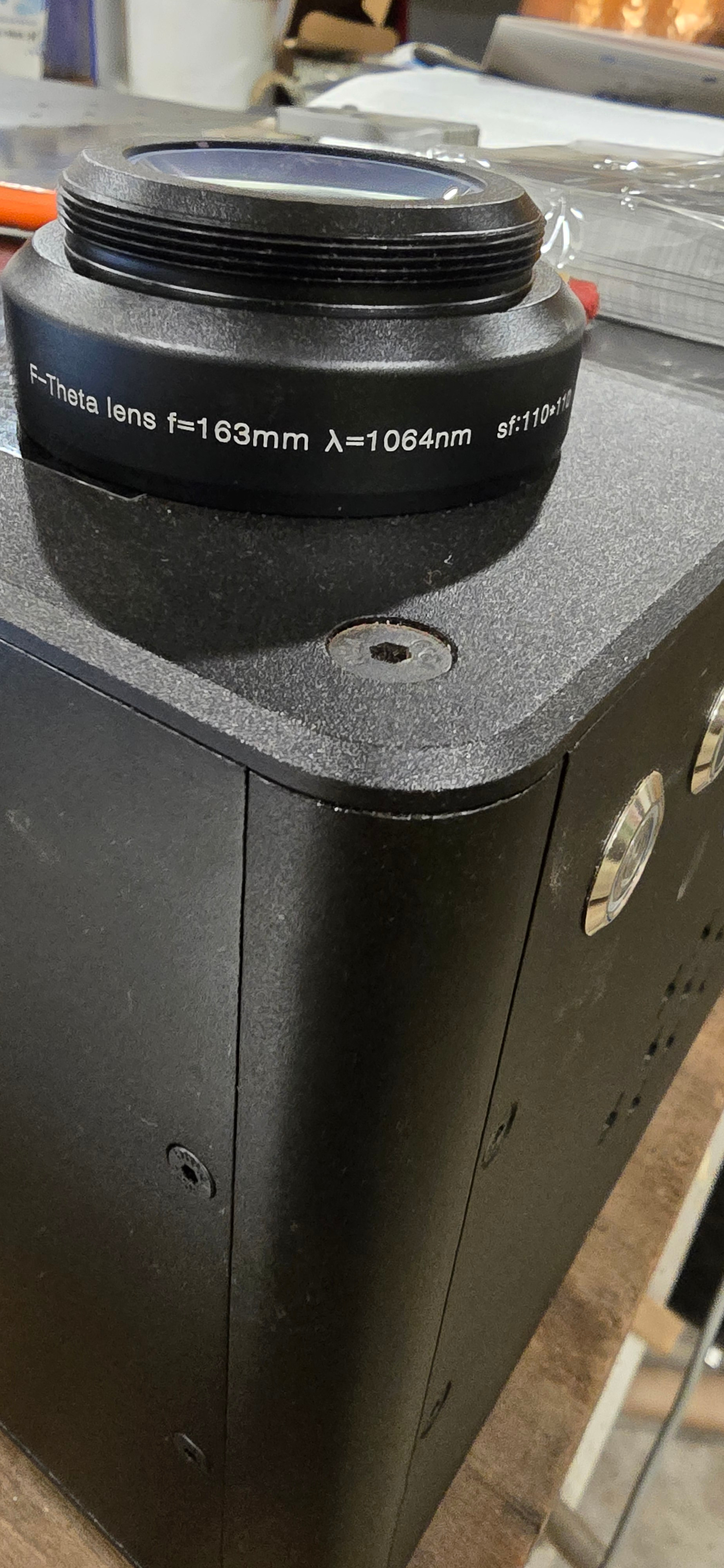

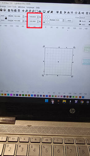

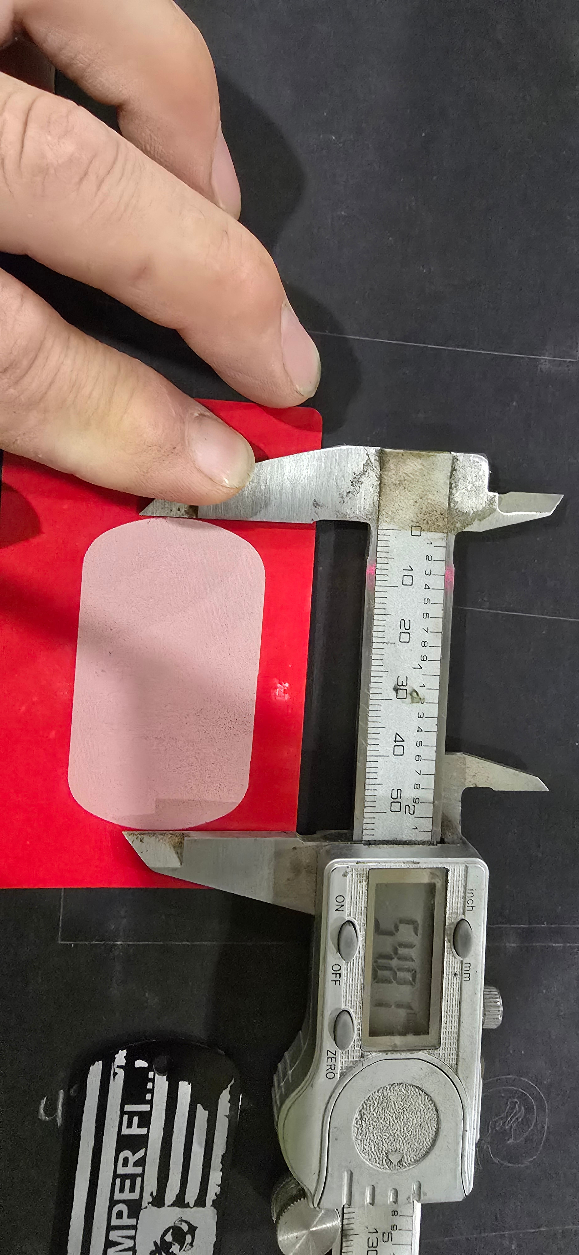

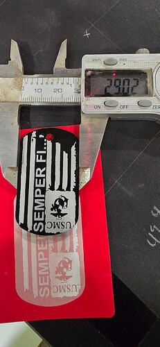

I have done the lens calibration from the video from Lightburn you tube channel and just recently did calibration galvo lens 9 point correction easy, where I tried to get a gnat butt measurement. First problem is when I do a 100mmx100mm square it tells me I have objects outside of the work area when it is perfectly centered but as I am typing this I retried that so I could type the exact message it shows and it didn’t come up, the laser started framing. When I cut the 100mm square it the square comes out to be 110mm. This also happens when I do the dog tags in the pictures, That is how this rabbit hole started. I put the actual size of the dog tag and it came out bigger than it was supposed to. I have something to do for a friend that is expensive to replace and I would like to get this thing dialed in so I don’t have to buy him another if I mess it up. I will attach some screen shots and some pictures please let me know if there is anything else I need to upload. As always I appreciate the help

This what it says on the lens F-theta lens f= 163mm ^=1064nm sf:110*110.
I was trying to achieve the 100mmx100mm because that is what the manufacture said that is this lens working area, I have another lens that comarker say it will do a 200mmx200mm but I haven messed with that one much other than to calibrate it. I am new to the fiber side of lasers.
With that lens you should be able to do 100x100mm. You will be within 10% of the maximum, not sure how that would affect the image. Sometimes when you get near the maximum you have less than stellar results.

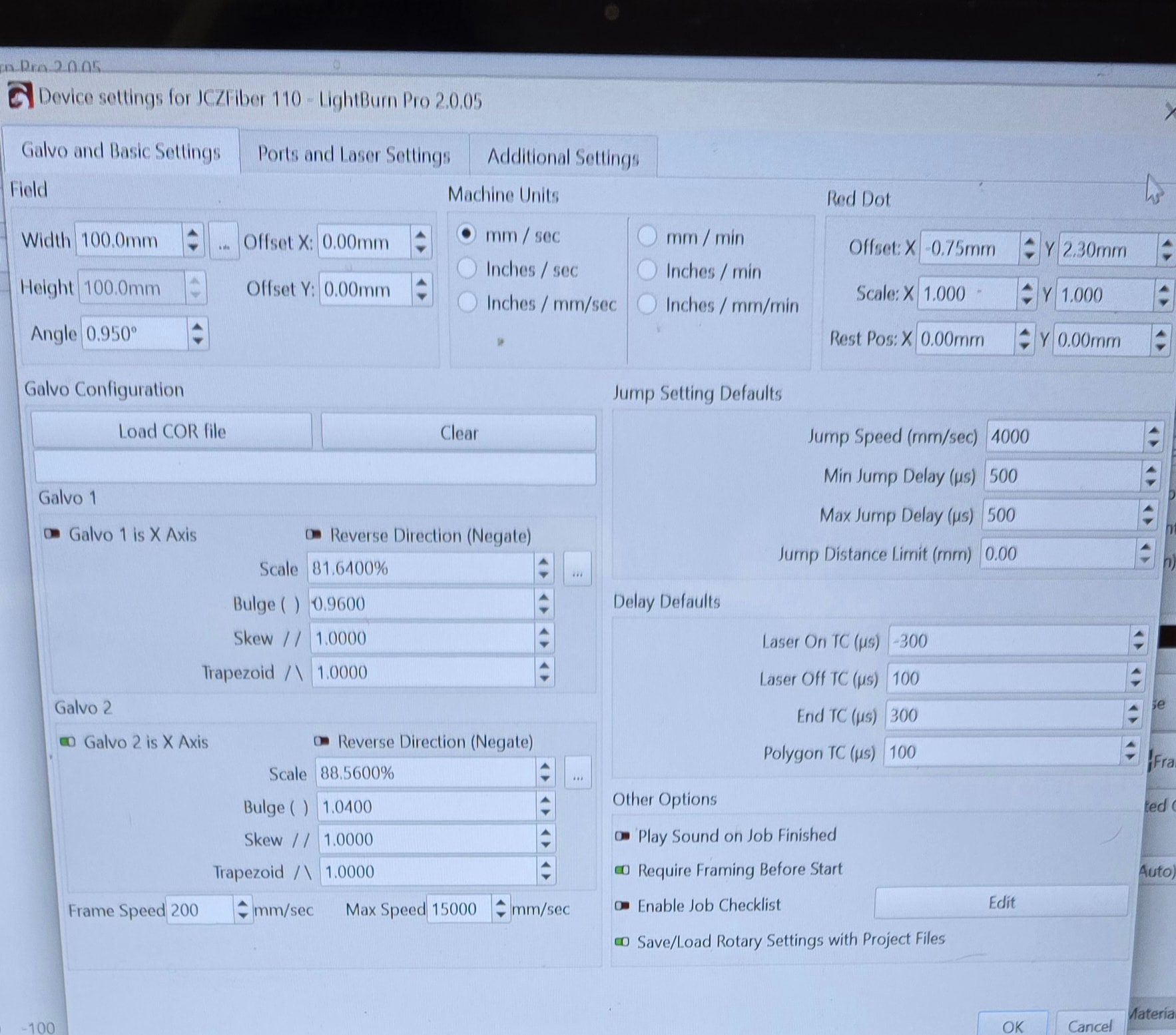

Did you import the configuration file from the vendor when you created it? I assume you did. There should be a different one for each lens.
I did import the file for both lenses and then went through the calibration process on the video because a square wasn’t a square, it had bends and bows to it. I got that dialed in pretty close. I do the aluminum business cards and recently found these dog tags, (typically GC’s superintendents and contractors on job sites don’t just throw them on the ground after they read them yes that happens, it is a rude, cut throat world out here in the trades Lol) I don’t run the file as a image (I haven’t figured out how to cross hatch on a image yet and I get a cleaner finished product with the cross hatch) and the other side is simple text, I didn’t want to upload that side because it has my email and phone number on it and I get more than enough spam calls and emails as it is
My real question was, why is the laser burning bigger than the value I put in, when I was typing the title I was trying to get all relevant information of the laser in and was supposed to put my biggest concern but the dog distracted me and I probably got 5 phone calls and some how skipped right to the description and forgot to circle back to finish the title of the thread. When you (Jack )replied I saw that I messed that part up. I am not real concerned if I get less than a 100mm let’s call that a problem for another day lol. For now can anyone tell me why the laser is burning bigger than what I put in?

There was some scaling applied to get rid of the bows in the square, I wonder if I need to apply the same sc
ale to the the box in this picture, I don’t know enough about this stuff, but I could try that when I get home from work hopefully there is a more permanent solution so I don’t have to go in a nd change that everytime

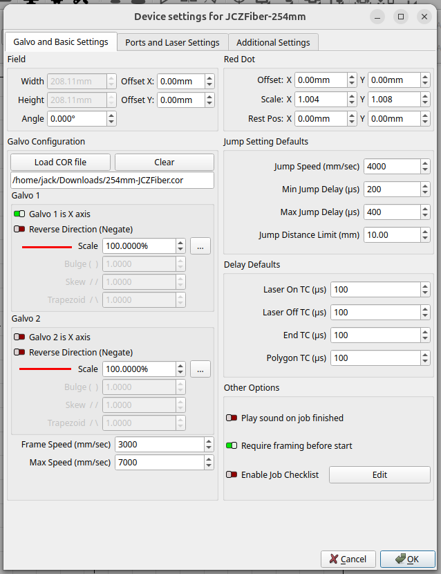

After the 9 point correction did you run the scale utility?
It looks like the lens is F163, not 63 Also if the lens says 110x110, that is the working area for sure, regardless of what the manufacturer says. Is that what you entered into the set-up?

Like I said I might have missed it but I think you need to run 9 point, then run scale.

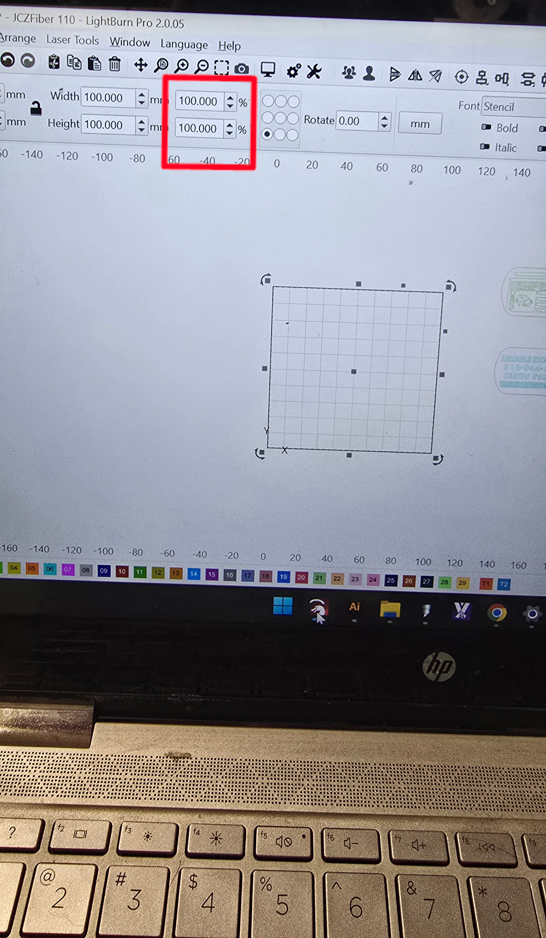

The 4th picture in my initial post is what ended up with after following the procedure in this video https://www.youtube.com/watch?v=x08cRPkyToc&list=PLwL4iB6JZSDzjF11U_DSOaxYsIeLp3-f3&index=11

I did the 9 point but I don’t recall anything about scale but it did change the scale in the 4th picture from what is was after doing the steps in the video but I really was going for close enough, but after I noticed that things were not coming out the correct size I reran the 9 point and was really trying to get it as close as possible
After running 9 point engrave a square and measure. Enter the result and desired size 3 dots is the scale utility. Fix you right up I bet.

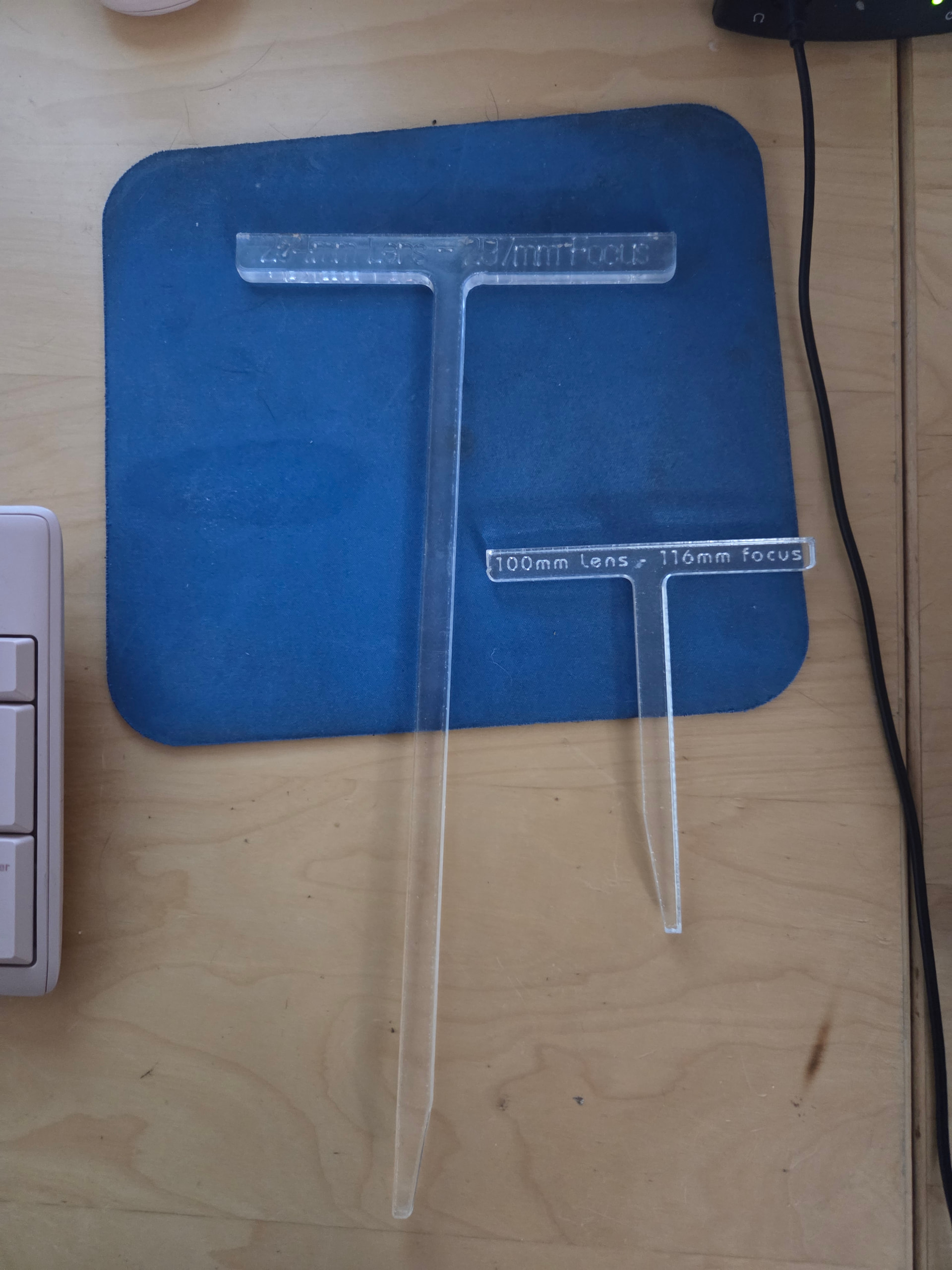

Focusing is really important, check it by raising/ lowering while continuously firing and listen for the loudest burn. adjust your red dots to that point. Problem is when you change lenses the red dots are way off. Cut a stick for each lens. Then set scale. Never trust factory.

I followed Laser Everything video on setup a new fiber.. they show a T shaped tool.. These are a couple of mine.
I would follow @Albroswift suggestion, focus it yourself.
I started with the focusing lasers but with 3 lenses wast of time like you say, and even when dialed in didn’t seem very accurate. Then went to focusing sticks, way better, industry standard. Then to DRO, now CNC.

I ran the 9 point and solved the problem with the requested size vs measured size, I didn’t go in to that little box the last time I did it and I am not sure if I did it as a part of the process in the video. Thank you for all your help on this
