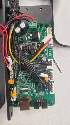

Replacing a bad Comgrow 10w laser module that has a total of 4 pins. 2 separate 2 pin connectors

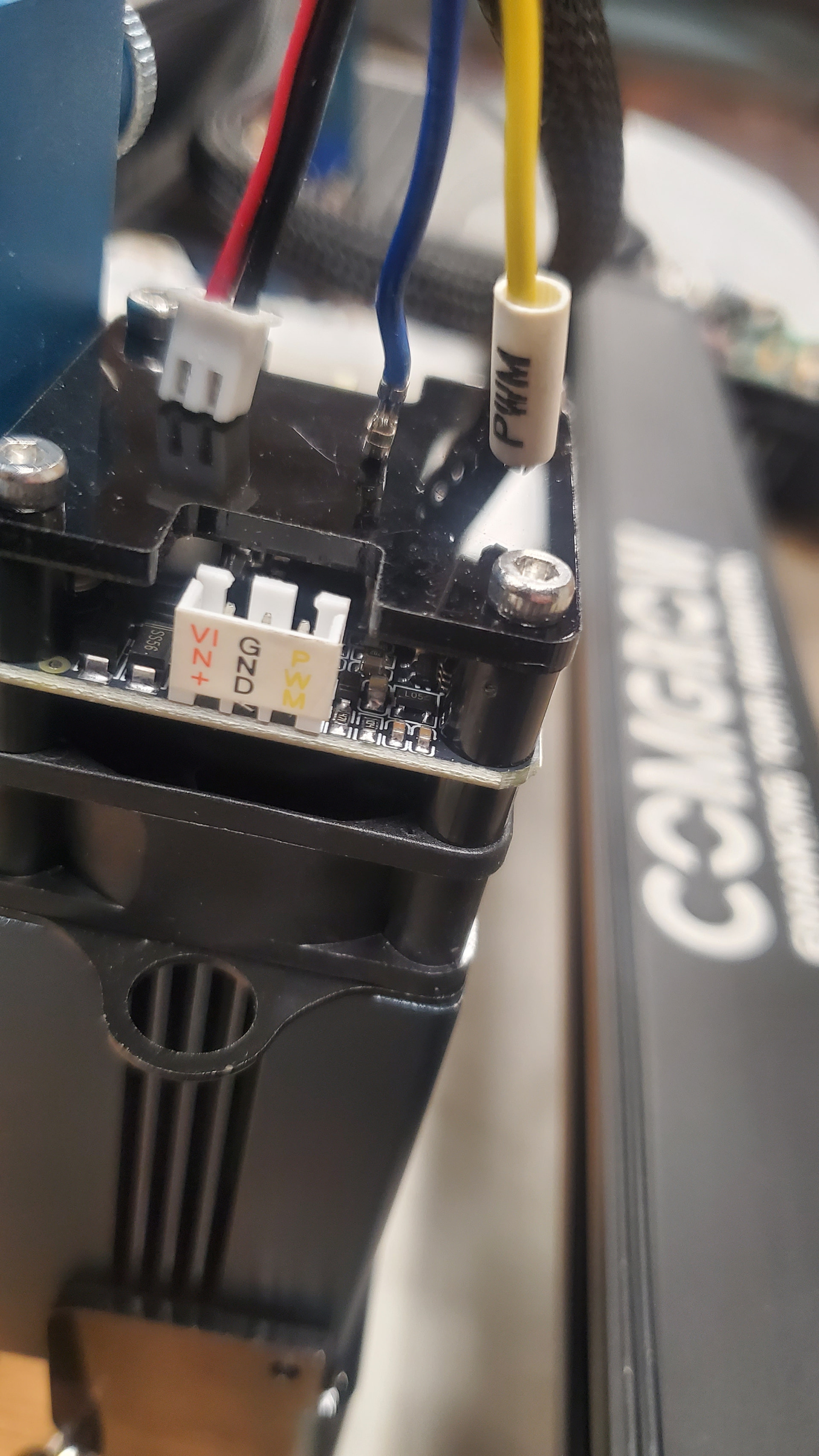

One black and red, the other yellow and blue. The new laser module is a Aenbuslm 10w and has a 3 pin connector. Any help on how to wire it without messing anything up. Thanks in advance.
PWM to PWM, VCO to VIN+, GND to GND, GND can be ganged together or just use either one.
Disclaimer: I’m not an electronics technician, but. I did change a light bulb once. Use m advice at your own discretion.

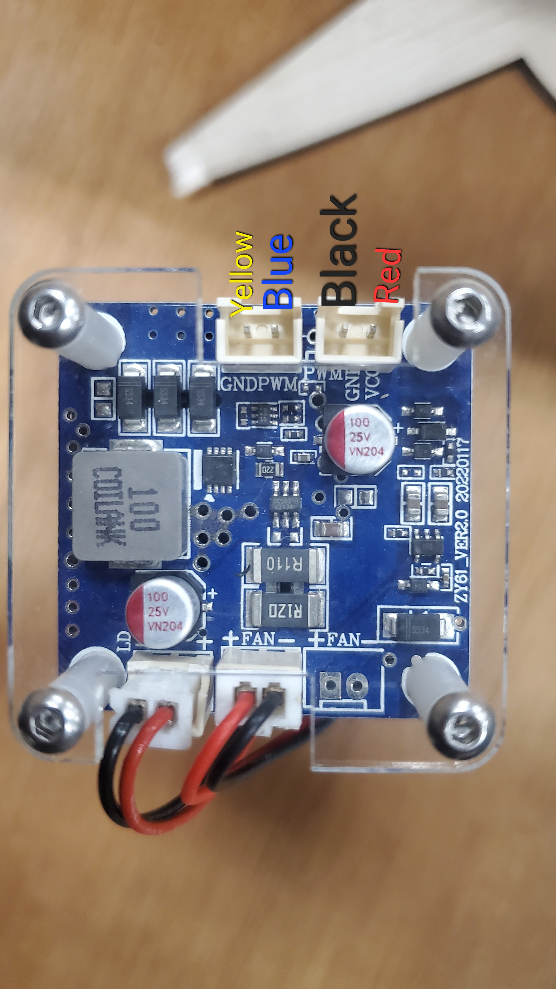

This is how the original came off.
@thelmuth is correct. The yellow and Black wires are GND wires and can be tied together. Be sure you connect the wires to the correct pin on the new board.
Red = Vcc
Yel/Blk =GND
Blu = PWM
The new board should have the pins clearly (?) marked.
