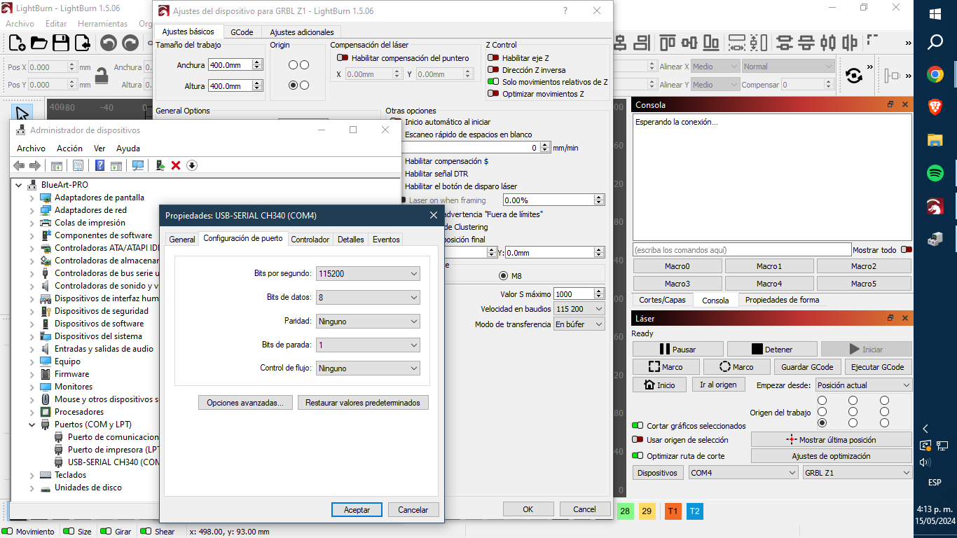

good day. A couple of days ago I bought a Comgrow Z1 machine, which I performed tests and turned off, everything was very normal; but the next day I find this same surprise that it does not connect to the PC. I have tried disconnecting and reconnecting the parts, updating the firmware… all with no results. I do not know what to do. I’m going to try changing the board for an Arduino to save the parts.

The machine turns on normally, including LEDs and the laser module diffuser. In the device manager you connect and the assigned COM appears. I have tried changing the baud on the computer and software equally without results. I have also checked wiring and connections, everything is ok.
It keeps showing that it is waiting for the connection…
It looks like you’re connecting on the right port (com 4), and with the right driver (ch340), and at the right connection speed (115200).
