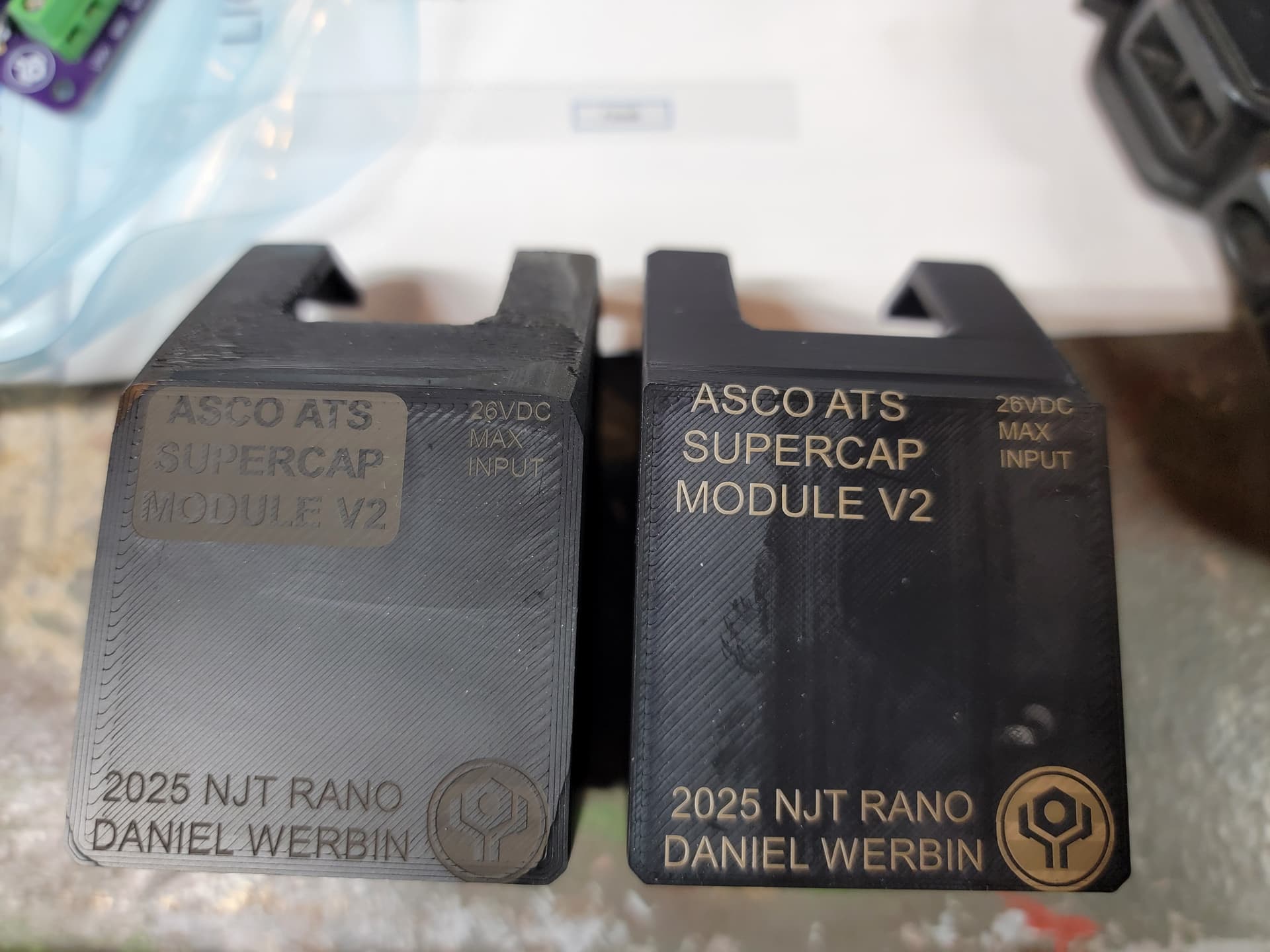

See attached image for an example, on the wrench logo, see how the marking density changes depending on if it has to sweep the text? And the one on the left, it’s very dark because of the rectangle fill on the top left corner (out of frame of the shot) somehow slowed the ENTIRE job down. I have used lightburn’s tracing tool to trace the images involved, so everything is on the same fill layer. There is not a separate image layer.

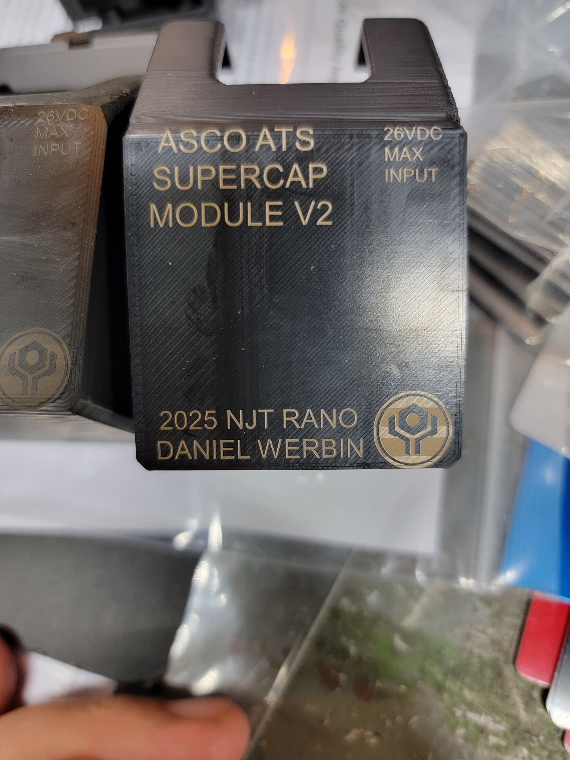

Also, that doesn’t explain the total job slowdown by more image data being at the top. See this image, same settings, the only difference is the rectangle. But it took almost twice as long to burn the one on the left, which over-burned the plastic. How could the rectangle cause the entire job to change?

You can clearly see in the areas the laser scanned the text and the areas it did not.
So the laser spent less time moving across the areas between and you can see that effect in the logo.

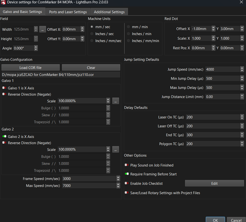

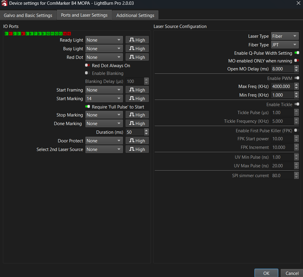

It may be worth taking a look at your galvo settings,
Can you show us the Galvo and basic Settings" ?
Maybe also attach your lbrn2 save file so we can see your layer settings

laser debug testing.lbrn2 (93.9 KB)

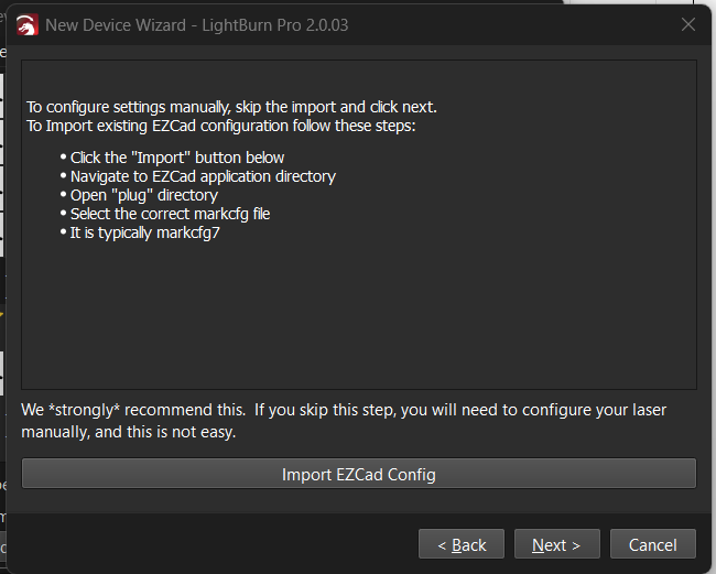

Did you also import the markcfg7 file during the device setup ?
It looks like you may be using some default settings.
Try creating a new device profile, but this time use “Import EZCad Config”, and select the markcfg7 config file. Provided to you with the machine.
I did as you said and the settings are the same, I believe I did this last time too. Same issue still happening. Do you have access to a fiber laser to try my file on and see if it has the same issues?
