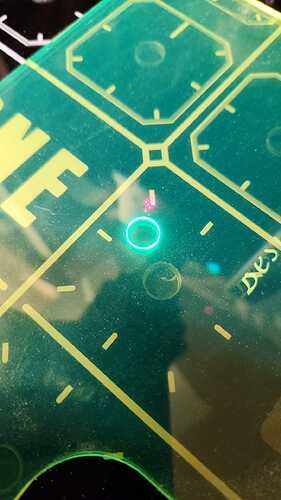

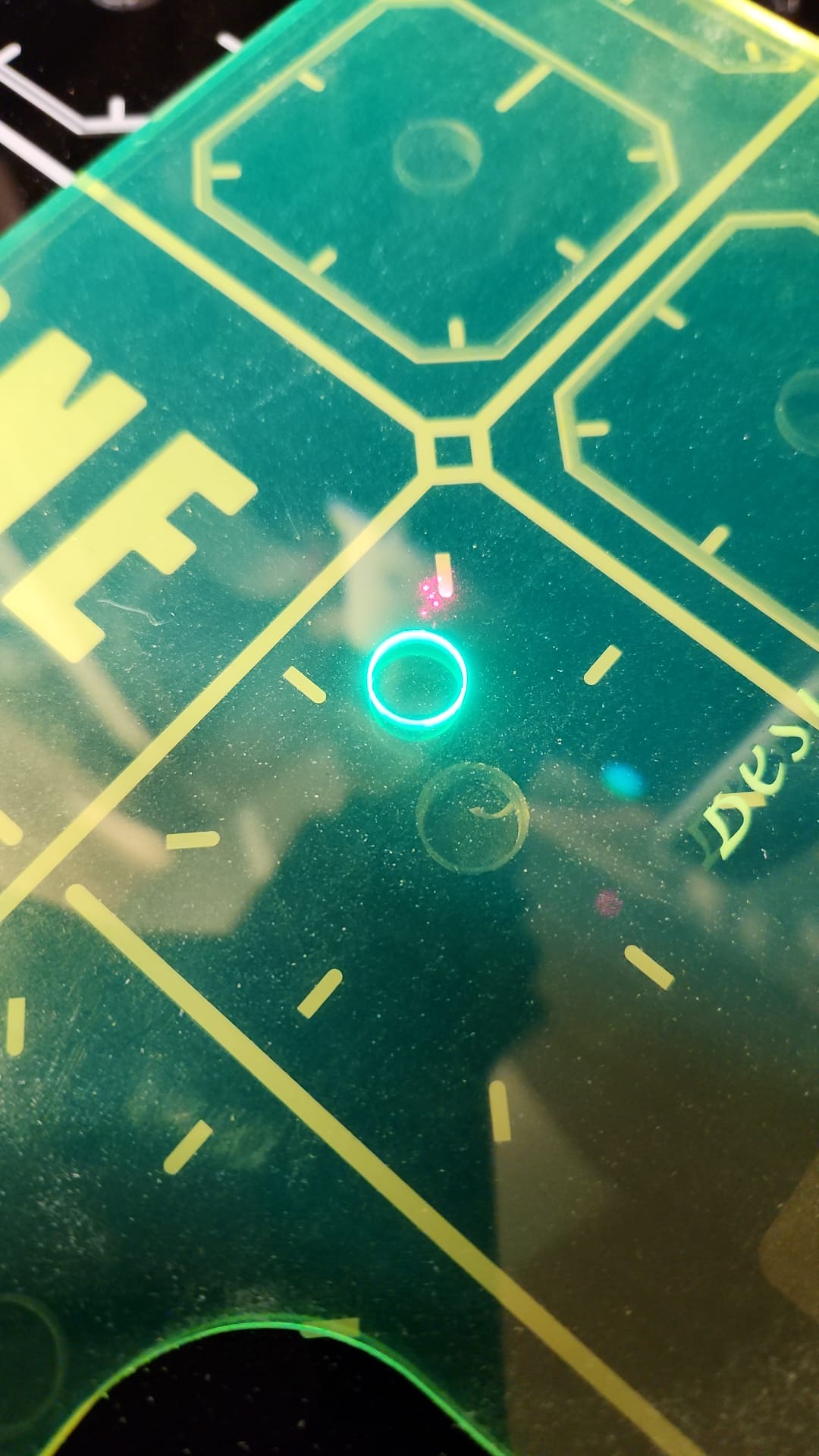

no, there is no red light on the omni1, that is why they give you that yellow fluorescent acrylic part to help visualize the UV beam
I can see this “Preview Helper” in the manual now, but no information on how to use it.
just place it on top of the object to engrave… the UV beam will be visible and very bright.
not supereasy to align the job, but… that’s how it is.
another way is to paint the object with a fluorescent marker
