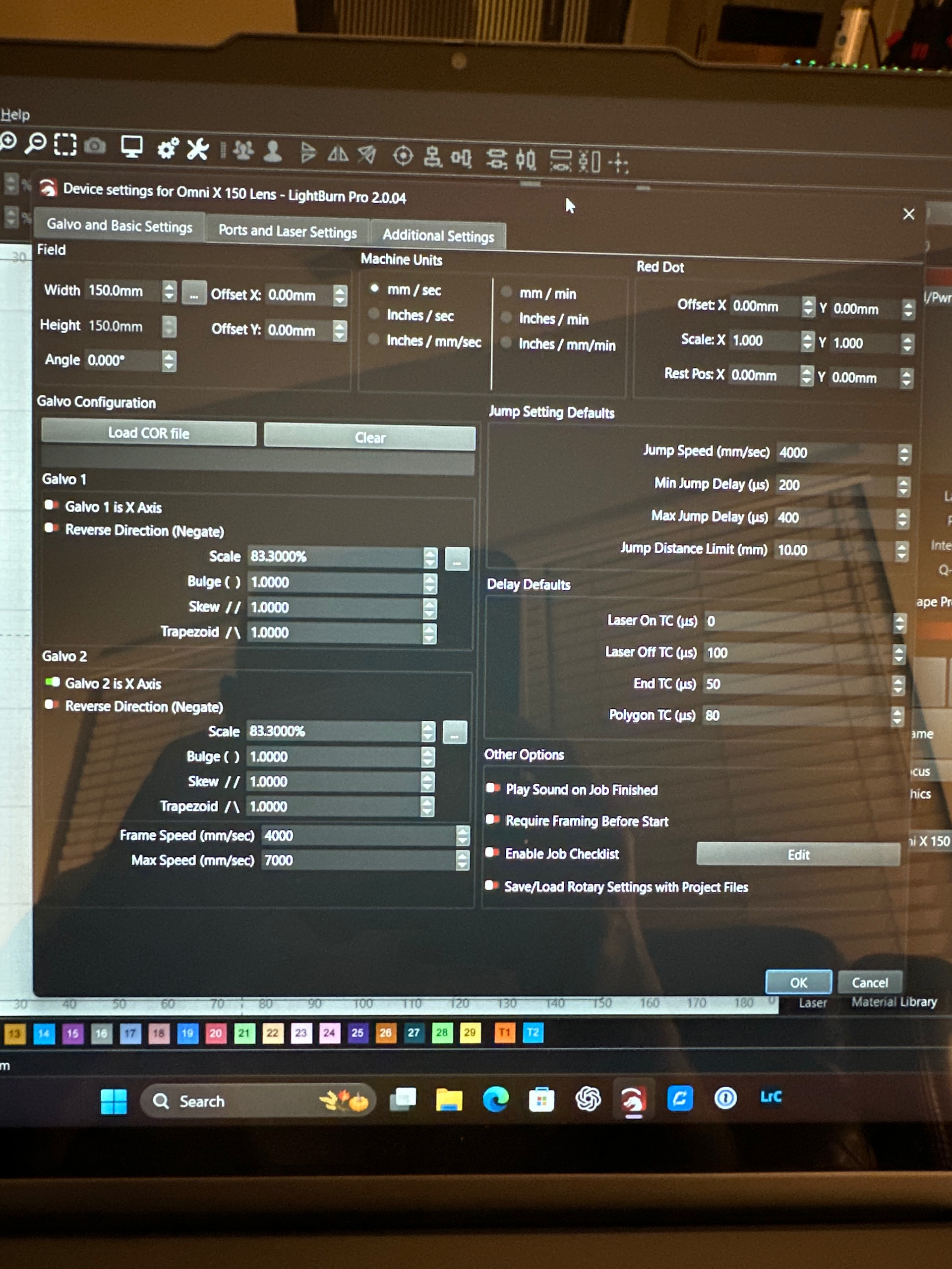

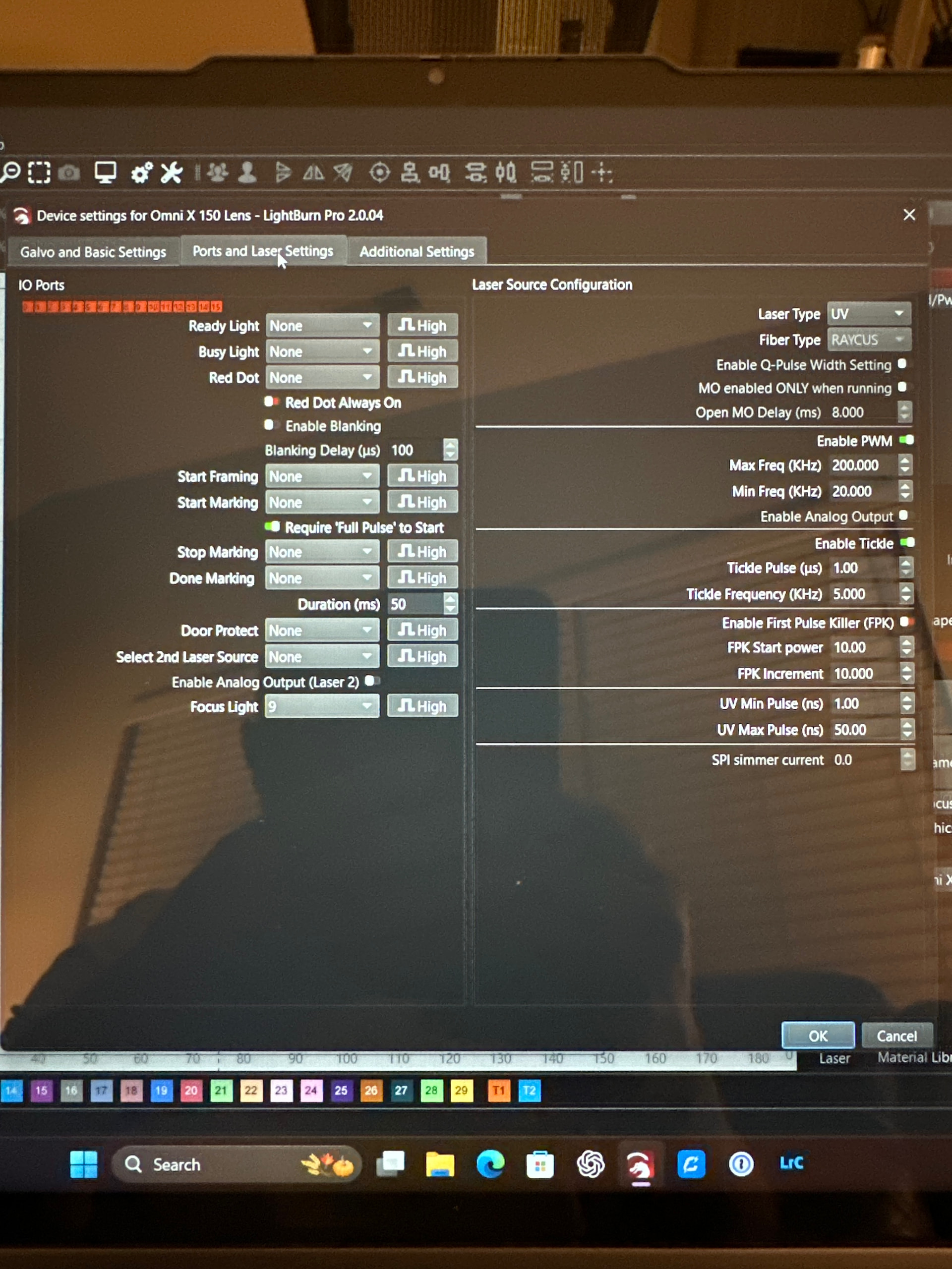

On my Commarker Omni X, I am unable to burn anything within Lightburn 2.0.0.4. Using the Commarker Studio software, I am successfuly burning aluminum business cards, so I believe communication between the PC and laser is fine along with focus is correct for the media being used. It takes around 30 seconds to burn one of these cards.
What is working:
-Omni X does Frame
-There is a red dot
-Lightburn shows laser as “ready”
-Adjusting settings do seem to update to the laser
-Laser Device is listed as BSL Fiber | Galvo
What isn’t working:
  • When you press start, the progress bar does go up to 100% in about 7 seconds.
  • Doesn’t burn or act like it is even attempting to burn.
Is there a firmware update to the OmniX that addresses this issue?
Is there a confirmed version that works with the OmniX?
  • I’ve tried, 1.6.3, 2.0.0.2, 2.0.0.4, RC2.0.0.5
Any help is appreciated.
Curious how your settings compare to mine. Also when you do a preview what does it look like there? I’m new to this software and that feature is priceless to see what it thinks it will look like.
