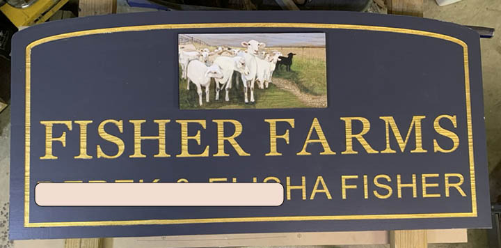

I am including a photo of one of the signs with personal names blanked out. Folks did not wish to have their names advertised.
I engraved with two passes into 1 1/2" solid Poplar material measuring 23 1/2" in height X 45" long. They are primed with three coats of white primer, three coats of dark finish, three coats of gold on the cutouts, plus three coats of waterproof clear coat. Many hours/days of allowing each application to dry properly. The graphic is 3/8" x 7 1/4" x 14" poplar engraved then artistically painted by my artistic wife. Since the folks the signs are for won’t be home until last of March we will have them hung in our wood shop.
