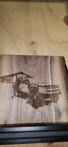

Complete beginner, any advice on how to get better quality on this engraving?
Hello. This is my first time posting or using this forum so hopefully everything is formated correctly and in the right place.
I’m looking for advice on the best way to engrave this image
with the highest quality possible. I’m using an Ortur Laser Master 2 20w and engraving onto black walnut.

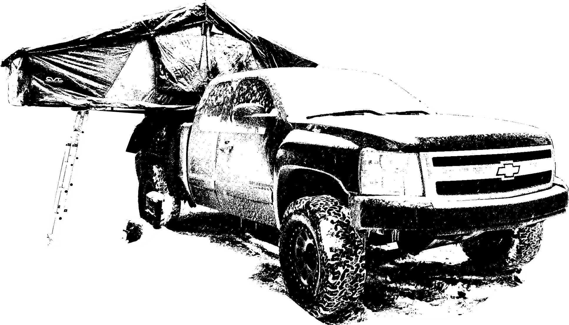

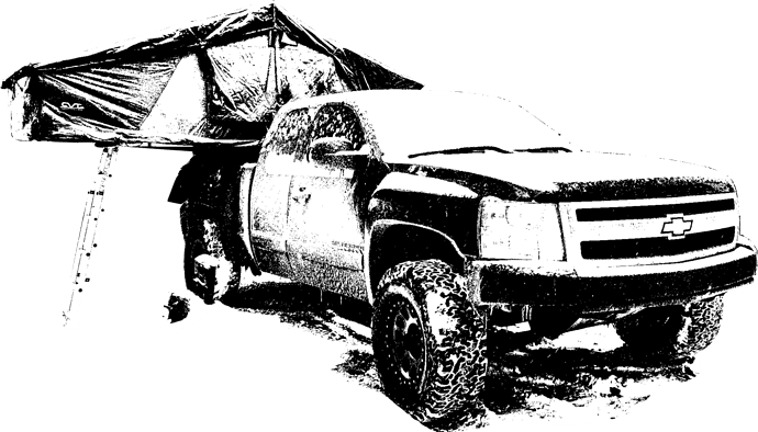

This was my result after I converted my original image into a tracing off a website, then used LightBurn’s image trace feature on that.
I used 4 layers: the first 2 were Fill at 4000 speed, 62.5% power with 45° and -45° angles respectively. The 3rd layer was Line with 800 speed and 15% power. The 4th was Fill at 5000 speed and 50% power running horizontally. I’m told my whites didn’t engrave and my darks lack any midtone because my image had too high contrast.
I do agree that the engraving is not very dark and easily blends into the dark walnut, but if I up the power or lower the speed the engraving burns really deep but doesn’t end up much darker. If anyone has advice on how to process the image to get a better result or any tweaks to my settings I’d love to hear. Thank you!
