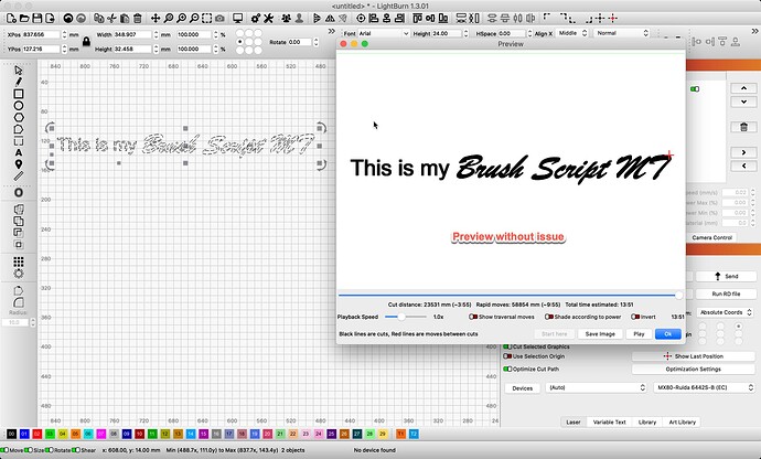

Which version of LightBurn on which OS? Below I show a current beta and our current public release. I typed this text, then aligned for presentation and hit ‘Preview’.
