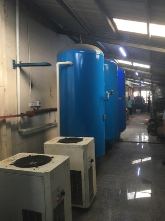

Or you can install an after cooler and a small refrigerated air dryer between your pump and tank (thus creating what is referred to as a dry storage receiver).
This is how I have my air compressor designed.
At a minimum, adding an after cooler alone (a fairly easy modification), will drop a significant amount of moisture from the compressed air.
