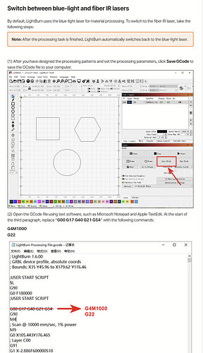

I followed xTool’s official instructions on how to use the F1 ultra with LightBurn , and their provided .LBDEV device profile does not include any option to change the laser source.

Upon further inspection, they actually have instructions for changing the laser source further down on the page I linked previously.
The instructions are quite wild, and there might be an easier way to implement this with our Custom GCode device profile .

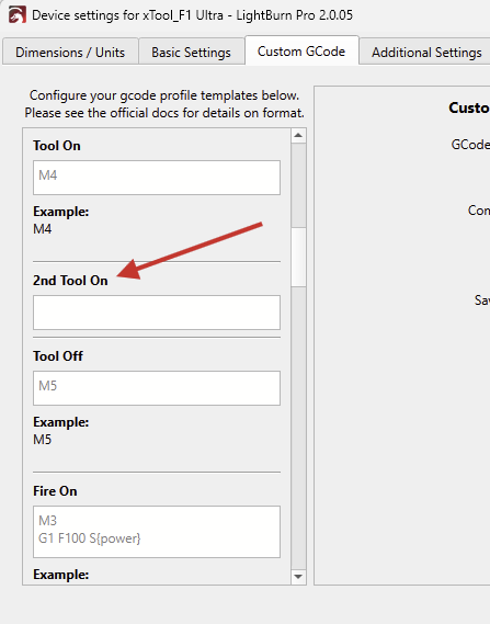

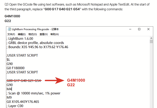

The docs page offers some explanations about the Custom GCode options.
You would need to enter the command to change to the other laser source in this field in the Device Settings:

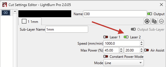

If there is any code in the “2nd Tool On” field, it will unlock the “Laser 2” option in the Cut Settings:
xTool’s instructions tell us to edit the file GCode file like this:
This first line G00 G17 G40 G21 G54 is needed in LightBurn, and removing this from the GCode might lead to odd problems.
We require xTool’s cooperation on how exactly the firmware behaves, and what their G4M100 G22 is doing.

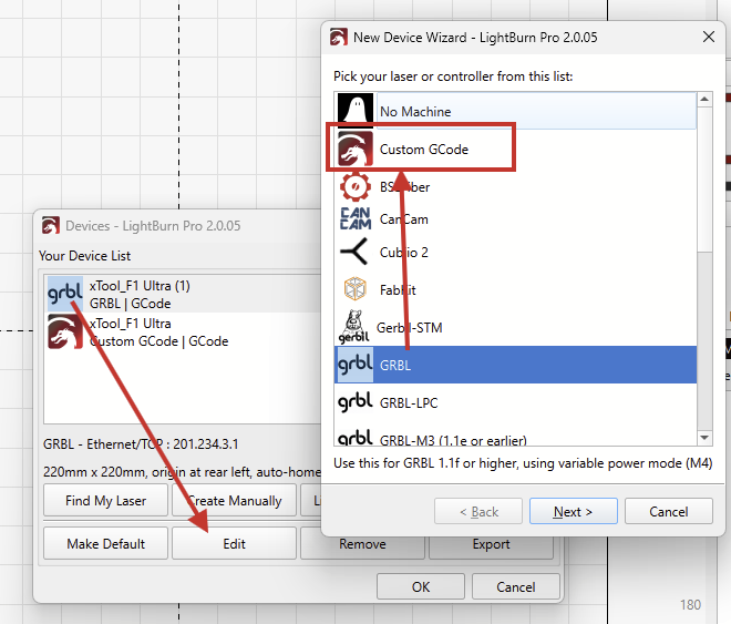

Okay..
..I imported xTool’s .lbdev device profile and changed the device type from “GRBL” to Custom GCode:
Then, in the Device Settings, entered their Start Gcode, End GCode, and 2nd Tool On
Then, generated these two GCode files using this new device profile. Once with laser 1 activated, and once with laser 2.
The only difference is the additional G4M1000 G22 for the Laser 2.
The G00 G17 G40 G21 G54 is still included. I didn’t find a way to remove this without opening a text editor. As mentioned, LightBurn relies on some of these commands.

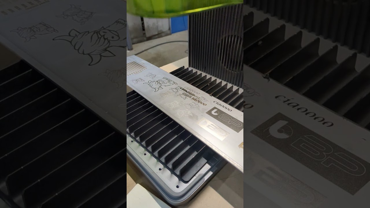

Stewy
(Stewy)
December 10, 2025, 6:31pm
13

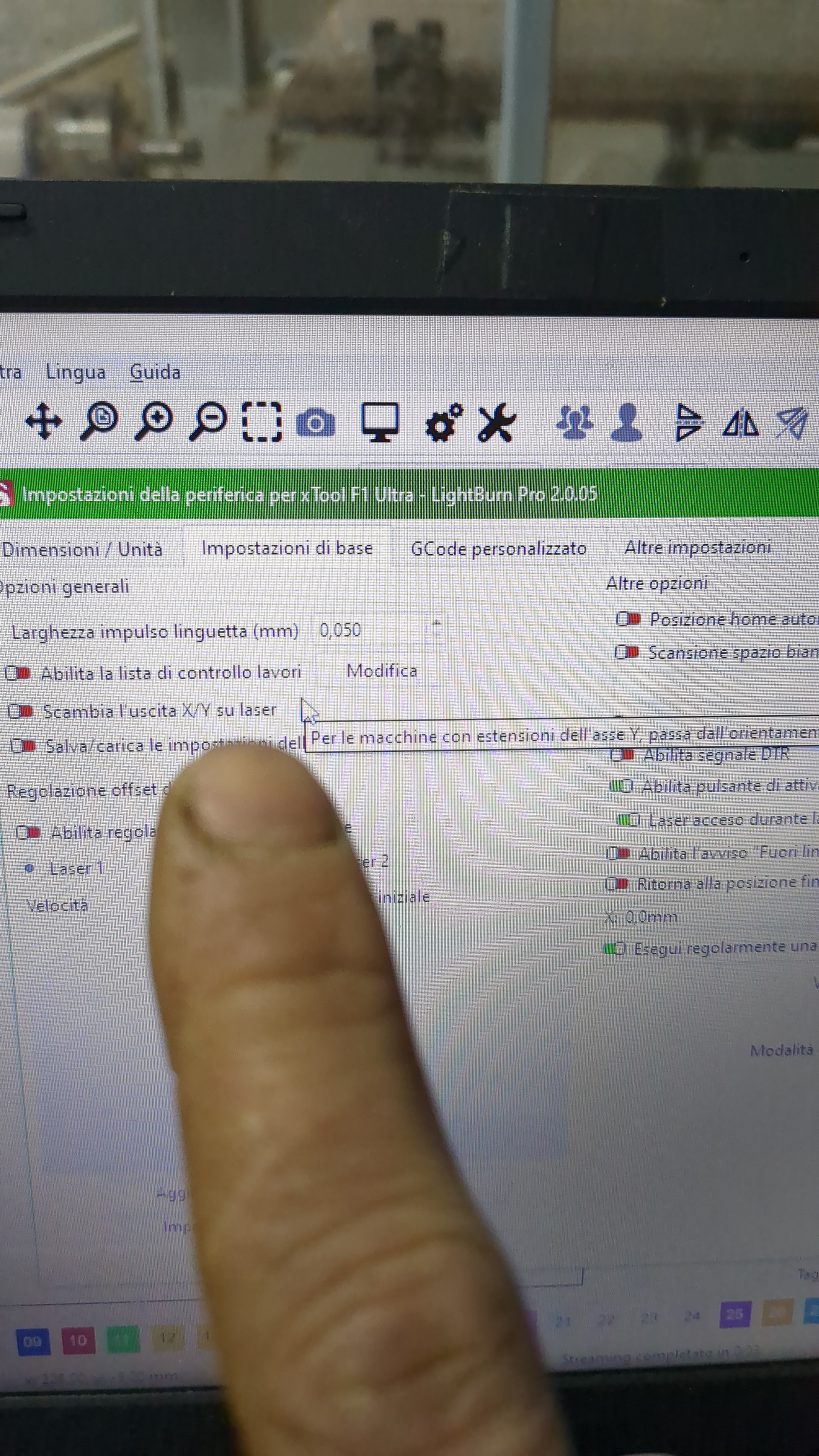

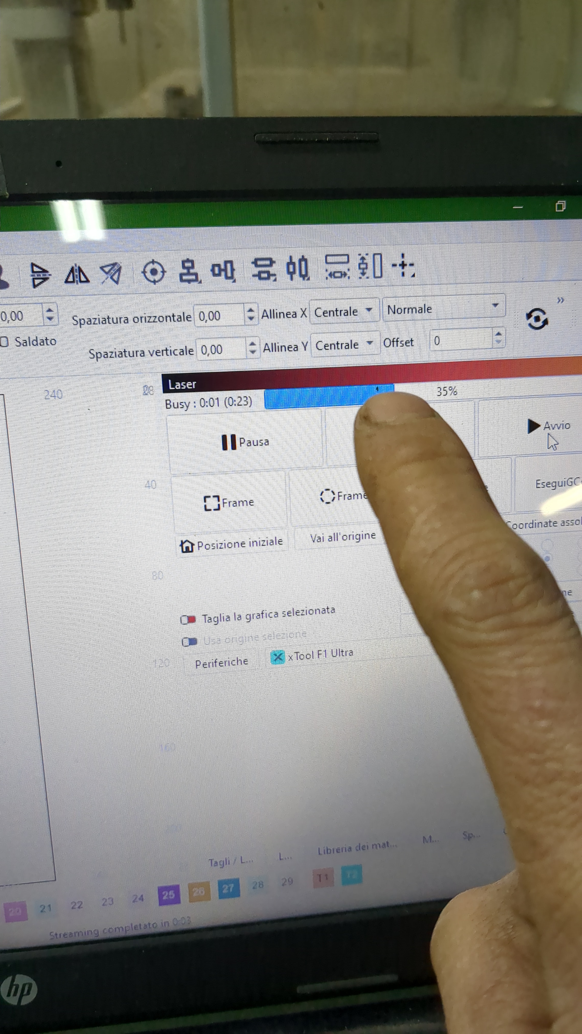

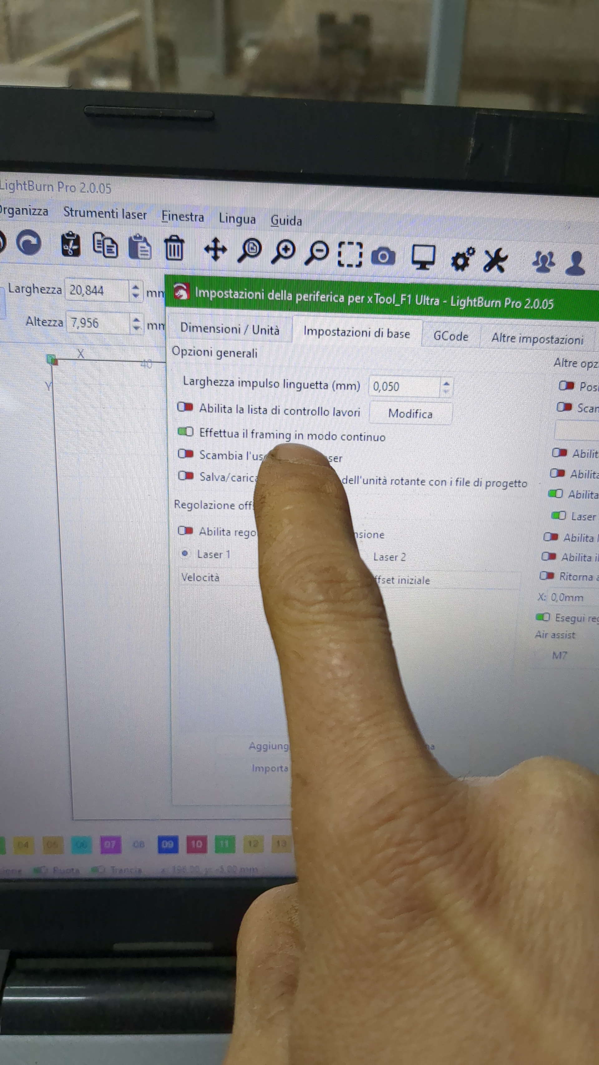

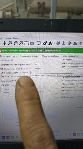

It works. However, I have a couple of things to point out: 1. If you enable laser 1, it processes with the fiber and then automatically switches back to blue light. If you activate laser 2, it works continuously with the fiber. If you deactivate both flags, it works with diode. 2. There is no longer the option to set the frame to continuous. 3. During processing, the busy signal of the work time control disappears after a few seconds.
Stewy
(Stewy)
December 10, 2025, 6:36pm
14
If you tell me how to do it, I can attach a video I made where it shows these problems. For now, I’m attaching photos.

Aaron.F
(Aaron)
December 11, 2025, 3:32pm
18
Stewy:
Stewy, I’m lost here. I don’t own this machine, and without xTool’s collaboration, I have no idea what they are doing with these custom commands.
Aaron.F
(Aaron)
December 11, 2025, 3:35pm
19
This is a shortcoming of the Custom GCode device type. I’ve logged it internally to add Frame Continous to the Custom GCode device type.
