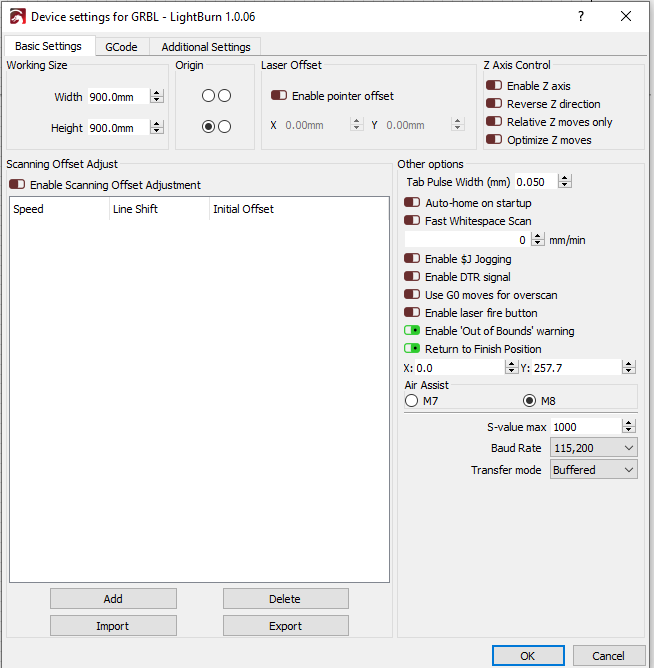

Also, is there a reason why you’ve set “Return to Finish Position” as 0,257.7 in Device Settings?
No, there is no reason why that is set, i’ve set it to 0

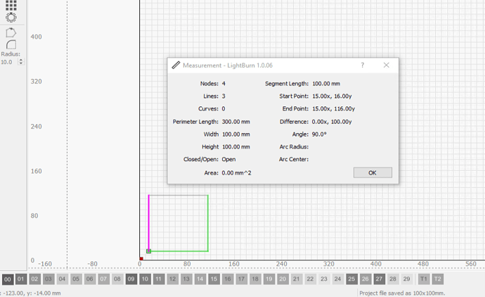

in the picture below i have made a box of 100mmx100m in DXF format and in Laser GRBL it burns a perfect square of 100mmx100mm but in lightburn it makes a quare box of 26mmx26mm:

Can you attach both the DXF file that you used and the LightBurn .lbrn file that you created to do this please?
You may need to change DXF extension to TXT in order to upload.
100x100mm.lbrn2.txt (4.8 KB)
Can you save the gcode for this in laserGRBL and LightBurn and post both files here?
incscape100x100mm_0001.gcode.txt (498 Bytes)
Lightburn100x100mm.gc.txt (287 Bytes)

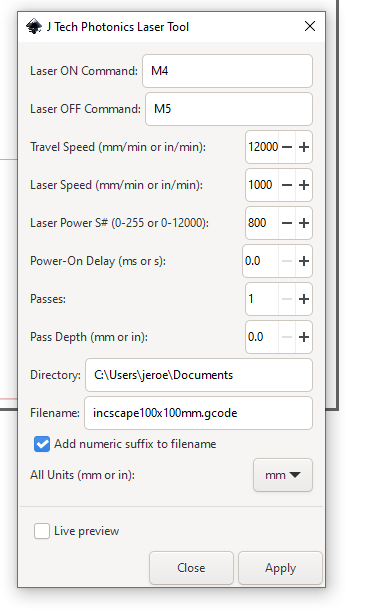

i create it with incscape plugin
I’m confused now. How exactly are you doing this?
Can you walk through your workflow exactly please? For both LightBurn and LaserGRBL.

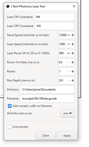

draw a box of 100mmx100mm and select the plugin :
you will get the box in the picture :
and press apply
you can get the plugin at this URL: https://jtechphotonics.com/?page_id=2012

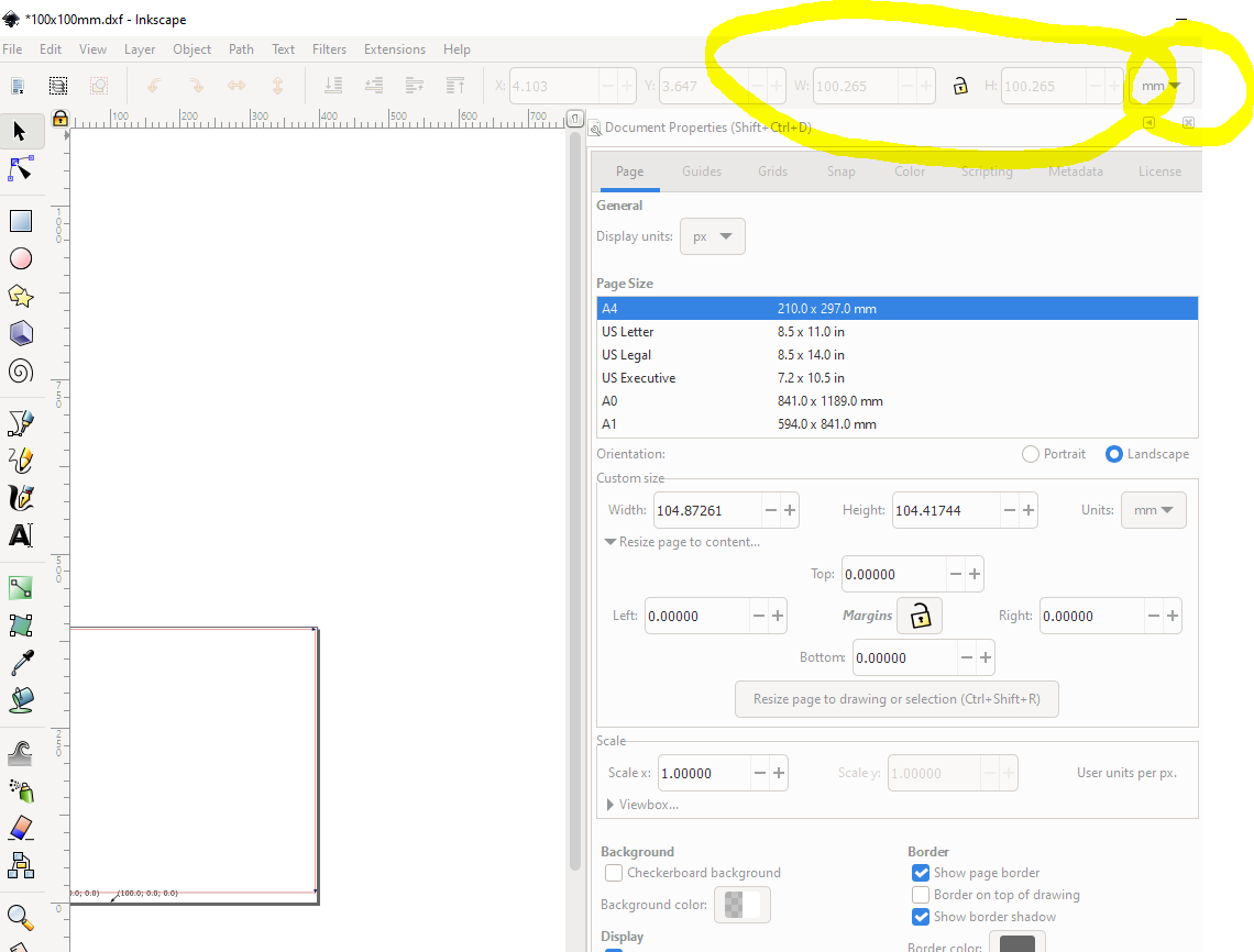

I’m looking at your screenshot in Inkscape and even there I can see that the dimensions are 378.953x378.953mm.
That are units in PX not in mm
Switch display to mm and check please. Either way, it’s exporting as 378 mm.
the extra.2mm is compensating laser cut
