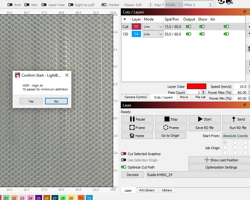

Pressing the Start button is triggering this “Confirm Start” message.
Layers are set to 1 pass and are not configured from the materials library for MDF.
Did you define a user checklist in Edit > Device Settings? That is what this looks like.
Thanks, Oz,
That’s exactly what it is. I was playing around with the checklist feature yesterday and forgot to delete the entry.
