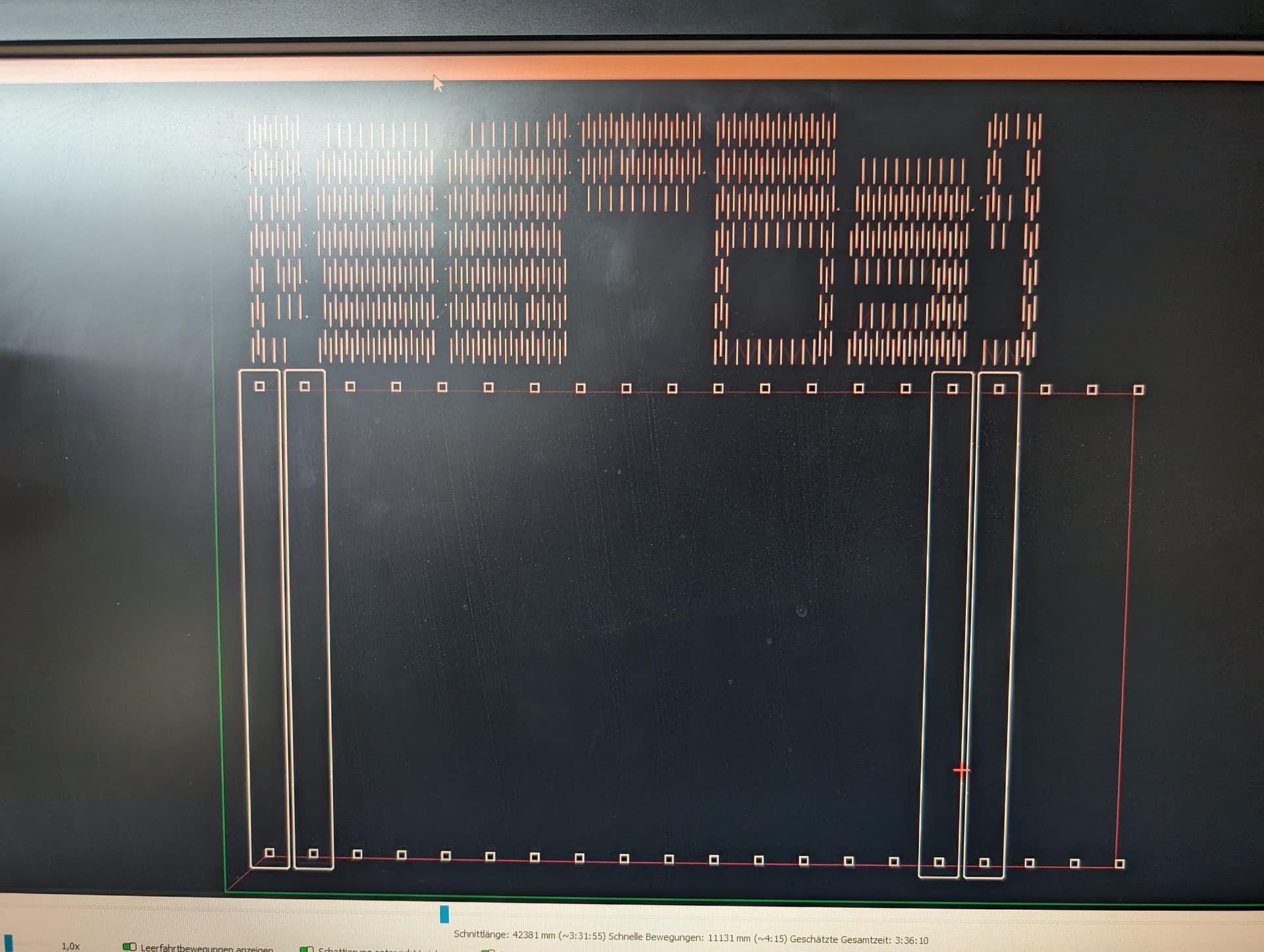

Why does Lightburn create such confusing programs or such a strange processing of layers?
If everything was processed properly one after the other, it would save time.
Is there a way to set this somewhere?

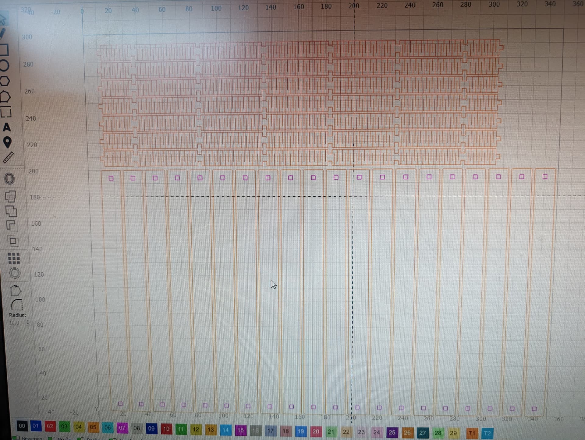

Hello,
I have already made a few attempts with this, unfortunately without any significant success.
The confusing processing is only internal to the layer (in my case orange).
If there are several layers, then they are processed one after the other.
But each layer then shows such confusing processing.
Thanks

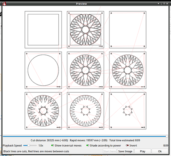

Because rapid motions (with the laser off) travel an order of magnitude (or more) faster than cutting motions, the time savings probably aren’t as large as they may appear.

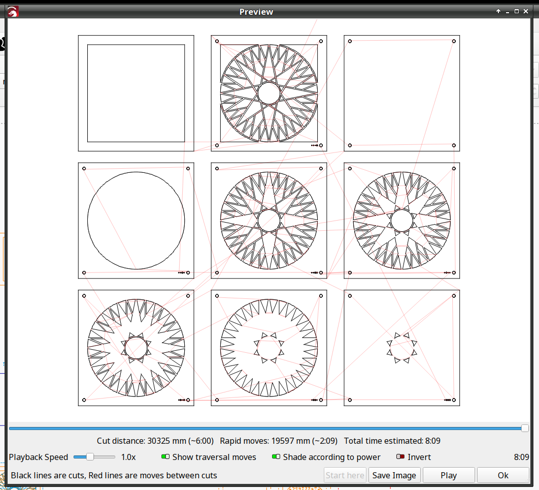

For example, this layered paper job takes eight minutes:
The red lines show the rapid moves require two minutes, a third of the six minutes of actual cutting. Many of those moves are required, so there’s not much room for optimization.

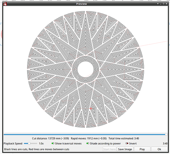

Engraving all the layers as a single pattern takes three minutes total, with the rapid moves occupying only 30 seconds:
Cutting paper with a CO₂ laser runs nearly as fast as the rapid motions between cuts, so the results on a diode laser will be even more skewed toward cutting.
Your layout is even more complex, so I’d expect the rapid moves to occupy a small fraction of the cutting time. What does the Preview for that layout indicate?
