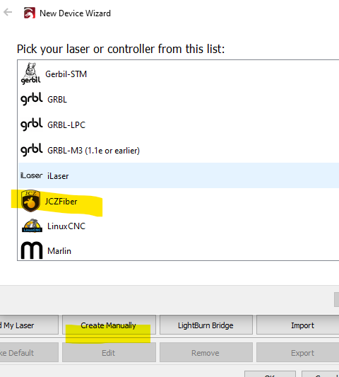

Now that you are using LB, for the 300x300 you add a new machine and set it up from scratch. Devices>Create Manulay>JCZ Fiber

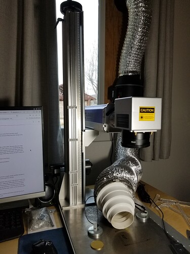

How far above the table do you have the galvo/lens? Mines up around the 400mm mark. The galvo in the photo has an F254mm lens in it, the next mark and final one, up the column is the F420mm lens pointer.
I bought mine with an F420mm which has 300x300mm coverage or there about. A simple problem here is I don’t know if you got an F300mm or an F420mm.

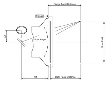

Where does scan angle come in? Specs say it’s 28 degrees.
You need to raise the head near the 400mm height so you have it focused. One of the issues with some short lens fiber machines is the column height isn’t great enough to allow you to focus the machine with a longer lens.
I’m sure it’s not working because you don’t have it focused properly. Technically it should be 420mm from the material to the center of the lens. My column sits on top of a block that raises it about 10mm or so.

I raised the head to its max height, and it only goes to about 12 3/4" or 324mm.
from the edge of the lens to the bed. So impossible to reach 420 as the column is attached to the base.
If I’m reading these posts correctly, it seems I’ve wasted money on the 300, or is it possible to still use it?
You can find a taller column, that’s the only fix I know of… Other than hanging it off the edge of the table.
You need a taller column to use an F420mm lens. I’d query the vendor and see if they can help you acquire a taller column.

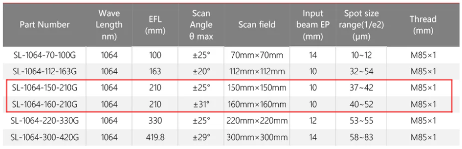

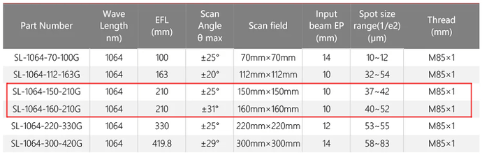

It’s not much you can do anything about… It changes the coverage. Here’s a copy from Cloudray where they show 2 of the same focal length lenses (210mm) with different coverage because of the scan angle.
Most hobby lasers are in the ~25 - ~28 degree range.
