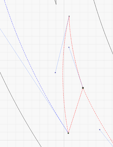

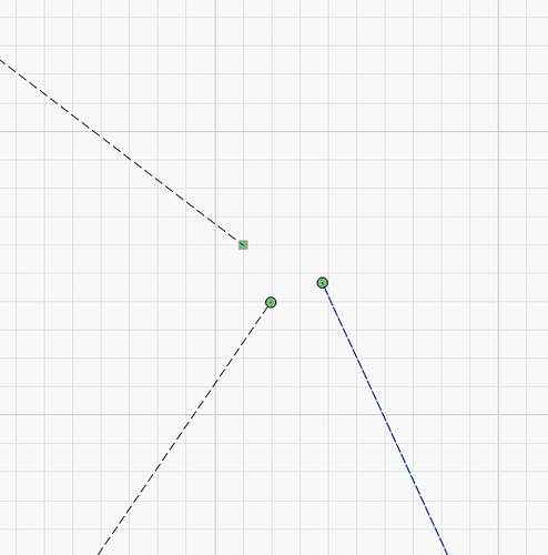

How can I connect 3 knots/ open lines?
I can only connect 2…
What do you mean when saying “connect”? If you are suggesting having 3 nodes join a path, this is not an option. Show us more of what you intend to achieve, and we may have additional suggestions. :slight_smile:
I have a komlex logo and want to have all forms connected in an svg to export for 3d printing and then choose different objects to extrude them…
connecting blue and red in the lowerst point…
The lines on your workspace are technically a tool path. You cannot have more than two points join together.
I suggest you use a Boolean function to join two separate shapes into a larger shape.

You cannot have a vector with branches (3 nodes), The machine would not know which branch to follow.
