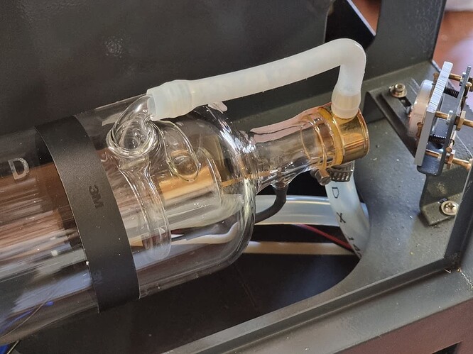

Some pics below…
As it was wired before:
New tube’s hot end, no cap:
New tube’s business end:
New tube’s label:
What i have to work with (note wire with connector is siliconed, i cannot just remove it to replace on tube’s pigtail…):

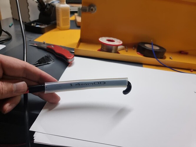

My attempt at ball soldering. Not as easy as it seemed. had to hold the twist vertically, otherwise the ball would sag one way and just drip off (70/30 solder, 350c).
Then filled the piece of 7x14mm silicone rubber hose with above mentioned RTV and shoved the soldered joint in till in the middle of the tube(excess squeeze out at the end). Been curing since 2am last night. Haven’t fired it up yet.
Wiring and plumbing done, lets see what happens. New LPS and new tube.
Well, it lives. Tested and cutting better than when it was new. All that remains is to replace god awful k40 1st mirror mount, all the optics to new and properly align…
