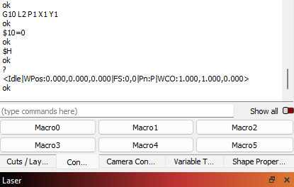

Yes, and I did make it stop going to 0,0 after the job finishes but i still need to be able to run the laser at 0,0 to create the set up I am looking for and right now that wouldn’t work. Is there a way to shift the 0,0 on the machine? I have a little more room at the max limits that i could shift the origin to 1,1 and still have all 400x400 usable space. and when i send the laser to the current 1,1 there are no issues

There’s the likely proper way but let’s try this.
Run these commands in Console:
G10 L2 P1 X1 Y1
$10=0
$H
Can you return the output?

That g-code offset did exactly what i was looking for! Thank you!

It did make it so I now hit a soft limit on the 400mm point, is there a way to set the soft limit to like 400.1 so that it can burn the 400 x 400 perimeter?
Either disable the soft limit ($20=0) or increase overall XY dimension limits ($130, $131 respectively).
